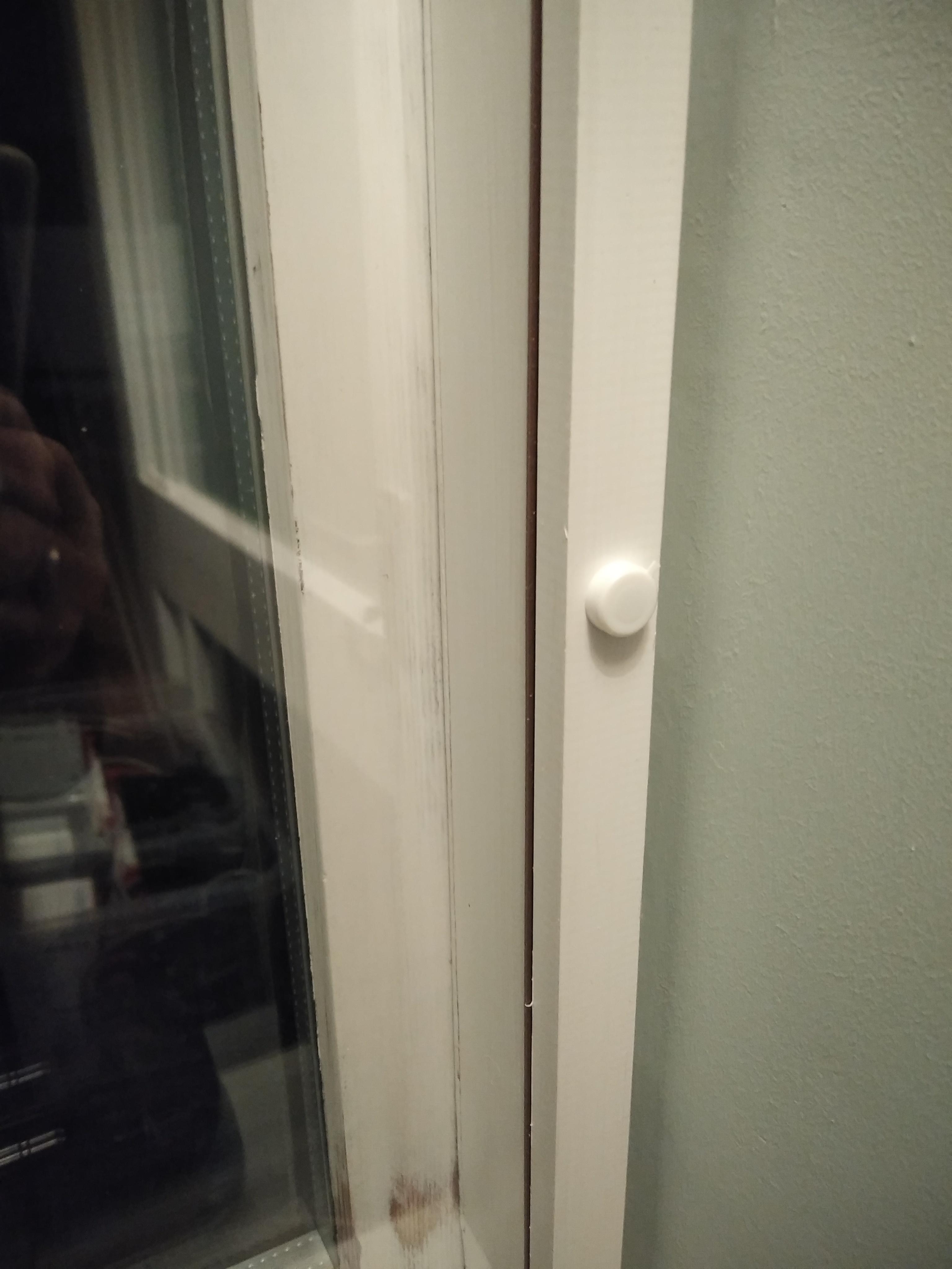

SteamyTea Posted October 17, 2022 Posted October 17, 2022 I knocked up some secondary glazing a few weeks back. Just cheap styrene sheets, cheap moulded timber, cheap foam W seals, all held together with double sided tape. I have timber framed so just drilled and screwed them in place. Apart from reducing draughts (which is what I wanted) the noise reduction has been dramatic. The neighbour that goes to work at 3 AM is not public enemy number 1 now (though may still squirt some expanding foam up the big bore exhaust). I did this as a proof of concept, may redo them a bit prettier next year, shall see how much energy I save first. I think the 14 windows did not cost me 200 quid. 1
Alwayslearning22 Posted October 17, 2022 Author Posted October 17, 2022 Thanks for the reply. Can I ask how much of an air gap did you leave? My house is also timberframe. I like the sound of the diy version. Only thing I'm concerned about is my house has trickle vents and and a mechanical ventilation system. so I think I need to keep those vents open. I was thinking of getting horizontal sliders and just closing them in the evening when the noisy kids come out. do go have any pictures of your secondary glazing? I need a solution fast those kids are driving me bonkers every evening and keeping my baby awake
SteamyTea Posted October 18, 2022 Posted October 18, 2022 8 hours ago, Alwayslearning22 said: do go have any pictures of your secondary glazing Not the best picture. I just screwed into the main window frame, not the opener, that would not have stopped the leaks. Gap is around 25mm. I don't have trickle vents, there are enough holes in the house as it is. 1

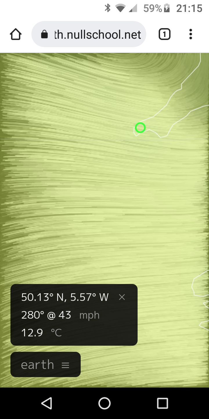

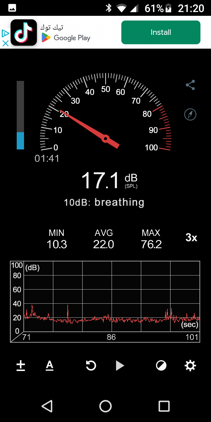

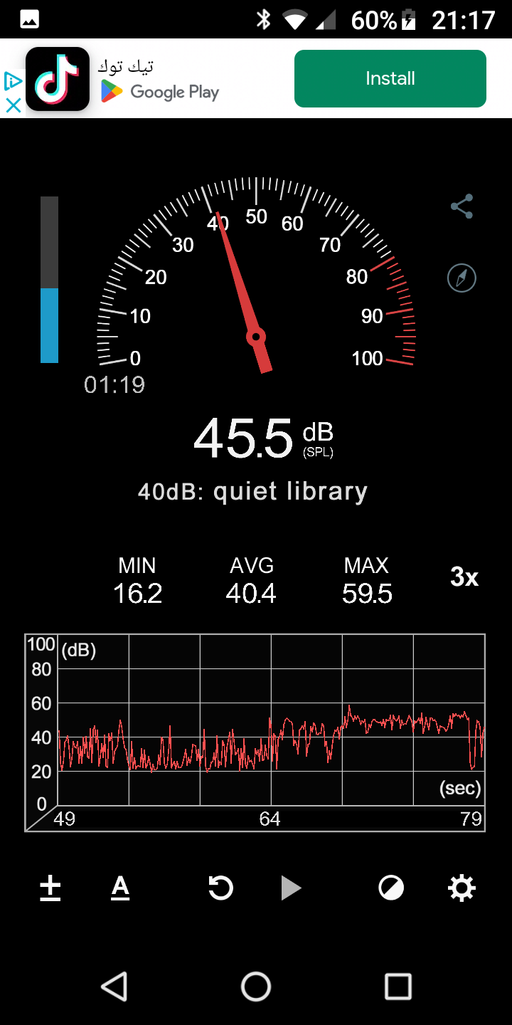

SteamyTea Posted November 1, 2022 Posted November 1, 2022 @Alwayslearning22 Not sure what you tried in the end, but last night was the first proper storm to hit since I secondary glazed. Here is a few screenshots. First is weather map, then two of the sound meter. First SM is on the window cill, second is about a metre from the window. Not very noisy. 1
Alwayslearning22 Posted November 5, 2022 Author Posted November 5, 2022 On 01/11/2022 at 08:10, SteamyTea said: @Alwayslearning22 Not sure what you tried in the end, but last night was the first proper storm to hit since I secondary glazed. Here is a few screenshots. First is weather map, then two of the sound meter. First SM is on the window cill, second is about a metre from the window. Not very noisy. Wow that’s very good for DIY secondary glazing. I am very impressed. so I didn’t get round to doing it yet but it’s on my mind every night. My only concern with it is my house only has the trickle vents for ventilation , so I’m afraid I might cause an increase in humidity.
