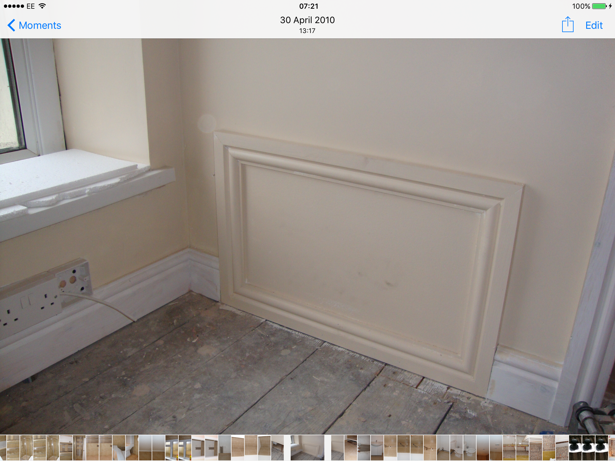

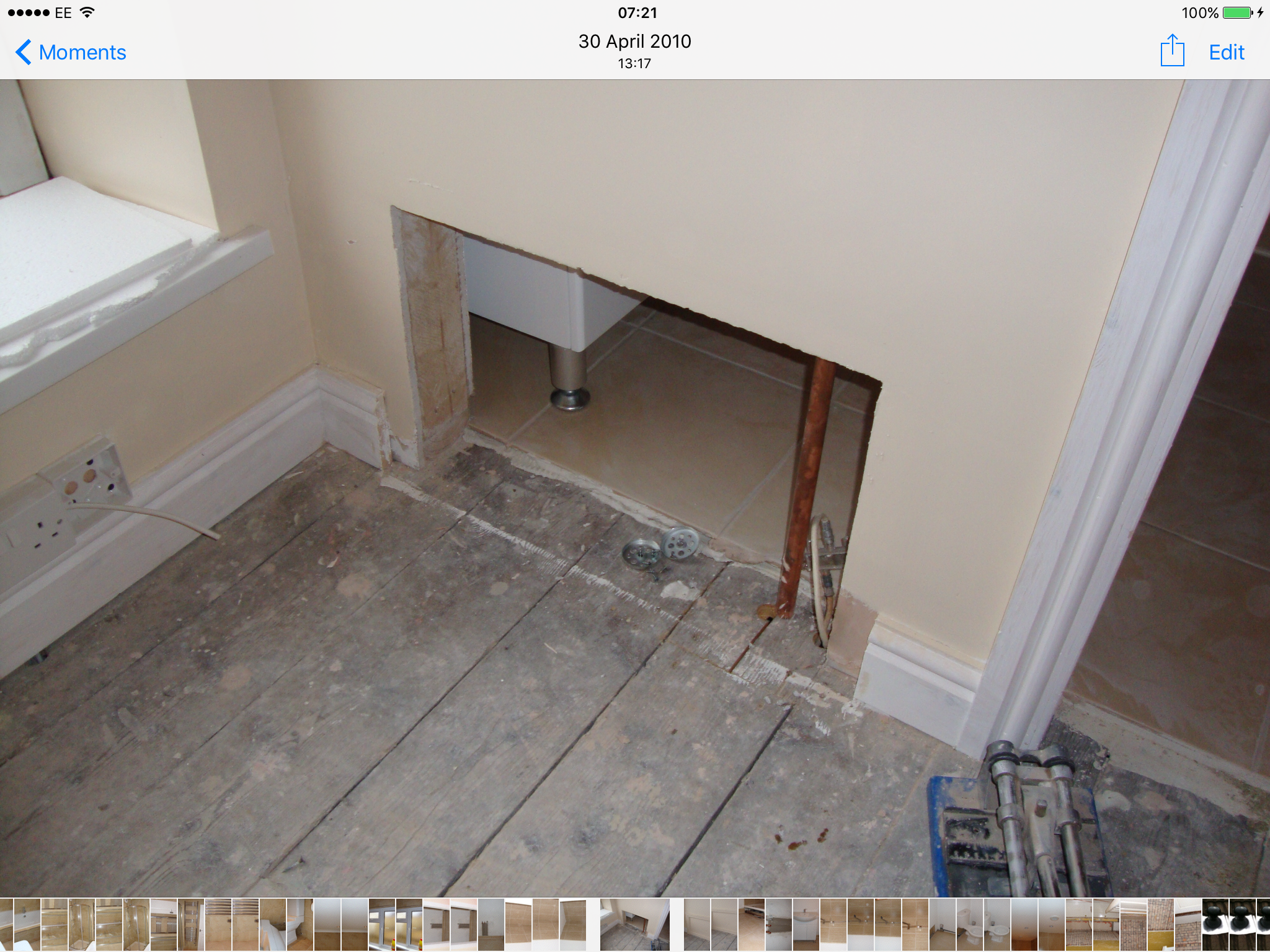

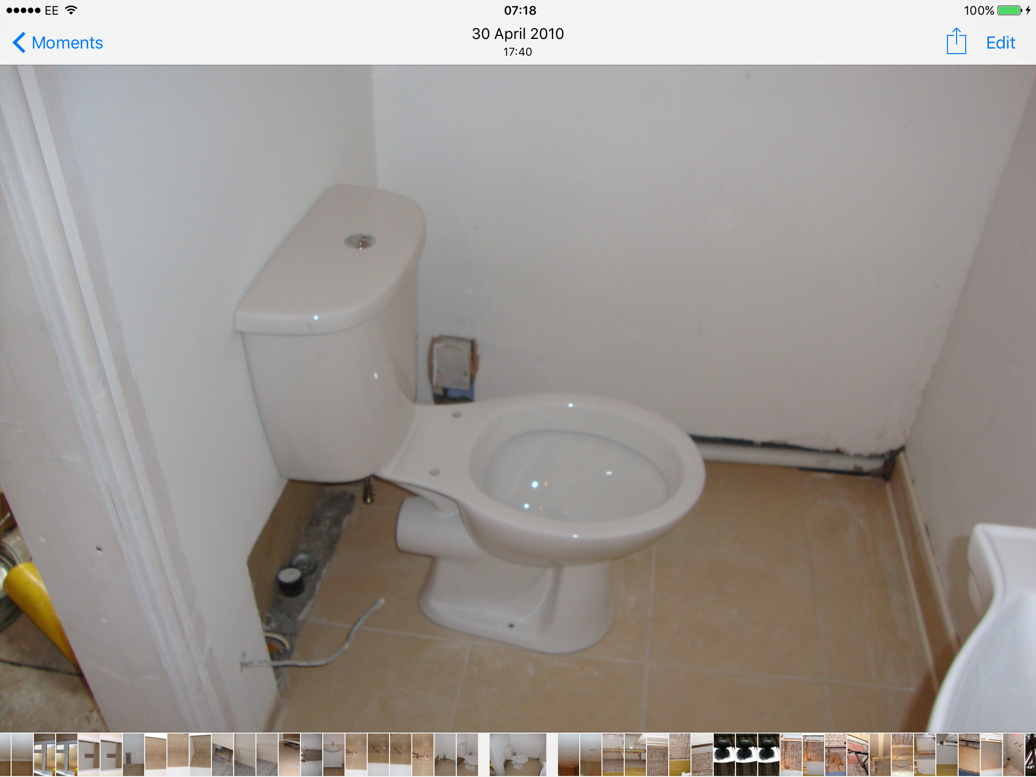

Nickfromwales Posted June 23, 2017 Share Posted June 23, 2017 I fitted one for a friend of my wife's parents. Ensuite added to the master bedroom for accessibility ( night loo visit instead of the far away downstairs bathroom ). Installed as the budget wasn't there to tap into the sewerage, against my advice and will. I made the ensuite out of stud frame and decided the best of this evil was to mount the unit backing onto the bedroom, boxed within the wall so the Sani-shat was out of view from inside the ensuite, and out of sight from the bedroom. The idea was that if the unit failed / other, you could get at and remove the unit via the removable panel I created, thus leaving the bathroom and WC in place and unnafected. A new ( replacment ) unit could then be fitted in its place within about 30 mins start to finish. That was taking the WC, basin and an elevated shower tray. Still working but I told them "#1's only if you want an easy life, #2 goes downstairs" and I also said don't ask me to EVER fix it, it'll only ever be slung and a new one fitted. Until they agreed that I wouldn't fit it. Just waiting for the ? to hit the fan, only a matter of time tbh. Link to comment Share on other sites More sharing options...
PeterW Posted June 23, 2017 Share Posted June 23, 2017 Stuart Turner ones are probably better as they have been properly engineered. But as @Nickfromwales says they are a last resort... Turd gobbling sh!t pump... Link to comment Share on other sites More sharing options...
Nickfromwales Posted June 24, 2017 Share Posted June 24, 2017 Here we go.... The rear access was big enough to get the unit out without disturbing the bathroom, and a boxing around the bit of the unit sticking out into the room made it 'invisible'. Boxed and tile skirted to match what you see there. Just looking at the date makes me realise I've fitted ( under duress ) probably two or three of these in the last 20 years! Link to comment Share on other sites More sharing options...
