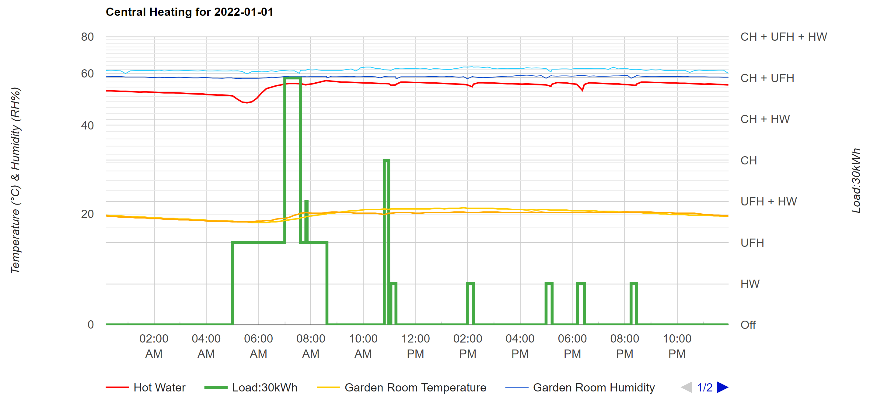

Critique my heating setup
SOS. I'm tearing my hair out with our current energy usage. Prices going up is one thing, but over the last couple of weeks we've been averaging ~70kWh a day, which seems crazy high.
32kW Baxi Platinum+ condensing boiler set to 70c. Capable of modulating down to 10.4kW
250L DWH set to 50c
UFH manifold set to 35c
Two zones:
1) Downstairs: 7x UFH loops, approx 520m of 16mm pipe and 63L of water. Energy demand: approx. 6kW based on 100w/m2
2) Upstairs: 8x radiators all balanced. Energy demand: approx. 9.8kW
UFH is set to 21c during the day ay 19c over night
Rads set to 21c from 6pm - 9pm and 19c all other times
Scenario: Reducing the UFH mixing temp from 40c to 35c appears to have increased energy usage by 34%. Hypothesis: The boiler continues to heat at 70c. Reducing the UFH mixing temp effectively wastes more heated water as the UFH mixer cannot make use of it all, resulting in more being returned to the boiler and the loops taking longer to reach temp.
Scenario: When just the UFH is on, the boiler return remains low, at approx 40c. Significantly higher than 25c (UFH mixer temp - 10c delta). Hypothesis: The UFH mixer cannot make full use of the 70c flow temp, whilst some is being mixed and pushed through the UFH loops, too much is being returned straight to the boiler, increasing the return temp.
Scenario: When just the radiators are on, the return temp remains high (approx. 60-65c) and the boiler cycles every 15/20 minutes. Hypothesis: The aggregate capacity of the radiators is not able to extract enough heat from the water to sufficiently reduce the return temp. I.e. the boiler is too large and/or it's not modulating down far enough. All radiators are balanced in that they all heat up at roughly the same time.
I'm reaching the conclusion that the boiler is just massively over sized for our requirements. Even if everything was running at the same time (inc. 3kW for DWH) we'd only need 19kW in total. It's been fitted over a year now so getting the plumber back to rectify this will be near impossible.

Thanks for the info, it's really useful.
The first radiator the boiler flow will reach is a towel rail, this is in the bathroom directly above the boiler, followed by the landing radiator, neither have a TRV, the landing rad is the one nearest the upstairs stat. I'll test the flow/return temps coming from the towel rad this evening. What else would I be looking for when trying to find a bypass and how would I fix it?
Our boiler can be fitted with weather compensation, the main reason I hadn't yet was because the curve in the summer drops too low to heat the DWH. Is there a way around this?
I also assumed that being able to request different flow temps from a boiler would be a boiler specific feature, i.e. not something that could be applied generically. It would be ideal for the UFH zone/DWH if possible.
I did have a similar idea about setting the mixing temp higher and allowing the weather comp to dictate the actual flow temp. My concern there was we'd end up with hotspots in the floor as the room temp would overshoot the stat.
The UFH pipes are sitting on 100mm PIR, with 25mm perimeter up stands. Based on our PA, this gives a calculated U-value of 0.15.
I guess you're right that the boiler shutting off isn't terrible, but it's certainly less efficient. My other thought when it comes to the UFH zone is that the boiler is actually having to work harder because the flow is 70, but the return is only 40. So naively I'm assuming it's working harder to heat 40 back up to 70 for the UFH, than it needs to for the upstairs rads, which are returning at a closer temp to the flow. So perhaps the majority of the excess usage us actually coming from the UFH zone and not the radiators?

1 hour ago, TonyT said:
I just can't imagine diagnosing any heating system without some sort of time-series plot of what's going on. This example of mine from January shows how the zone valve for HW wasn't quite closing properly, so when the UFH came on early in the morning, cold was able to circulate through the coil and rob the cylinder until it started going the other way. Just going by what came out the taps and the general feel of things would never reveal this.
2056845141_Screenshot2022-10-1321_42_05.thumb.png.bc8eed10fab75b1fb7b00a21cdb6af80.png
After tweaking the auto bypass valve, it's now "hissing" when the UFH zone first calls for heat. My assumption is this is whilst the (wax) actuators are opening as the heated water has no where to go. It doesn't "hiss" when the rad zone is on. Should this be expected?
