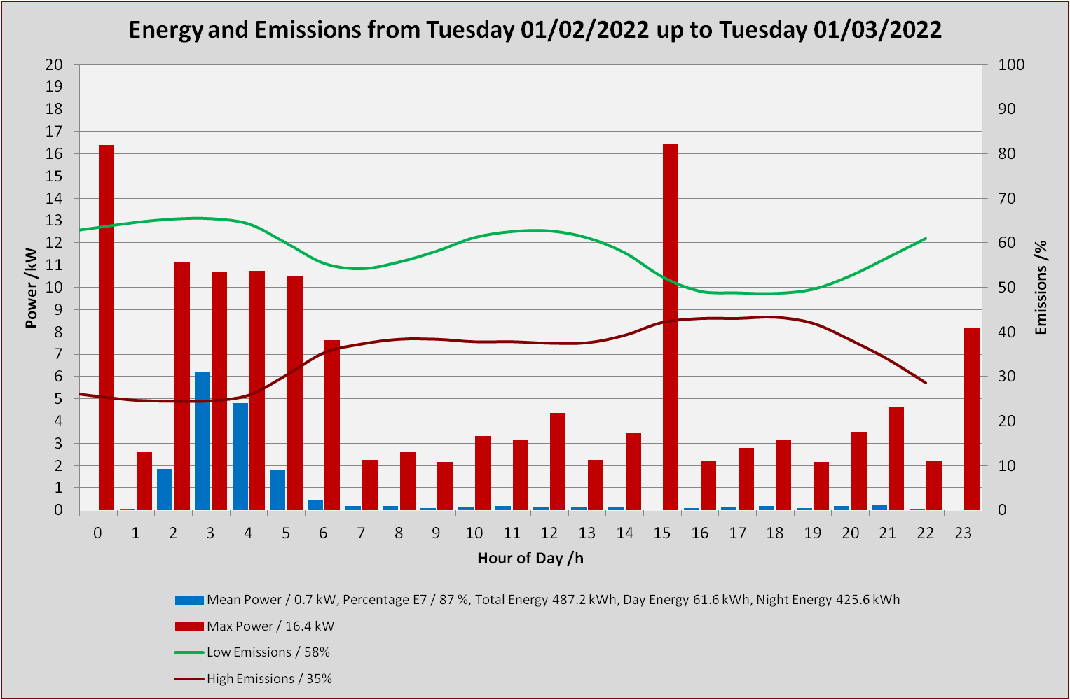

Here is what has happened so far this year, the missing 2% is due to imports, which I cannot account for.  Ignore my usage, which is 0.0000011% of grid capacity, and just read the green and red lines off from the secondary y-axis on the right.

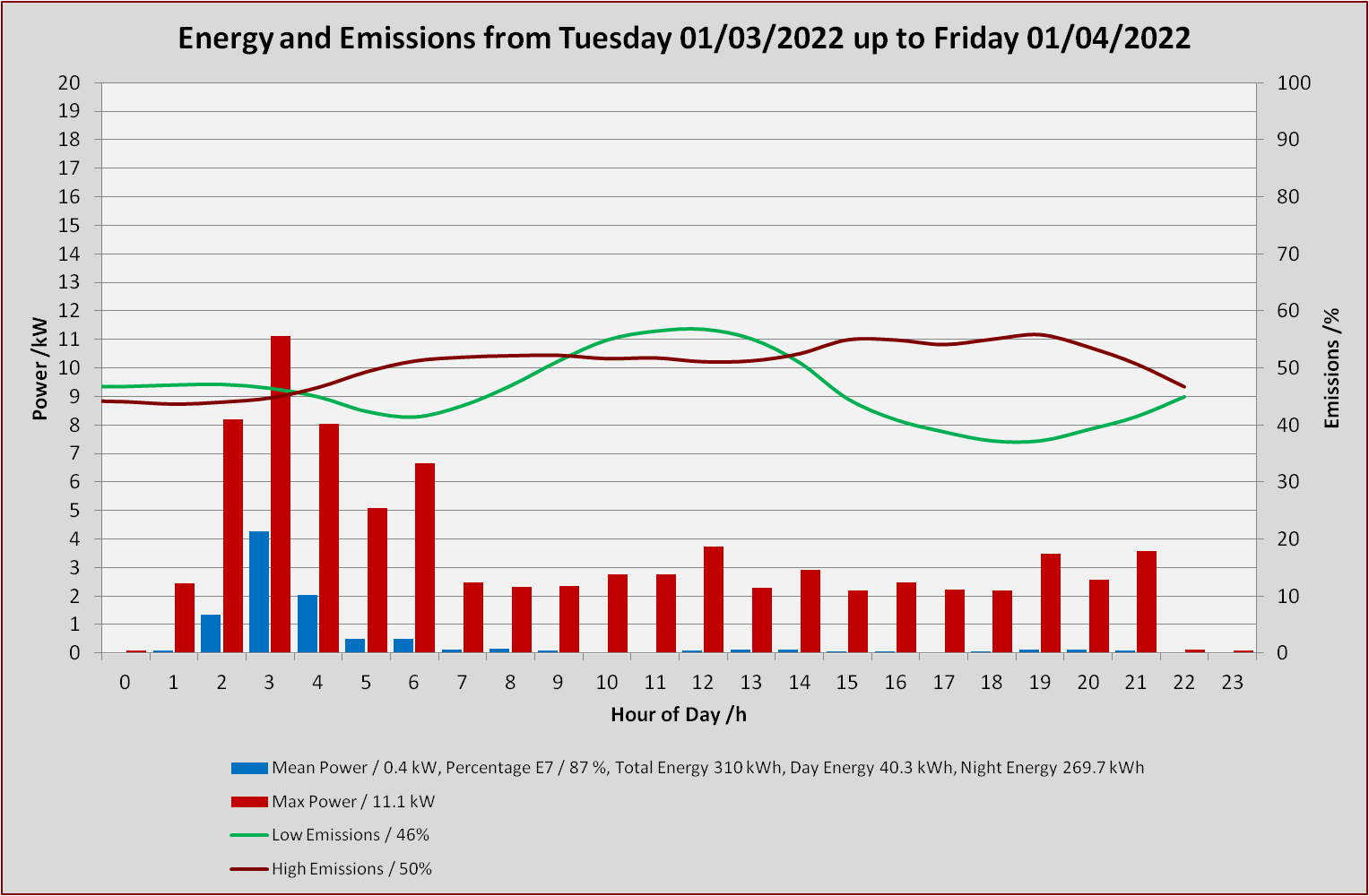

Just because I like charts, here is the monthly breakdown.

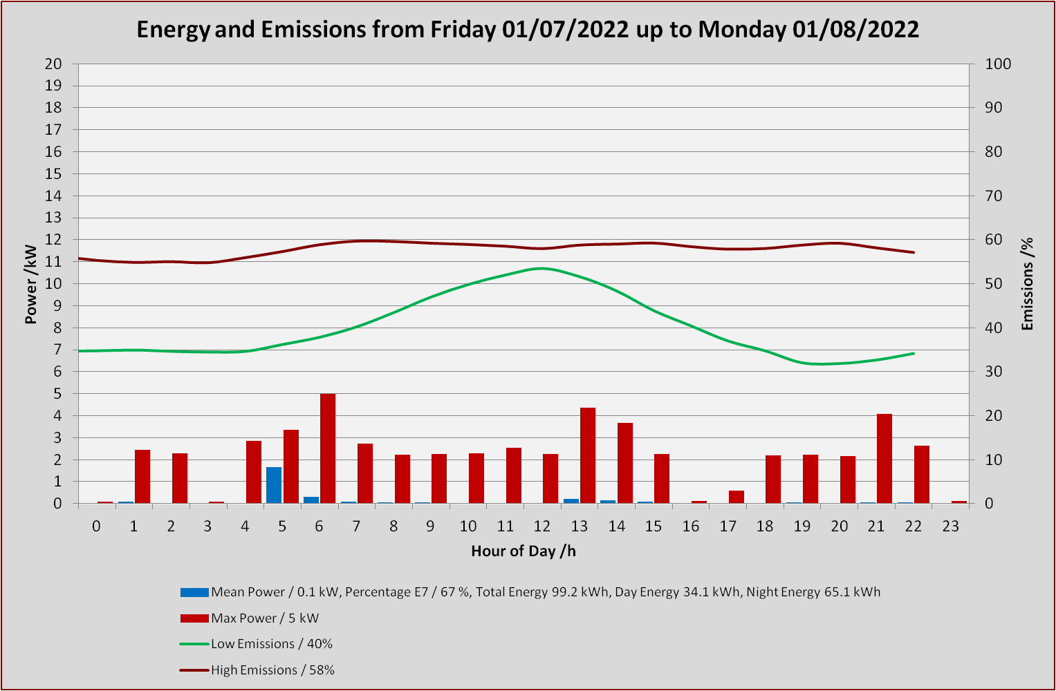

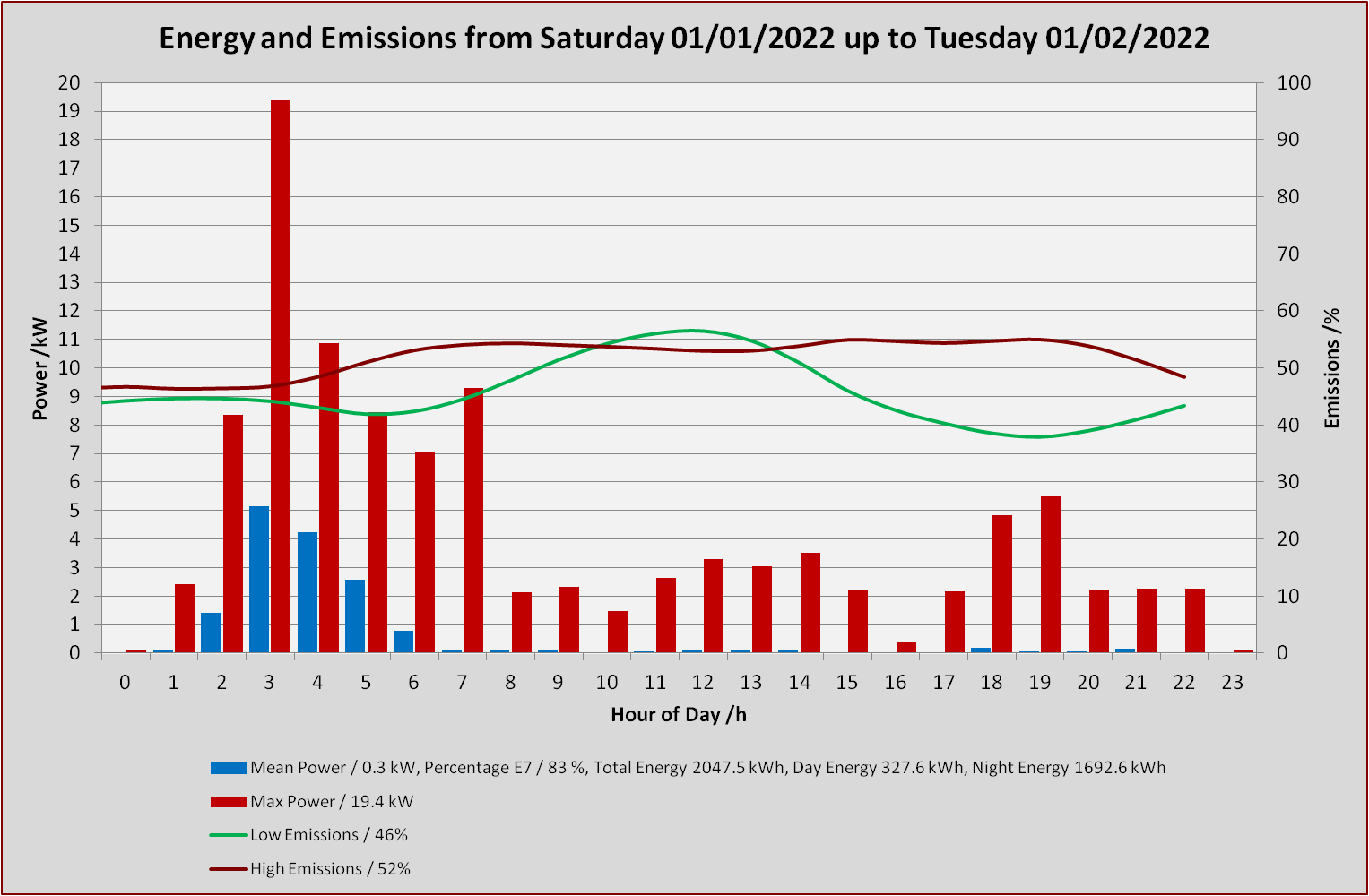

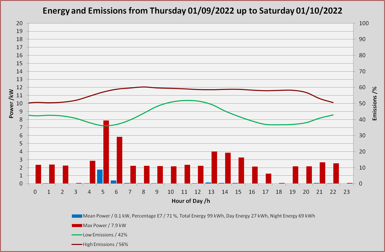

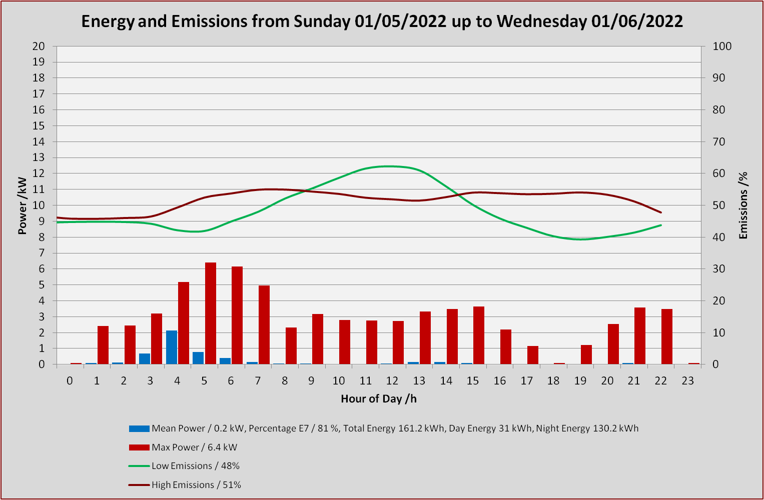

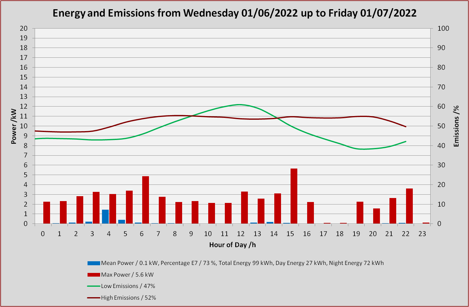

Are the powers the power taken from the grid or the power consumed in the house, or do you not have batteries?
6 minutes ago, MortarThePoint said:
That agrees reasonably well with my estimate:
    ASHP: When heating using an ASHP the marginal electricity* will be most likely generated from gas:  0.5kgCO2/kWh electricity / 300% = 167gCO2/kWh of heat
But if the marginally electricity is coal generated....
It does except why use marginal rate? Electricity consumption has been falling for many years, and quite dramatically per capita. ASHPs and electric cars will likely reverse this trend but due to the cheapness of renewables, you'd expect this to be largely renewable sources to take up the increase. Or at least, not reduce their contribution from today.
All grid, I am on E7, which is why the larger loads are before 7AM.
You can see when I put a new timer on the DHW as I shifted it over an hour, so save on an hour's standing losses.

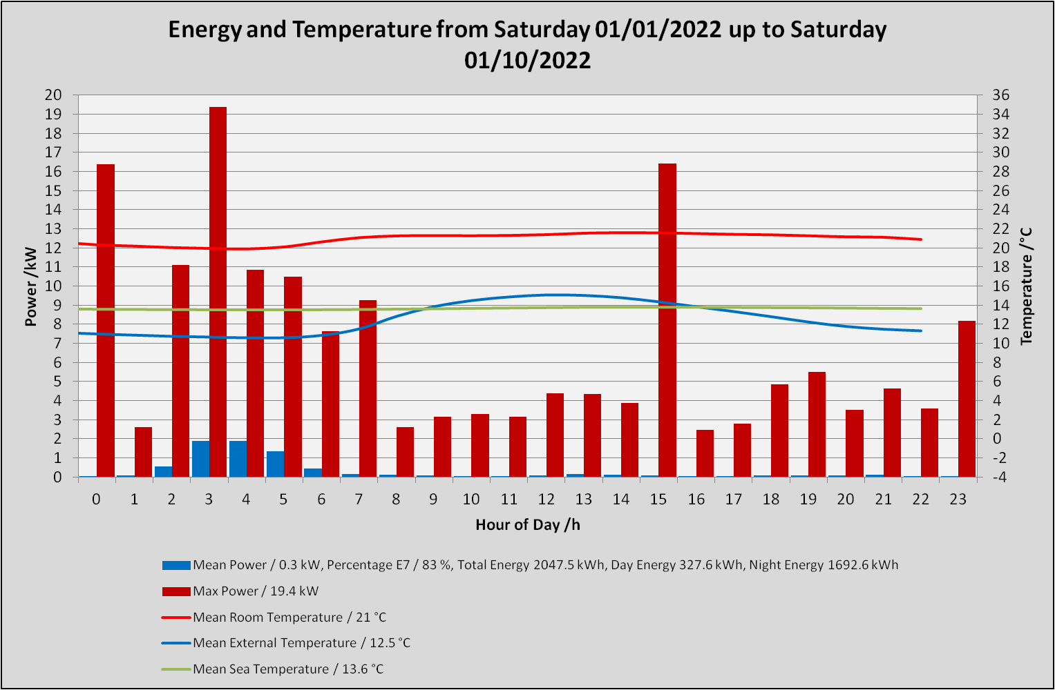

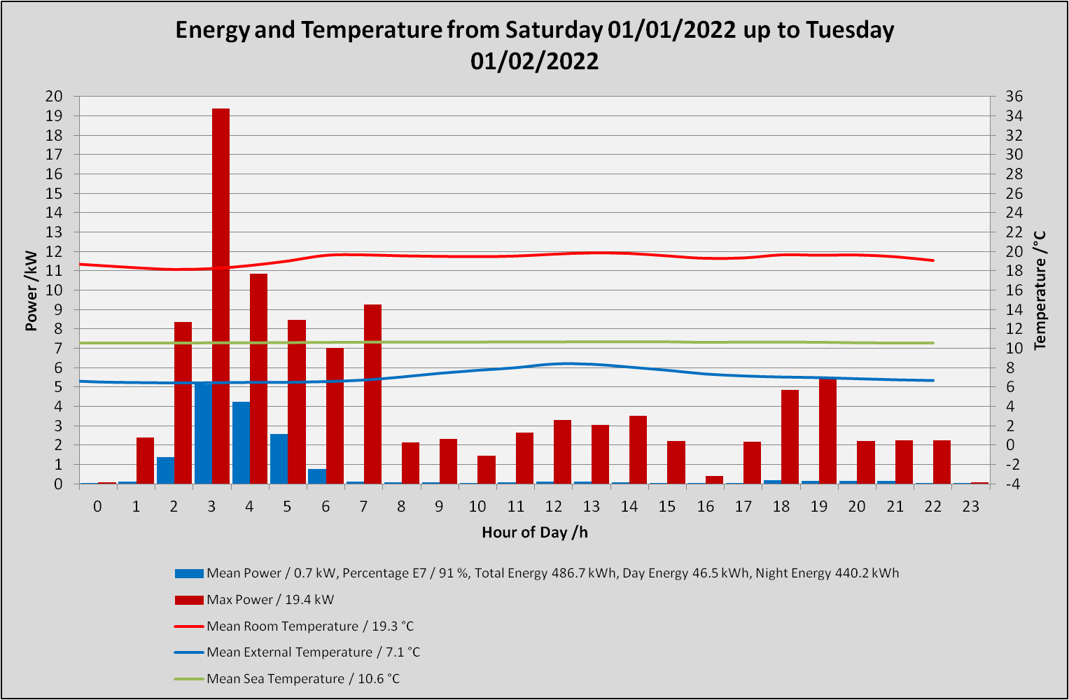

Do you have a graph of indoor and outdoor air temperature vs hours of the day? I'd be interested by the dT/dt when it's cold outside.
Got this one, but not a correlation as I did not find it very useful.  Mainly because I am on E7 and the load is fixed, and my house temperature tends to stay the same.
Interesting. I think taken over such a long time the effects of solar gain mask the most interesting bit. Do you have that for just January 2022?
Yes

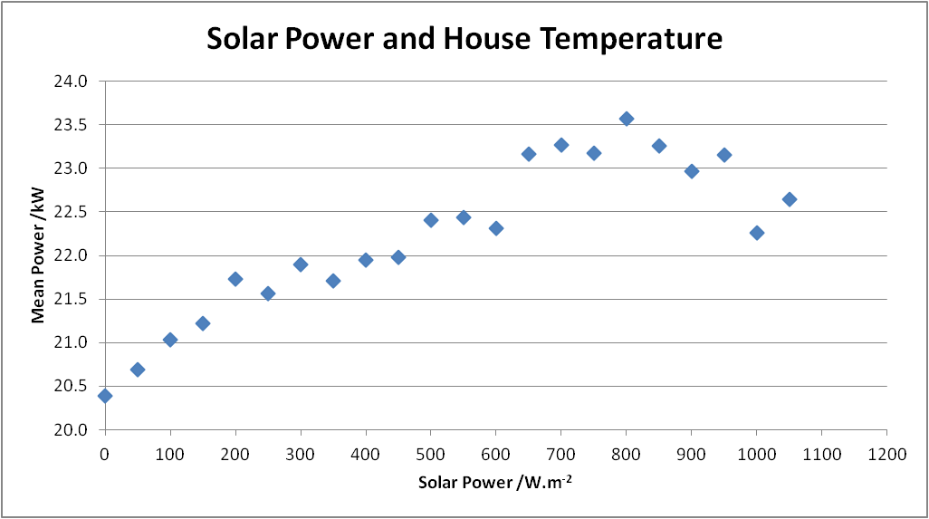

15 minutes ago, SteamyTea said:
Yes
I'm surprised your indoor temperature is so constant during the day without the heating on. Do you have lots of glass and solar gain? It starts to drop at 9pm at a rate of around 1C in 5 hours.
Much of it is to do with my lifestyle.  I work evenings, so the house gets shut up at about 4PM, then I get home between 9 and 10PM.
Just realised, I leave the back, downstairs window (where the temperature logger is) open a bit at night, I am a smoker.
Here is a quick chart of mean house temperatures and solar power.
I would have to slice it a lot more to find out what is actually happening, but I like 23°C as a temperature (grew up in the tropics), so don't open the back, upstairs, windows till it goes over that.
But basically I have less than 3.5° swing between the coldest and hottest, and darkest and sunniest times.  Why all this nonsense about timber frame houses overheating is bollocks.
I probably have a greater percentage of glazing to wall area than most, but as it is small house, overall not much.
Quick chart.
Edited by SteamyTea
