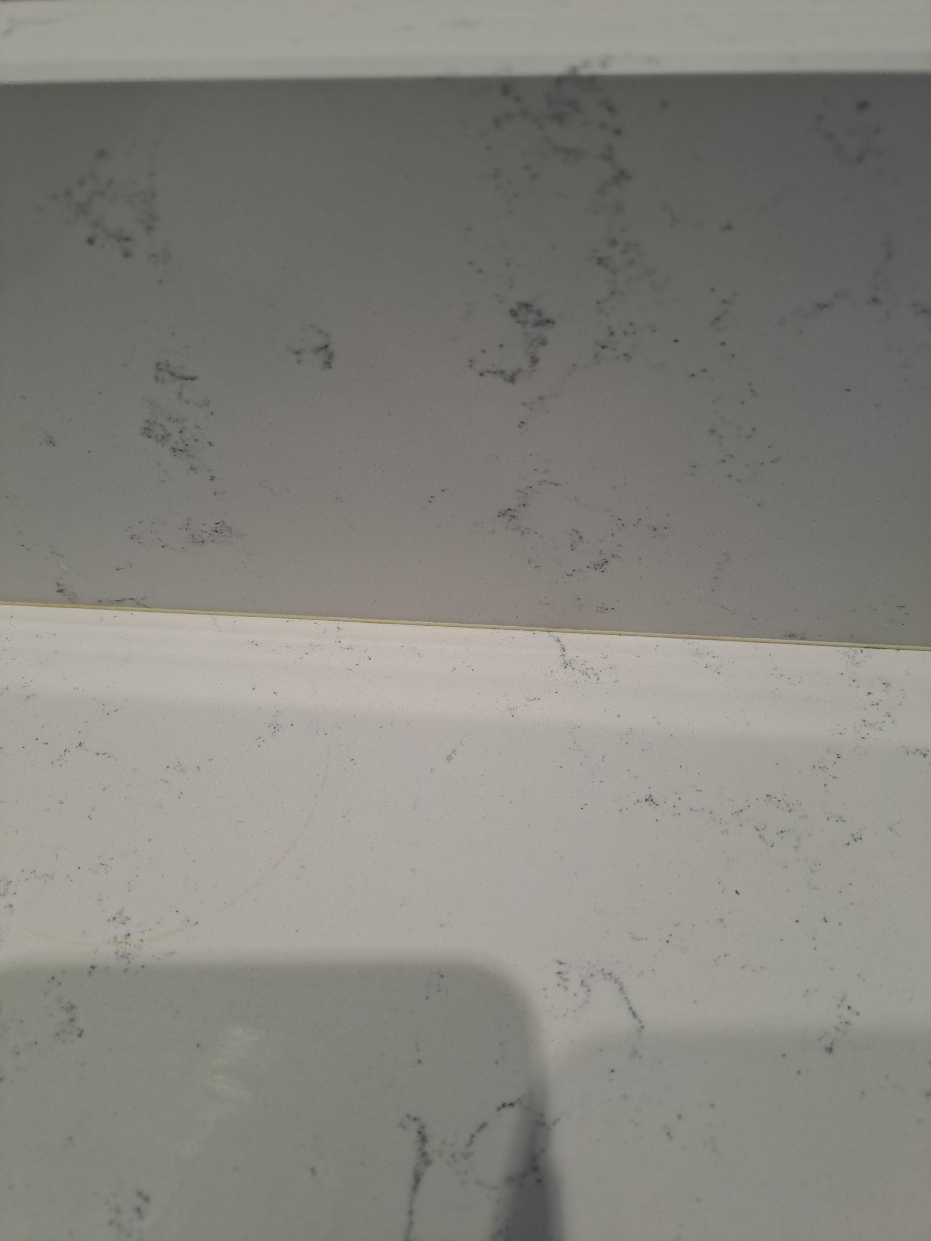

steveoelliott Posted October 6, 2022 Share Posted October 6, 2022 Hi, I have what I believe is a quartz worktop in our kitchen (inherited from previous owners) and there is a joint adjacent to the sink that could probably do with renewing as some is missing. The question is, what type of sealant is this? Seems like silicone to me but clearly nicely color matched. I'm also wondering on the best technique to renew where needed. Raking out I imagine is easy with a Stanley blade etc but to renew i'm not sure how to best to get the jointing compound back into the joint neatly. I may consider finding a local worktop company to assist but it is a tiny job Thank you. Link to comment Share on other sites More sharing options...
Hobbiniho Posted October 6, 2022 Share Posted October 6, 2022 you might be best looking for a "magic repair man" "snagging repair man" rather than a local worktop company, a good skilled person will be able to make that joint look better than new 2 Link to comment Share on other sites More sharing options...
Bonner Posted October 6, 2022 Share Posted October 6, 2022 Shouldn’t be silicone but that may explain why it needs refilling. Epoxy filler with a little pigment (maybe experiment by mixing a tiny bit of cement?). 1 Link to comment Share on other sites More sharing options...
Conor Posted October 6, 2022 Share Posted October 6, 2022 The worktop fitters use some sort of hard setting resin that resists being pulled out or worn. That's what they used in the join between our upstand and worktop. Might be best going to a worktop company and asking if they have a product that suits. 1 Link to comment Share on other sites More sharing options...
MJNewton Posted October 6, 2022 Share Posted October 6, 2022 (edited) Echoing some of comments above, joins in quartz worktops (indeed arguably worktops of any material) have a structural role to play in addition to aesthetics so I don't think silicone would be an appropriate material to use. Edited October 6, 2022 by MJNewton 1 Link to comment Share on other sites More sharing options...

Temp Posted October 6, 2022 Share Posted October 6, 2022 Silestone also do a silicone.. https://www.howdens.com/hardware/sealants-and-adhesives/sealants/worktop-joint-sealants/silestone-colorsil-280ml-quartz-worktop-silicone-sealant-obj-sku-family-25393183 1 Link to comment Share on other sites More sharing options...
