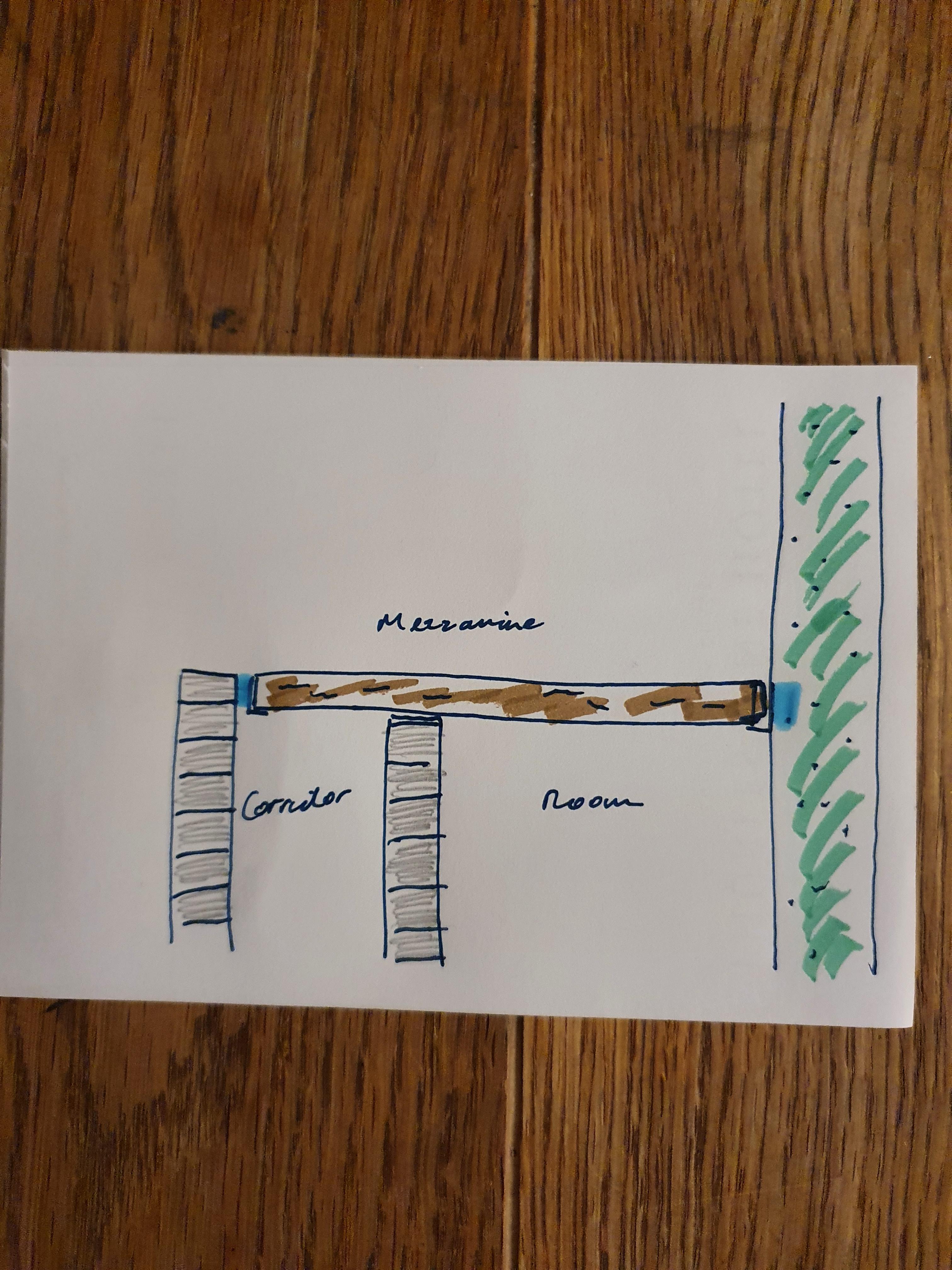

Tom Posted October 5, 2022 Posted October 5, 2022 Hi all - quick question, blockwork internal walls going up now and will in the near future reach mezzanine height, so I need to think about the floor structure for this. Plans indicate 75x200mm joists at 400mm centres. At one end of the joist will be an internal blockwork wall that come up to the height of the floor and stops, the other end will be the exterior Nudura wall. I'm planning on using the same 75x200mm timber to attach to the Nudura wall (insulation taken back and fixed directly to the concrete) and the internal blockwork wall, then hangers nailed to these. Is this right? What fixings should I use to fix the timber to the walls? These things? https://www.toolstation.com/rawlplug-r-lx-zinc-plated-concrete-screw-anchor/p83182 Thanks all
markc Posted October 5, 2022 Posted October 5, 2022 I would be using resin anchors (threaded rods bonded into oversize holes in the wall). Concrete screws should be fine as the will be in shear and unlikely to move but well fixed resins will never move.
Nestor Posted October 5, 2022 Posted October 5, 2022 26 minutes ago, Tom said: Hi all - quick question, blockwork internal walls going up now and will in the near future reach mezzanine height, so I need to think about the floor structure for this. Plans indicate 75x200mm joists at 400mm centres. At one end of the joist will be an internal blockwork wall that come up to the height of the floor and stops, the other end will be the exterior Nudura wall. I'm planning on using the same 75x200mm timber to attach to the Nudura wall (insulation taken back and fixed directly to the concrete) and the internal blockwork wall, then hangers nailed to these. Is this right? What fixings should I use to fix the timber to the walls? These things? https://www.toolstation.com/rawlplug-r-lx-zinc-plated-concrete-screw-anchor/p83182 Thanks all Hi Tom, would you be able to share a drawing or photograph of the above detail.
Tom Posted October 5, 2022 Author Posted October 5, 2022 Thanks both. James, pic below. Green wall on right is Nudura. Joist goes over one block wall and hangs off the other. Timber wall plates in blue. Hope it makes sense! 1

Russell griffiths Posted October 6, 2022 Posted October 6, 2022 Another one for studs and epoxy resin. If you use those concrete anchors you will get the occasional one that won’t grab. With the resin every one will work if you follow the cleaning of the hole instructions. M16 studs here, but I am a nutter. 1
Tom Posted October 6, 2022 Author Posted October 6, 2022 Gonna go for M12 studs I think as I'm not such a nutter. Just to confirm that the 75x200mm joists are good to use for the wall plates too?
markc Posted October 6, 2022 Posted October 6, 2022 3 minutes ago, Tom said: Gonna go for M12 studs I think as I'm not such a nutter. Just to confirm that the 75x200mm joists are good to use for the wall plates too? Yes they are more than enough, as are M12 fixings. Space at 600mm ish between the joist locations 1

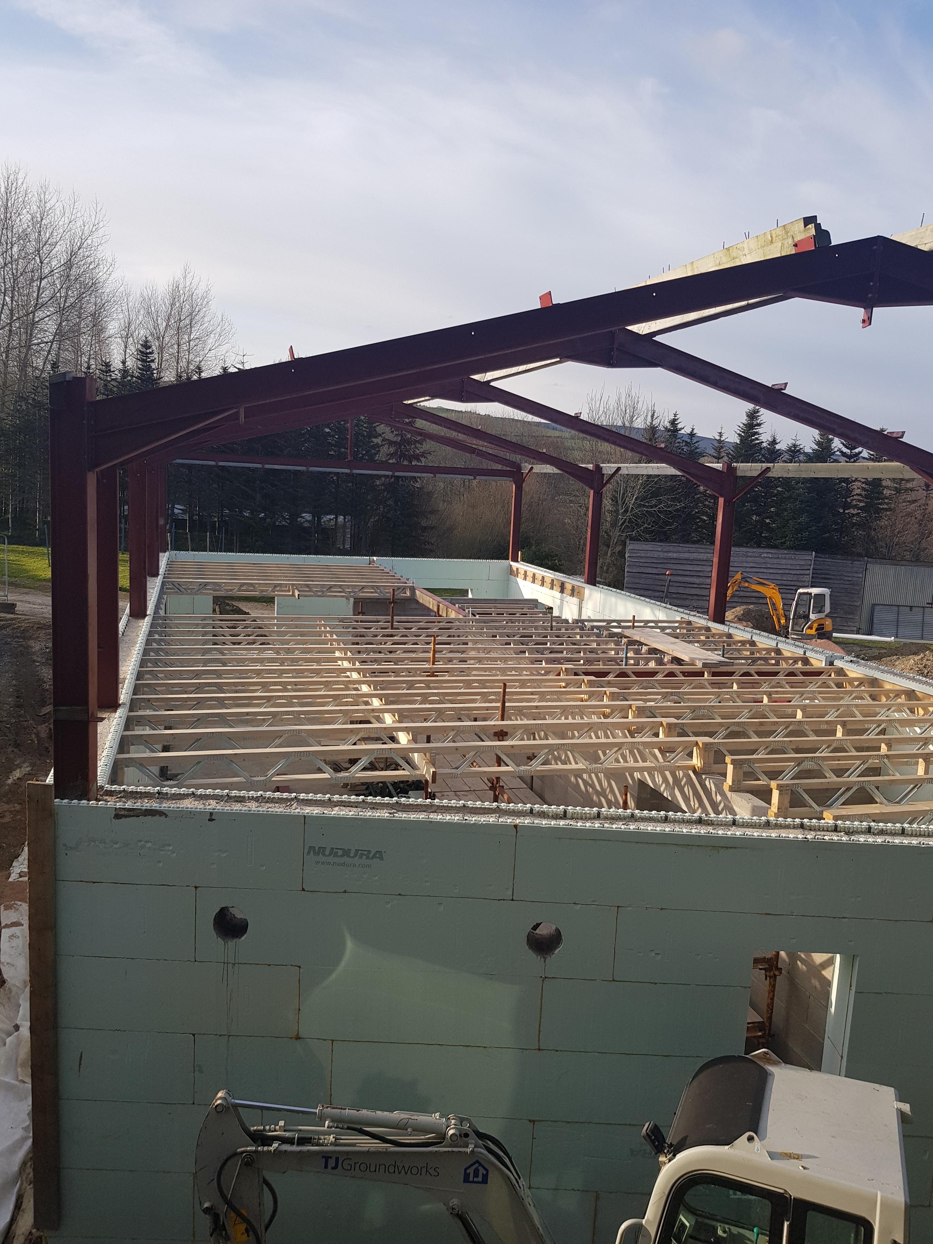

Tosh Posted October 7, 2022 Posted October 7, 2022 i used rawlplug r-kem ii and threaded m16 rod cut to length, 18mm drill marked to depth. bristle brush and puffer to clean out the holes and marked the resin nozzle so I had an idea how far to place the nozzle, i also marked the bar as well so when 'turning' it into the hole again knew when to stop. I'd suggest getting a good gun if you do it this way and you've lots to do as it can put a lot of strain on your hands. Not sure if you can zoom in but here's the ones i done, ring beam i think was 10 x 1 3/4. 1
