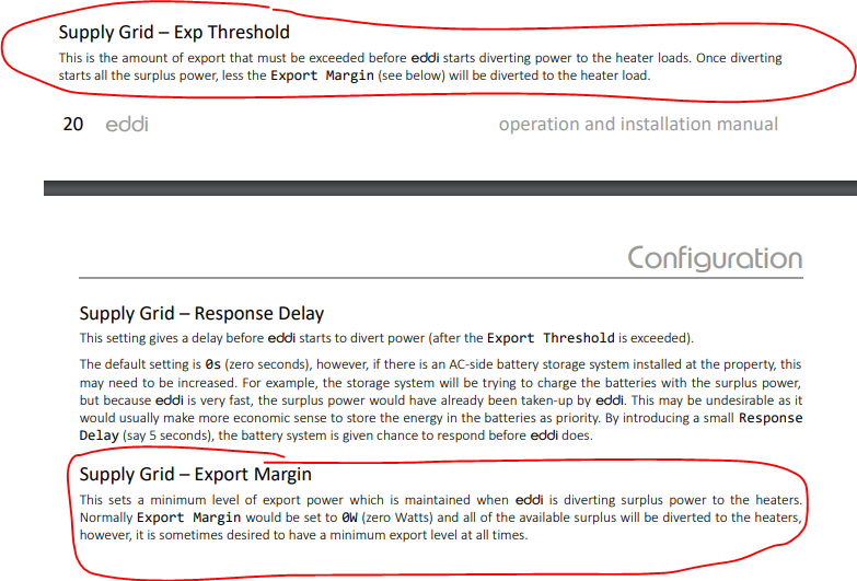

jack Posted October 4, 2022 Share Posted October 4, 2022 11 minutes ago, Radian said: Almost certainly, yes. Could be leaking 1kWh/day at certain times of the year. If they made it an adjustable parameter, you could tune it to your utility meter although that would involve seeing some indication that it is indeed exporting. My meter has an icon of a ratchet and pawl on the LCD that shows "meter running backwards" harking back to the days of mechanical metering. It also has an export register so incrementally adjusting the threshold over a longish period would allow you to slowly 'turn the tap off' until it stopped 'leaking' but this would be difficult if the diverter maxes out occasionally. I have an Eddi and it allows adjustment of both the export threshold and the export margin, although I doubt there's much granularity (it isn't going to allow fine-tuning to suit different meter types, for example). 1 Link to comment Share on other sites More sharing options...
Radian Posted October 4, 2022 Share Posted October 4, 2022 They all make it sound like you're getting/setting precise numbers i.e. 100W threshold but it can't be. The size of the virtual Joule buffer in meters isn't standardised and without knowing it, an uncertainty is inevitable. Link to comment Share on other sites More sharing options...
