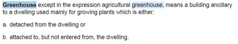

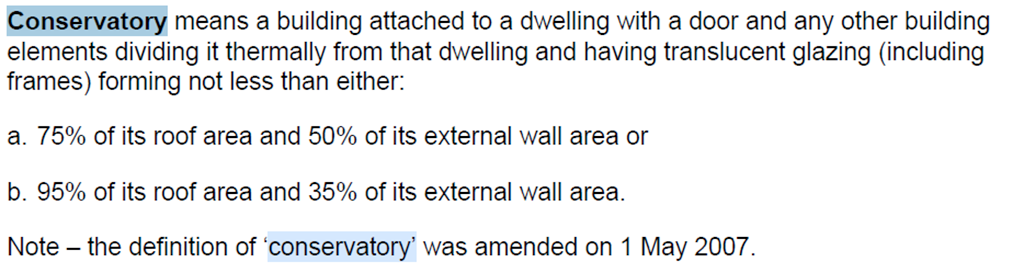

Hastings Posted September 27, 2022 Author Posted September 27, 2022 There is a new external grade door between the two. They say it is due to the definitions (in the domestic technical guide) of a greenhouse and conservatory: They say it has to be one or the other. But I don't agree, because there is no definition of 'porch' in the regulations.

Hastings Posted September 27, 2022 Author Posted September 27, 2022 (edited) BCO says it cannot be a greenhouse (access from house) and therefore must be a conservatory and must conform to the 'Conservatories Guide' document, which states full insulation (d/glazing, walls and floor) even if not heated. Maybe I argue it is an ancillary building, not further defined in the regulations. Edited September 27, 2022 by Hastings
Ferdinand Posted September 27, 2022 Posted September 27, 2022 10 minutes ago, Hastings said: BCO says it cannot be a greenhouse (access from house) and therefore must be a conservatory and must conform to the 'Conservatories Guide' document, which states full insulation (d/glazing, walls and floor) even if not heated. Sounds like you have a door to block, other considerations not intervening. Or see if it meets the definition of "porch". But do look up "covered yard" in Scotland. In England it is something which exists in law, but is not precisely defined anywhere - so very useful. I made a similar "covered way" - basically what here we call a "lean to", which is a weather protected wide walking route. Then added the door into the house 2 years later to give my tenant a laundry / dog space. Saved a lot of form-filling. and some fees. 1

Hastings Posted September 27, 2022 Author Posted September 27, 2022 54 minutes ago, Hastings said: They say it has to be one or the other. But I don't agree, because there is no definition of 'porch' in the regulations. Correction to my first post: there is a definition of Porch: "Porch means a building attached to and providing a covered entrance to a dwelling. " Sounds exactly like what I want to build. A big porch and not a greenhouse "used primarily for growing plants". 1
