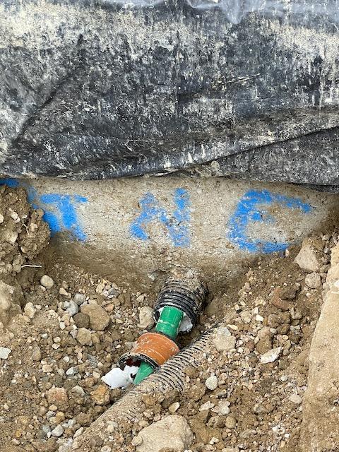

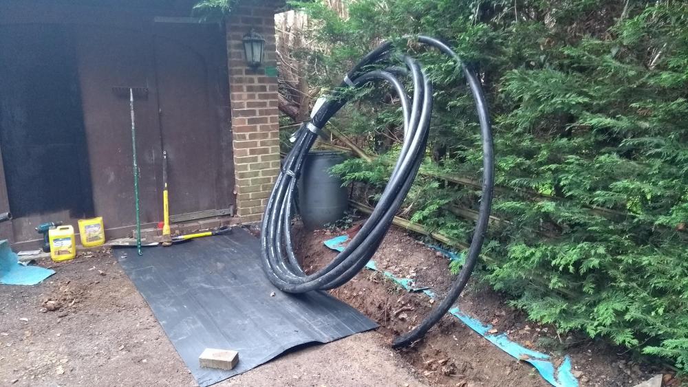

Onoff Posted September 25, 2022 Share Posted September 25, 2022 (edited) I used this solid DNO duct. The SWA runs in that. Then I've 20mm flex conduits within that with the Cat-5, screened flex etc in. Think this was a tenner win on eBay. Add the petrol picking it up from Esher 😂 Edited September 26, 2022 by Onoff Link to comment Share on other sites More sharing options...

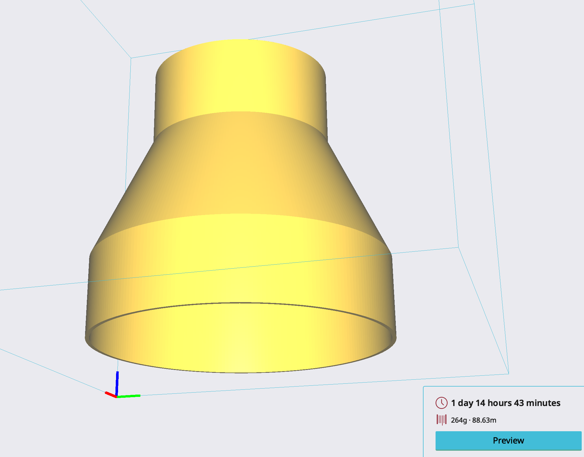

Thorfun Posted September 25, 2022 Author Share Posted September 25, 2022 12 minutes ago, TonyT said: Good shout now I've just got to figure out how to get 2 x 63mm twinwall + 1 x 54mm rigid duct through a 150mm duct in to the basement! I'm thinking a nice 3D printed Y-branch should do the trick and I can put the 2 x 63mm twinwalls into the Y-branch and then I can fit them through the duct in to the basement. nothing is easy is it? Link to comment Share on other sites More sharing options...
Thorfun Posted September 25, 2022 Author Share Posted September 25, 2022 maybe if I go down to 50mm twinwall (or maybe 40mm assuming the 32mm ID will accept the SWA and network cable) I could fit all three through the wall? will measure it tomorrow. Link to comment Share on other sites More sharing options...

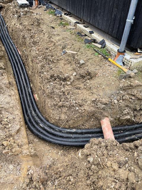

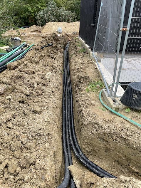

Thorfun Posted September 27, 2022 Author Share Posted September 27, 2022 hope you're all happy now! 😂 it's like modern art. currently 3D printing a bespoke reducing funnel to accept 5 ducts (these 4 x 63mm twinwalls plus another 54mm rigiduct) to allow the cables to feed through a 110mm twinwall duct going through to my basement. it's going to take a while to finish! 3 Link to comment Share on other sites More sharing options...
