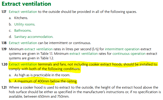

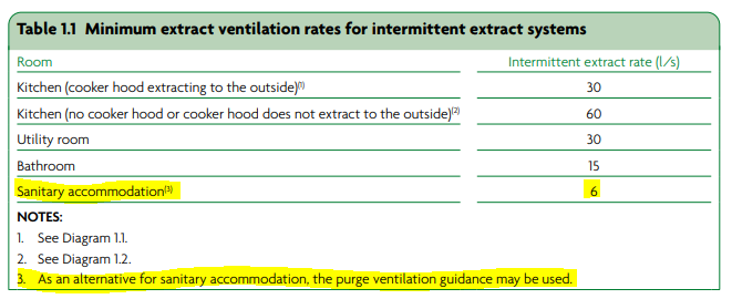

MortarThePoint Posted February 3, 2023 Author Posted February 3, 2023 Part F of Building Regs: https://assets.publishing.service.gov.uk/government/uploads/system/uploads/attachment_data/file/1045918/ADF1.pdf
MortarThePoint Posted February 3, 2023 Author Posted February 3, 2023 But looks like the window could count as an alternative so extractor fans not actually required for toilets (without bath or shower). I'm a but surprised so would need double checking with BCO. If extractor not required you could add one in a non compliant position.
