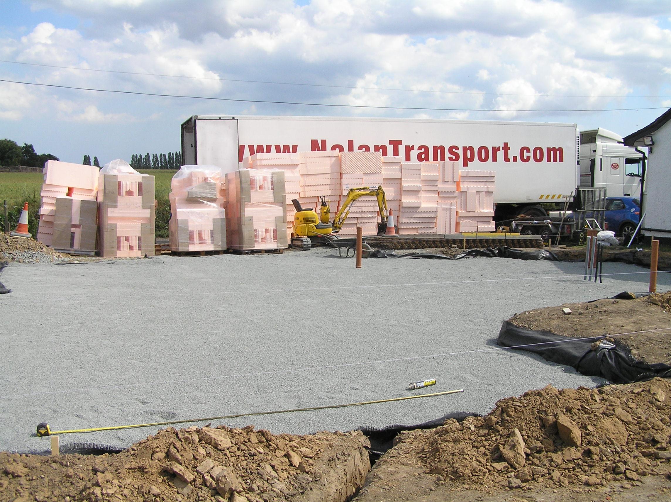

Field_of_Dreams Posted September 17, 2022 Posted September 17, 2022 Hi all, just about to lay an MOT sub base that will be 525mm deep and wondered what level accuracy I should realistically be aiming for? it will have a 50mm blinding layer of clean stone on top and then an Isoquick insulated raft on top. me being me expect it to be within 1mm over the 10m x 5m area but i dont know if that is realistic when doing this type of thing. any guidance/reality checks most appreciated. thanks
markc Posted September 17, 2022 Posted September 17, 2022 MOT within 30mm(ish), blinding around 10mm is good.
Gone West Posted September 17, 2022 Posted September 17, 2022 When we had our Isoquick insulated slab base laid out they were working to 2mm accuracy for the granite fines finish.
Chanmenie Posted September 17, 2022 Posted September 17, 2022 I looked into insulated rafts and the suppliers were asking for 3 - 5mm
Field_of_Dreams Posted September 17, 2022 Author Posted September 17, 2022 Thanks for the insight guys. i will aim for the 10mm on the mot and 3mm on the clean stone. 1

Mr Punter Posted September 18, 2022 Posted September 18, 2022 You may need some slightly finer material to spread on the lower areas. If there are high bits you may need to scratch out some material before you run over it again.
Gone West Posted September 19, 2022 Posted September 19, 2022 15 hours ago, Field_of_Dreams said: 10mm seems too difficult for me. Are you rolling or vibrating the type 1 flat? If it's way out with just a few big lumps of stone just pull them out and go over it again. It's most important to get the granite fines level.
