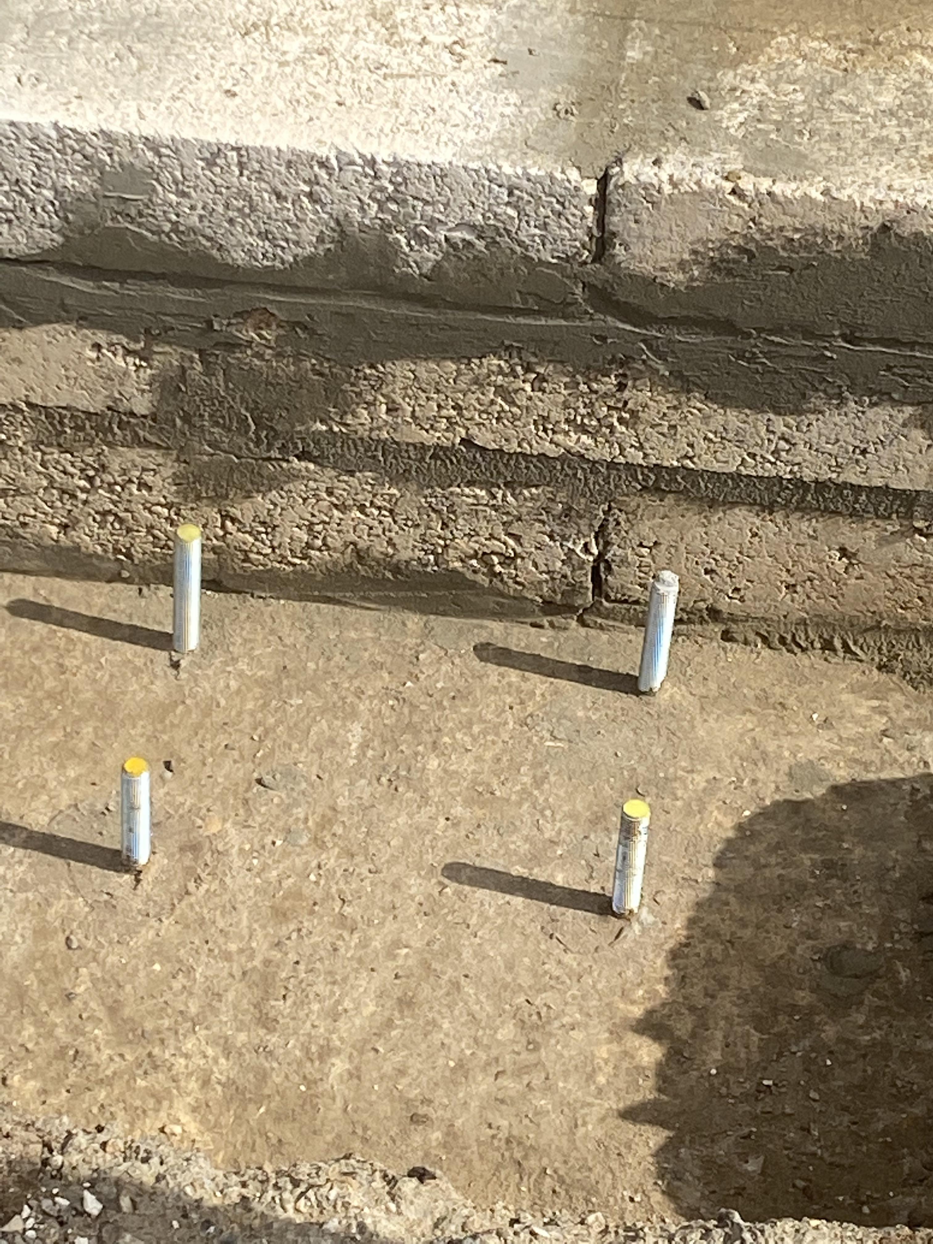

Chanmenie Posted September 16, 2022 Share Posted September 16, 2022 I have a pair of goal post vertical steel columns coming up from the foundations, they will be bolted to the concrete footings. They will be boxed in with shuttering to enable completion of the ground build up with insulation, UFH and the pour of the concrete slab. Once this is completed and the ICF walls built up, how should I fill in around the columns up to finished floor level, will cement/concrete corrode the steel ? Link to comment Share on other sites More sharing options...

Chanmenie Posted September 17, 2022 Author Share Posted September 17, 2022 10 hours ago, Chanmenie said: Yeah I can insulate it where the concrete slab is going but it’s a bit late to put armatherm under it @Simplysimon, Having said that, the studs I have resined into the concrete are 30mm longer than required so if Armatherm or an alternative is available in 30mm I assume that would be better than nothing ? Link to comment Share on other sites More sharing options...
markc Posted September 17, 2022 Share Posted September 17, 2022 The amount of heat transfer by the studs and post base will be very small Link to comment Share on other sites More sharing options...

Mr Punter Posted September 17, 2022 Share Posted September 17, 2022 14 hours ago, Simplysimon said: armatherm or similar should be placed below steels The trouble is lack of availability. Where can you easily buy this? Is there an actual stockist in the UK? Also, to get this to work it would need to be fitted at the same time as the steels or slipped underneath. Normally I just see the base plates shimmed with steel and filled under with structural grout. 1 Link to comment Share on other sites More sharing options...

markc Posted September 17, 2022 Share Posted September 17, 2022 1 minute ago, Tom said: we used some armatherm to sit a vertical steel on. Ridiculously expensive for what it is really and will probably make no difference to anything other than my wallet True, and if you had holding down bolts or rods then there is no point trying to isolate the base Link to comment Share on other sites More sharing options...
