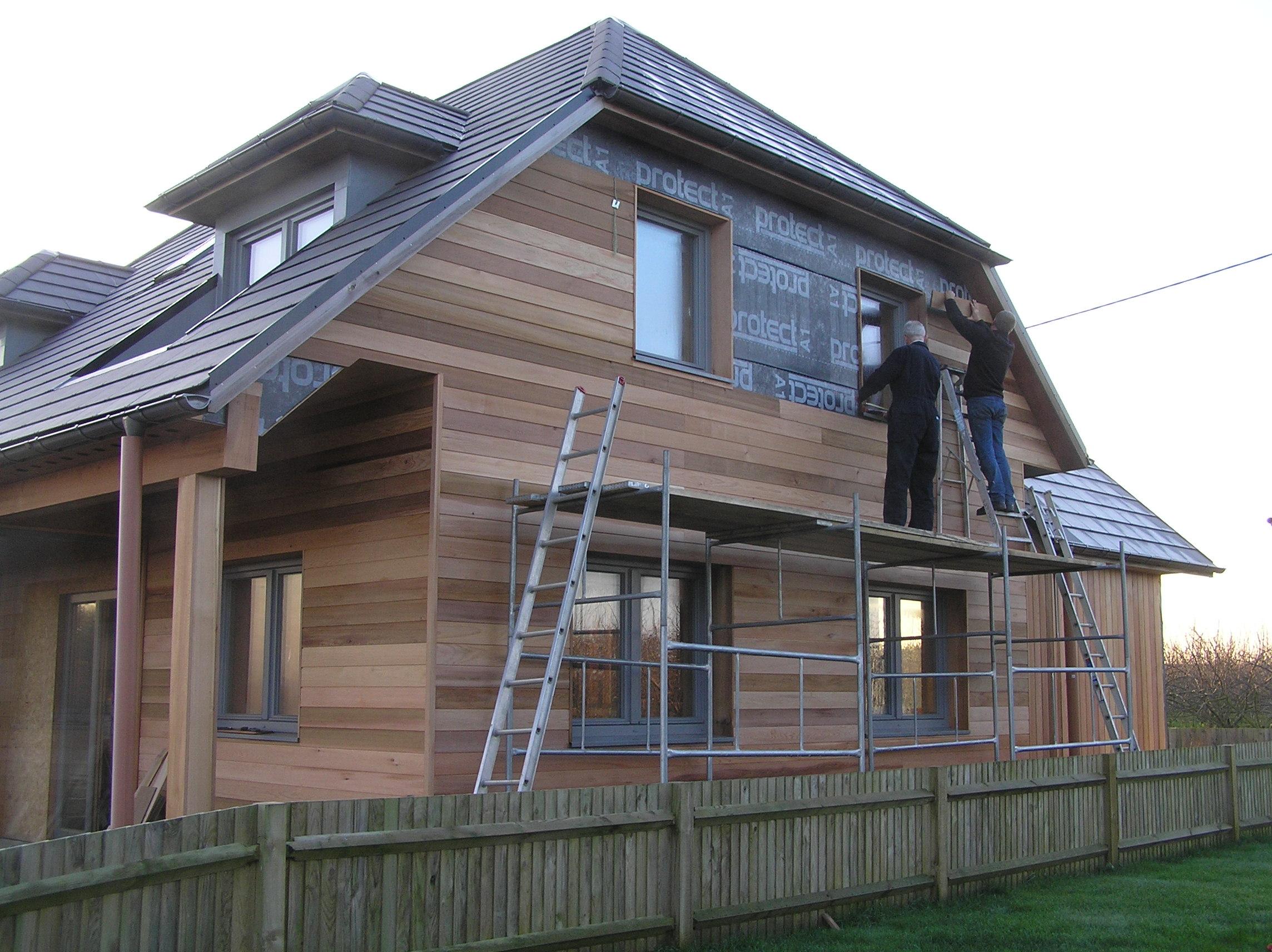

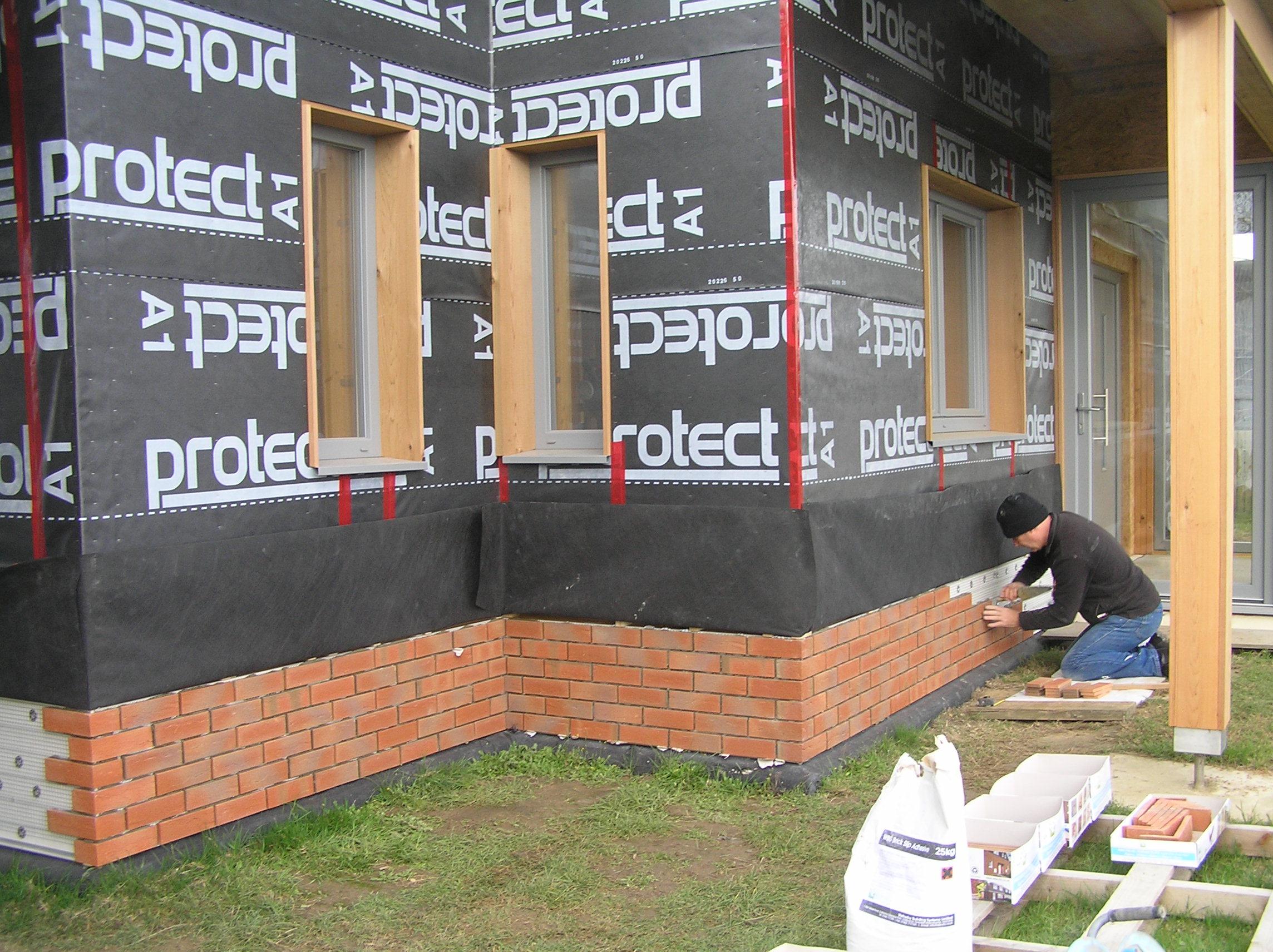

Gone West Posted September 12, 2022 Posted September 12, 2022 23 hours ago, GrantMcscott said: not sure if this sounds a bit excessive or not. Difficult to compare, but nine years ago we had the plinth covered with brick slips, after I had fitted the board and steel mesh. We also had the rest of the building clad with cedar and it took two men for the cedar cladding and one man for the brick slips. It took around two weeks and the labour was £4500. 1
GrantMcscott Posted September 12, 2022 Author Posted September 12, 2022 9 minutes ago, Gone West said: Difficult to compare, but nine years ago we had the plinth covered with brick slips, after I had fitted the board and steel mesh. We also had the rest of the building clad with cedar and it took two men for the cedar cladding and one man for the brick slips. It took around two weeks and the labour was £4500. Where is the ceadart clad from it look realy good?
Gone West Posted September 12, 2022 Posted September 12, 2022 8 minutes ago, GrantMcscott said: Where is the ceadart clad from it look realy good? It was Canadian cedar supplied by the local timber yard. The grade was number 2 clear and better, so had very few knots.

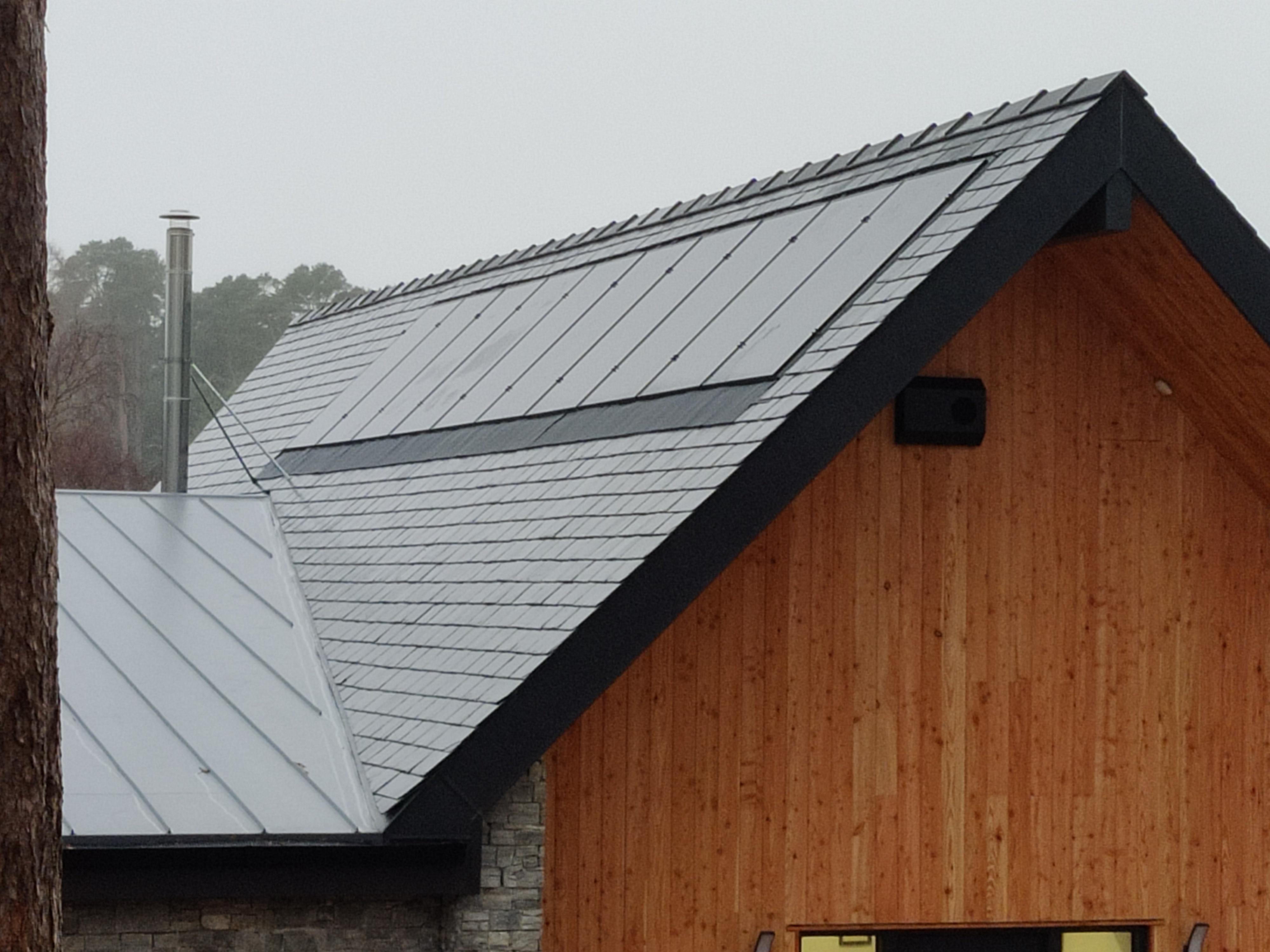

Andeh Posted September 12, 2022 Posted September 12, 2022 That looks OK 4 hours ago, JohnMo said: I purchased 142m2 from real stone cladding, directly adhered to Durisol blocks. Took about 3.5 weeks (full time) for me to install, with wife helping out. Having never done it before, would expect a couple of guys to do the same amount way quicker. Assume you will scaffold also. That looks good, have you got any more pics of that timber cladding on the underside of the apex?
JohnMo Posted September 12, 2022 Posted September 12, 2022 16 minutes ago, Andehh said: That looks OK That looks good, have you got any more pics of that timber cladding on the underside of the apex? Sorry not the best photo
Andeh Posted September 18, 2022 Posted September 18, 2022 Thanks, that looks lovely! What wood did you use, how did you get that colour?
JohnMo Posted September 18, 2022 Posted September 18, 2022 The wood is Scottish larch. Colour is natural, at the moment its untreated. The front of the house looks almost the same and its treated with cedar oil. The rear gable are faces North east so doesn't get the sun, so low on the priority list to coat.
Gone West Posted September 19, 2022 Posted September 19, 2022 11 hours ago, JohnMo said: The rear gable are faces North east so doesn't get the sun, so low on the priority list to coat. We found with our cedar that it is the rain that washes out the colour more than the sun bleaching it. The north side of the house faded just as much as the other elevations. The only areas that kept any colour were those protected from the rain.
