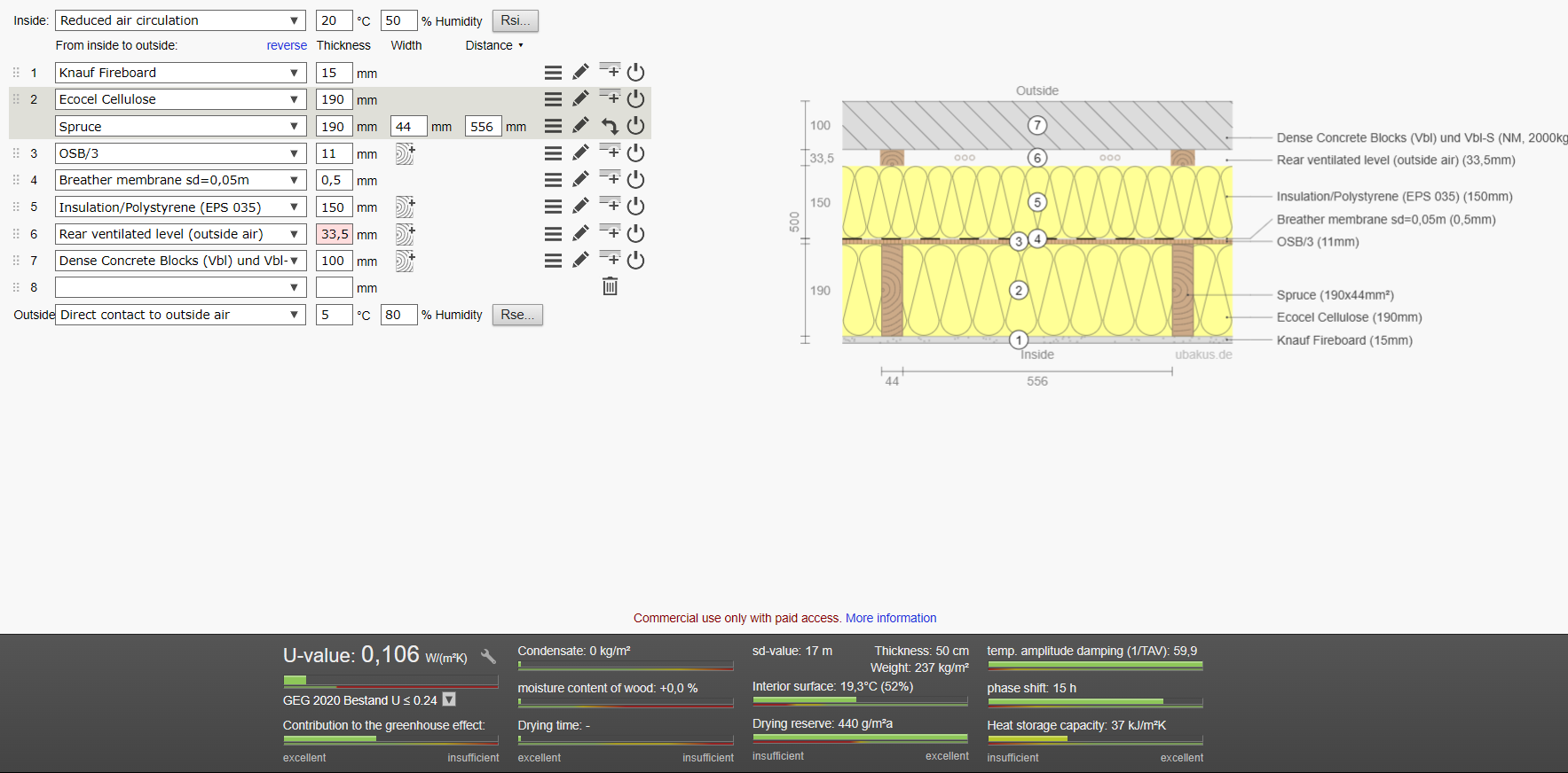

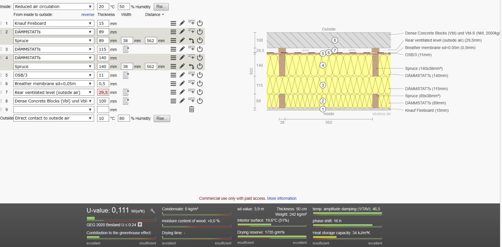

Iceverge Posted June 29, 2023 Share Posted June 29, 2023 Here's 2 options for my preferred stick build option if I was doing it myself. Tape the OSB externally as an airtight layer in both cases. Some will complain that this is the wrong side but if I could oversee it then I would be more than happy.\ re the condensation risk. All off the shelf materials. The one with external foam could be easily scaled down for thinner walls and lower U values. Link to comment Share on other sites More sharing options...
