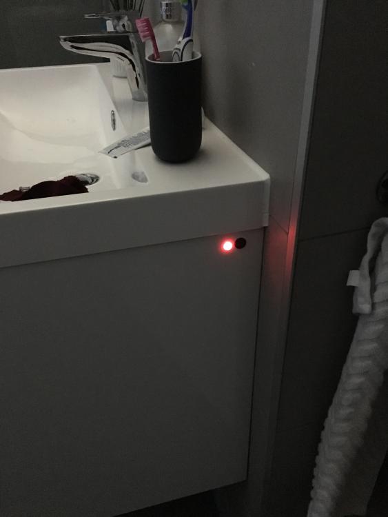

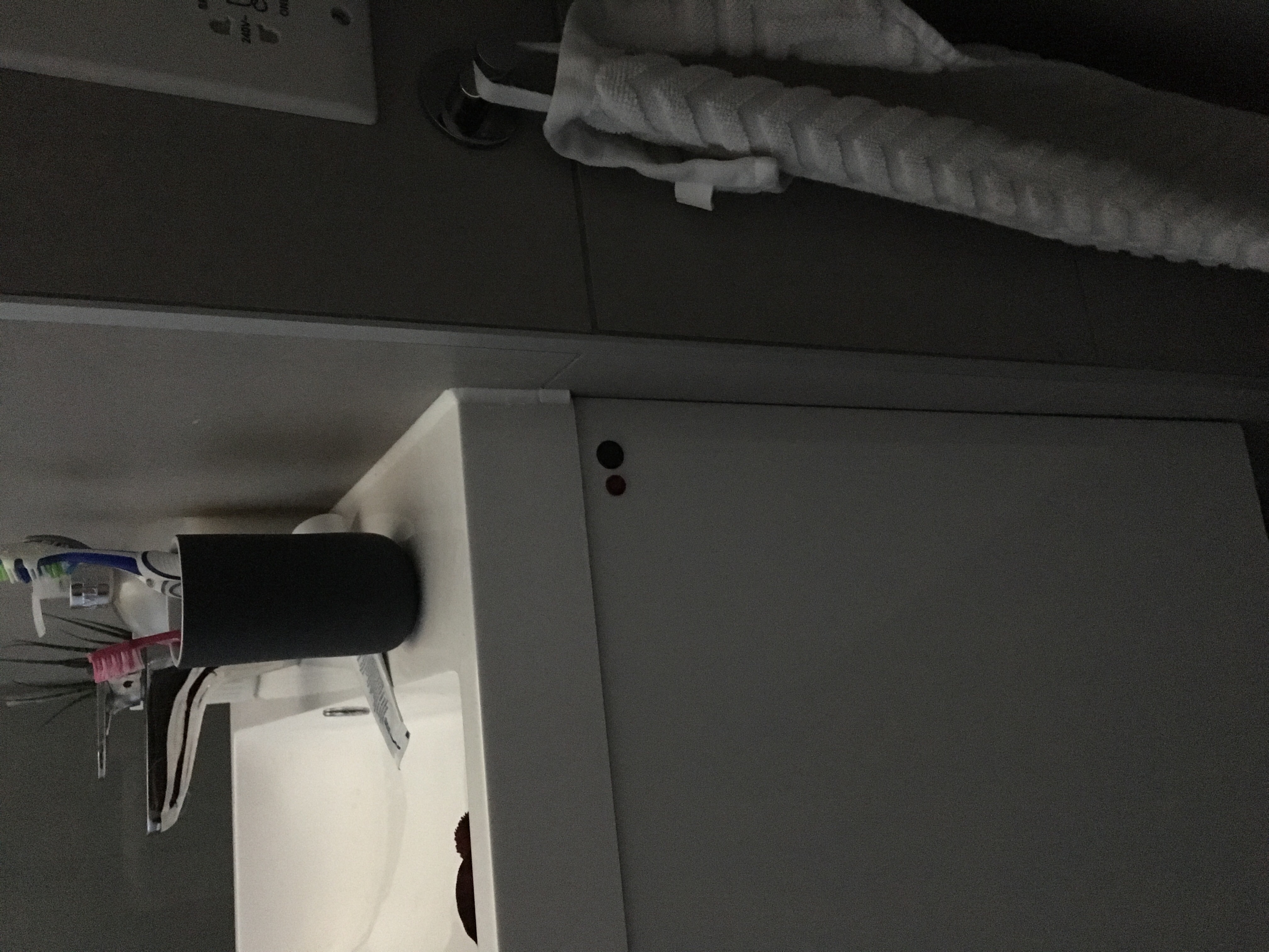

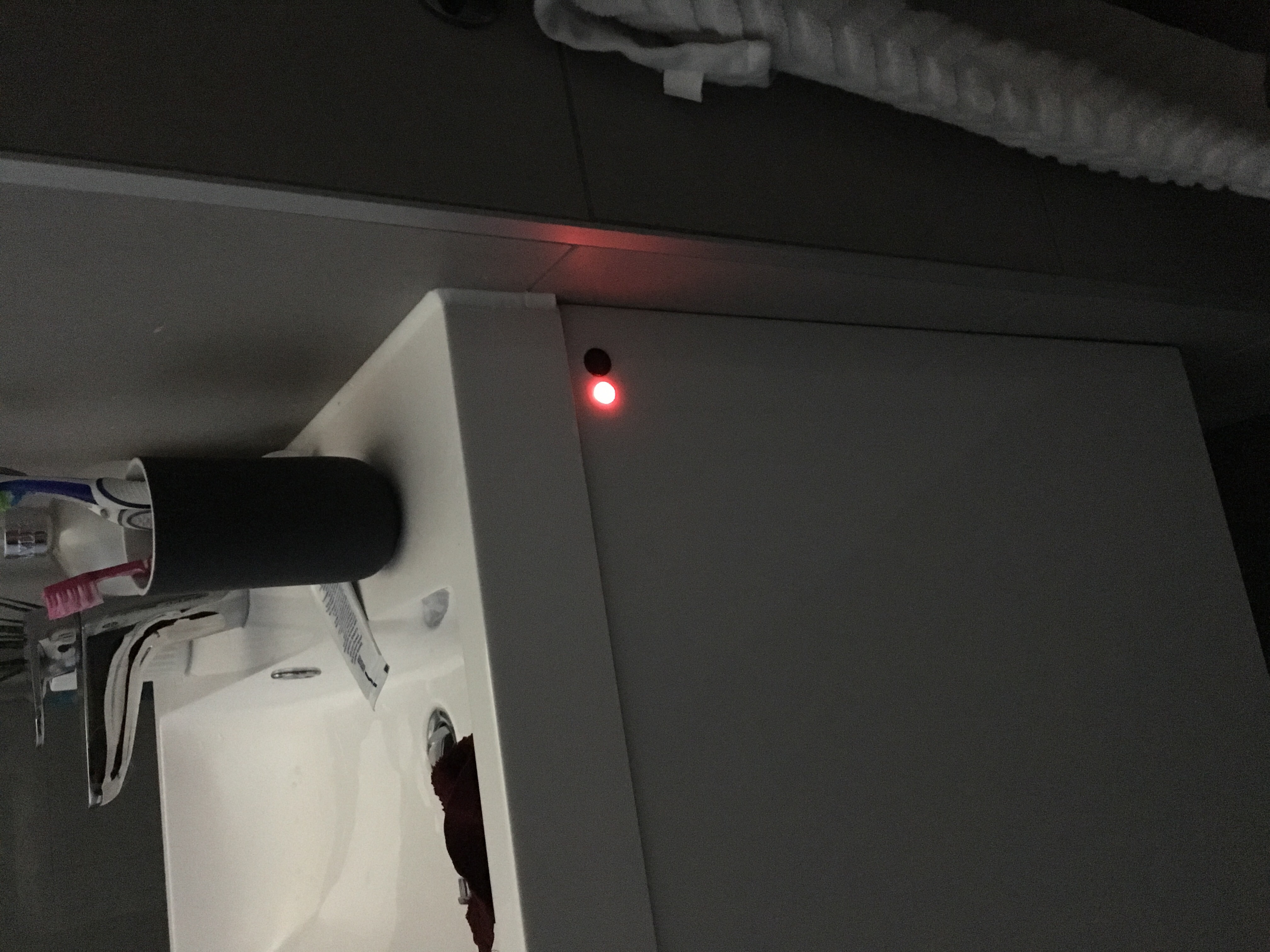

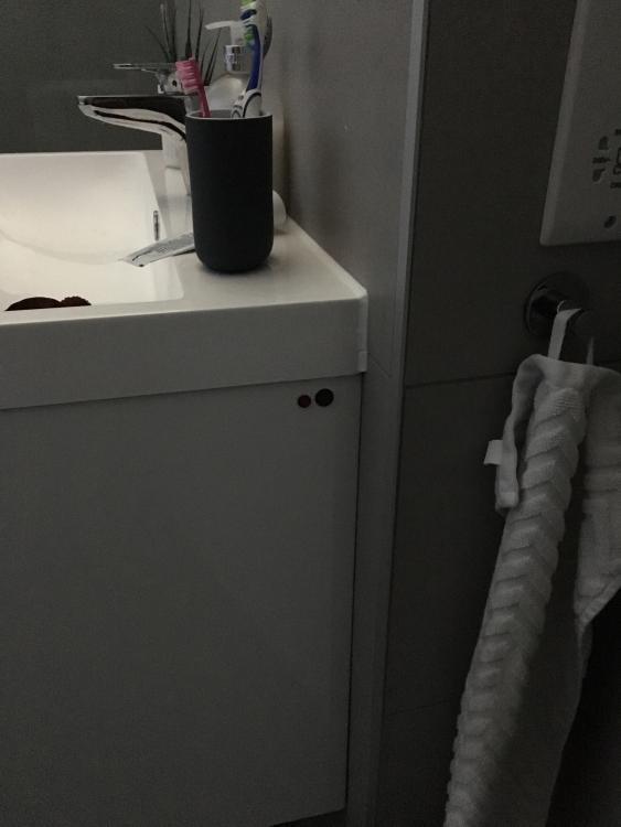

Calvinmiddle Posted June 13, 2017 Share Posted June 13, 2017 Nick I think you helped me solve this very issue over on ebuild!! it was a swipe on swipe off PIR switch with a panel? light and fuse to indicate if it was on or not. It works a treat, will take a picture when I get home and will hunt out the post on ebuild to link to. Link to comment Share on other sites More sharing options...
Calvinmiddle Posted June 13, 2017 Share Posted June 13, 2017 Nick Here is the thread from ebuild Demister woes 1 Link to comment Share on other sites More sharing options...

Calvinmiddle Posted June 13, 2017 Share Posted June 13, 2017 Some pics Link to comment Share on other sites More sharing options...
