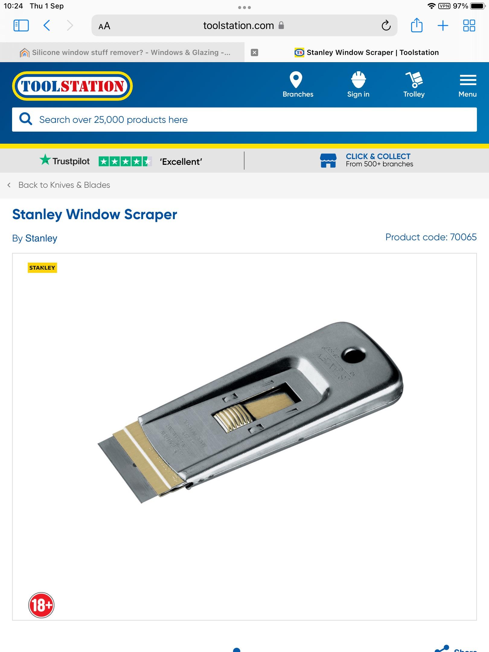

markc Posted September 1, 2022 Share Posted September 1, 2022 Never found anything that works better then scraping with a low angle blade scraper and then using your finger to rub off the bits that remain. 1 1 Link to comment Share on other sites More sharing options...

craig Posted September 2, 2022 Share Posted September 2, 2022 We use https://www.teknos.com/en-GB/industrial-coatings/industries/building-exteriors/windows-and-doors/teknos-clean-kit/ but a bit of elbow grease and a gentle scrub and washing up liquid will also do the job, it will work on the glass as well but first we will take a good quality Stanley blade and carefully scrape of the silicone. Trust me, it happens every day, it's easier to clean it off once it's cured. 1 Link to comment Share on other sites More sharing options...

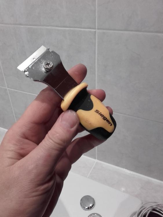

Onoff Posted September 3, 2022 Share Posted September 3, 2022 I genuinely found the No Nonsense Silicone Remover from Screwfix pretty good. Leave to soften them take off with a blade like the above. C-Tec Multisolve to finish off. Quite impressed too with the heavy duty Big Wipes that come in the yellow tub with red lid. Link to comment Share on other sites More sharing options...
Onoff Posted September 3, 2022 Share Posted September 3, 2022 This is the scraper I rate. Bought from the local motor factors: Link to comment Share on other sites More sharing options...
