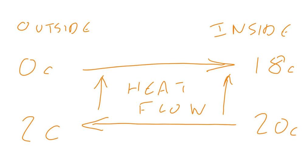

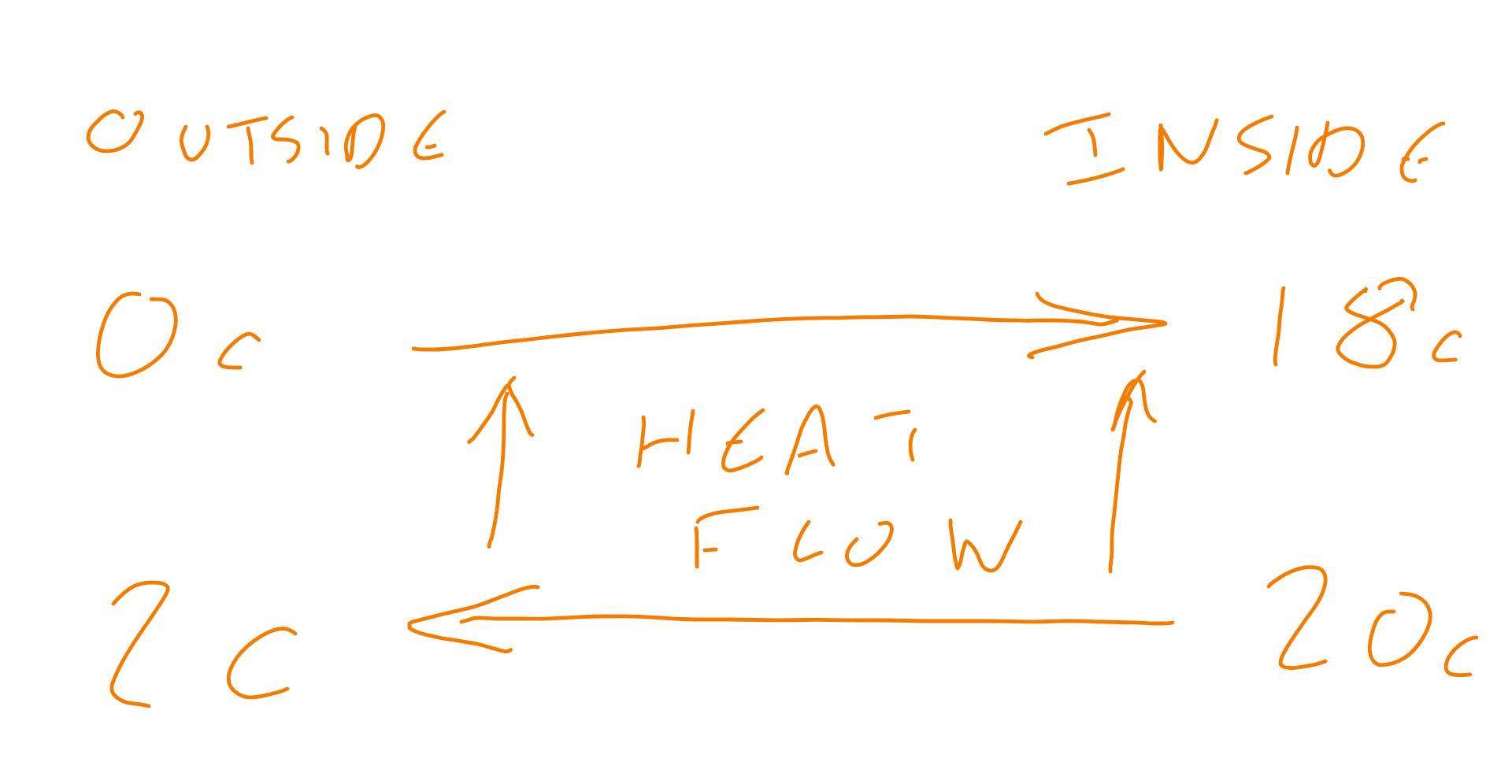

Temp Posted August 30, 2022 Share Posted August 30, 2022 Sorry for the poor quality sketch but my understanding is that mvhr heat exchangers work something like this.. To make much difference the incoming air would have to be preheated so that the 18C incoming air is hotter. But if it goes over 20C the heat exchanger will work in reverse heating the outgoing air. Am I missing something? Link to comment Share on other sites More sharing options...

Lilly_Pines Posted August 30, 2022 Author Share Posted August 30, 2022 57 minutes ago, Temp said: Sorry for the poor quality sketch but my understanding is that mvhr heat exchangers work something like this.. To make much difference the incoming air would have to be preheated so that the 18C incoming air is hotter. But if it goes over 20C the heat exchanger will work in reverse heating the outgoing air. Am I missing something? If the incoming air starts at 10c instead of 0c it arrives at 19c instead of 18c. Not a huge difference until you crank up the ventilation rate to silly levels because you like fresh air even in winter, and enthalpy cores that exchange moisture as well as heat have lower efficiency to begin with. Link to comment Share on other sites More sharing options...
