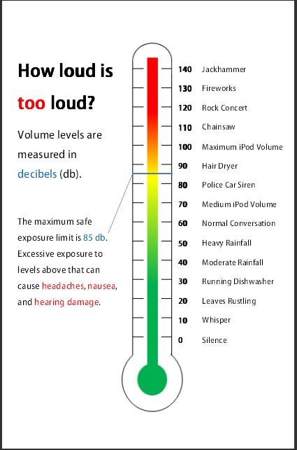

joe90 Posted September 6, 2022 Share Posted September 6, 2022 34 minutes ago, HughF said: They look just the job. Although it says quiet, how quiet is 58dbA? How noisy is 58 dBA? 0 dB is considered the threshold of human hearing and 120-140 dB is considered the threshold of pain. That means a sound so powerful, it will make your ears hurt. 60 decibels is right in the middle of this range between no sound at all and painfully intense sound. 60 dB is the equivalent of a normal conversation level. Link to comment Share on other sites More sharing options...
SteamyTea Posted September 7, 2022 Share Posted September 7, 2022 13 hours ago, joe90 said: 60 decibels is right in the middle of this range between no sound at all and painfully intense sound. It is a log scale though. "Two principal types of scaling of the decibel are in common use. When expressing a power ratio, it is defined as ten times the logarithm in base 10.[5] That is, a change in power by a factor of 10 corresponds to a 10 dB change in level. When expressing root-power quantities, a change in amplitude by a factor of 10 corresponds to a 20 dB change in level. The decibel scales differ by a factor of two, so that the related power and root-power levels change by the same value in linear systems, where power is proportional to the square of amplitude." 14 hours ago, HughF said: I’m probably going to install one of these at my boss’ house soon to heat and dehumidify a downstairs room. They look just the job. And no F-gas requirement Let us know how it goes, would heat my house very nicely, and could go back under the window where the storage heater was. Link to comment Share on other sites More sharing options...
markc Posted September 7, 2022 Share Posted September 7, 2022 Background or Ambient noise levels in what most people would deem a fairly quiet area is often around 65-70dB Link to comment Share on other sites More sharing options...

Radian Posted September 7, 2022 Share Posted September 7, 2022 10 hours ago, markc said: Background or Ambient noise levels in what most people would deem a fairly quiet area is often around 65-70dB Not sure about that. I know it's subjective but I feel anything in the 50's is going to annoy eventually. Link to comment Share on other sites More sharing options...
