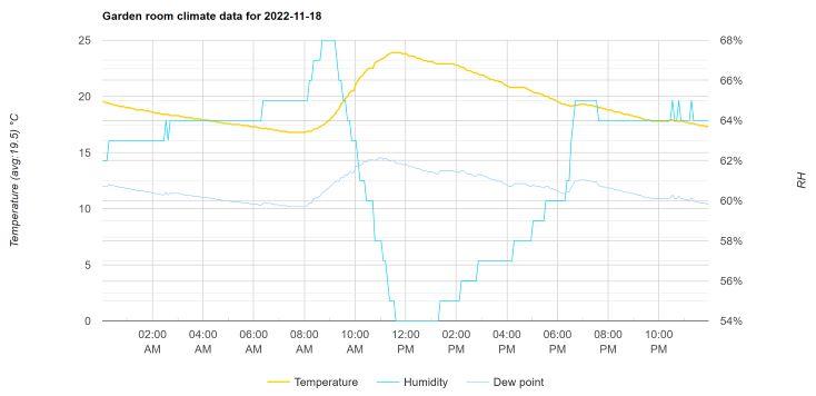

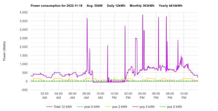

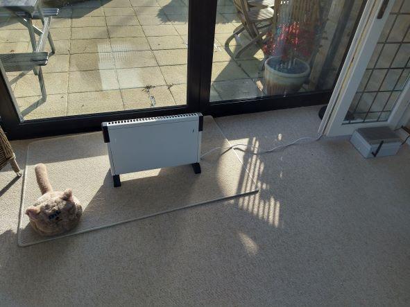

Radian Posted November 22, 2022 Posted November 22, 2022 At the weekend I did a little experiment to see how well I could heat our garden room using excess PV generation alone. I say alone which isn't quite accurate as this side has 9m2 of patio doors pointing S.E. so we also harvested about 2.5kWh of solar gain on this occasion. It had gotten up to 24oC by 11:30AM and everyone was sweating buckets: The import power total (magenta plot) flatlines between 9AM to 1:30PM as the excess PV is diverted to the 2kW convector (except for the kettle going on for elevenses) I haven't started logging the PV output to the database yet but we generated 8.6kWh on this day in the second half of November - which is frankly better than I anticipated. At least the robot cat (mouser) was enjoying the heat. 1
