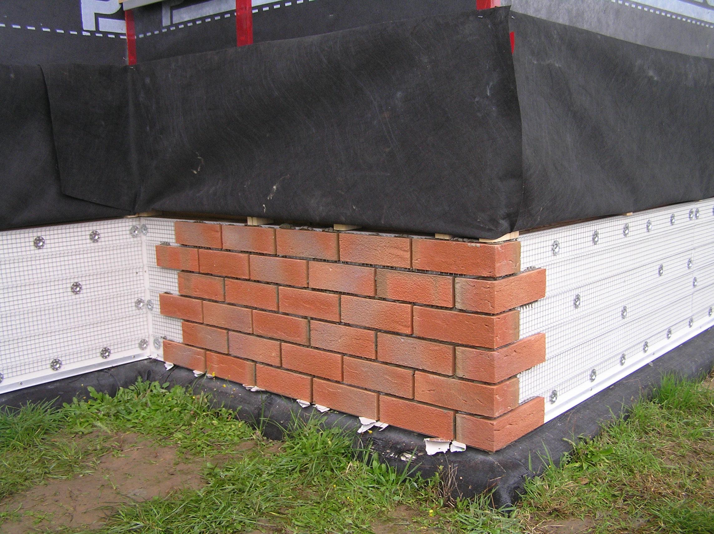

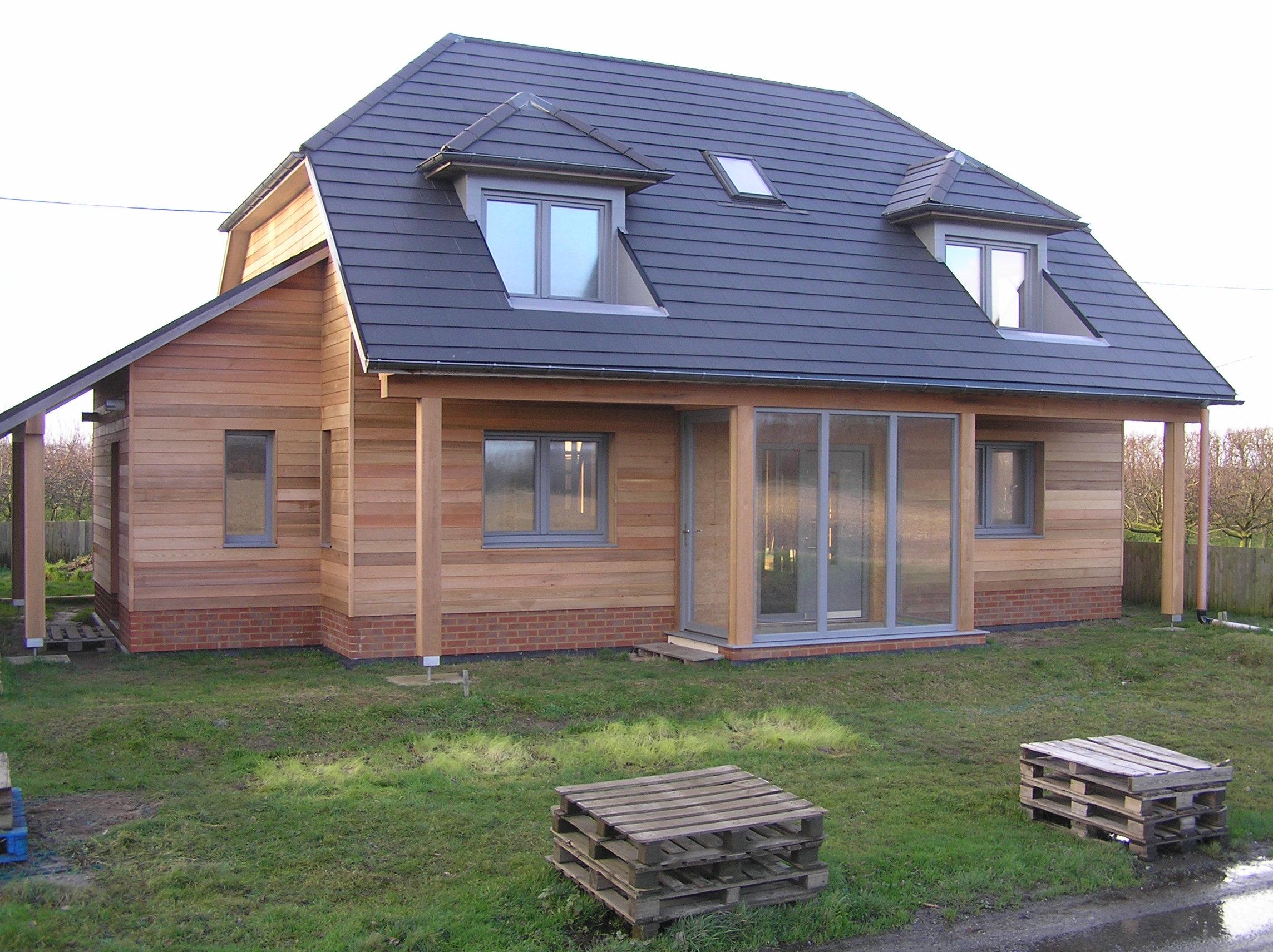

I stuck brick slips on mine, and five years later they were still there when I sold it.

2 hours ago, Highland build said:
Have you got any photos @Gone West and what are brick slips?
Brick slips are slices of brick 10mm to 15mm thick which can be stuck to various substrates to give the effect of a solid brick wall. It certainly works as everyone thought our brick slips were whole bricks.
https://www.wbs-ltd.co.uk/systems-solutions/system-finishes/15mm-brick-slips/
On the area under the porch glazing I stuck the brick slips directly to the EPS using gel PU glue. On the area under the front door you can see the EPS which was covered by the ramp up to the door. On the rest of the brick plinth the brick slips were attached using the Wetherby system on to BluClad board.

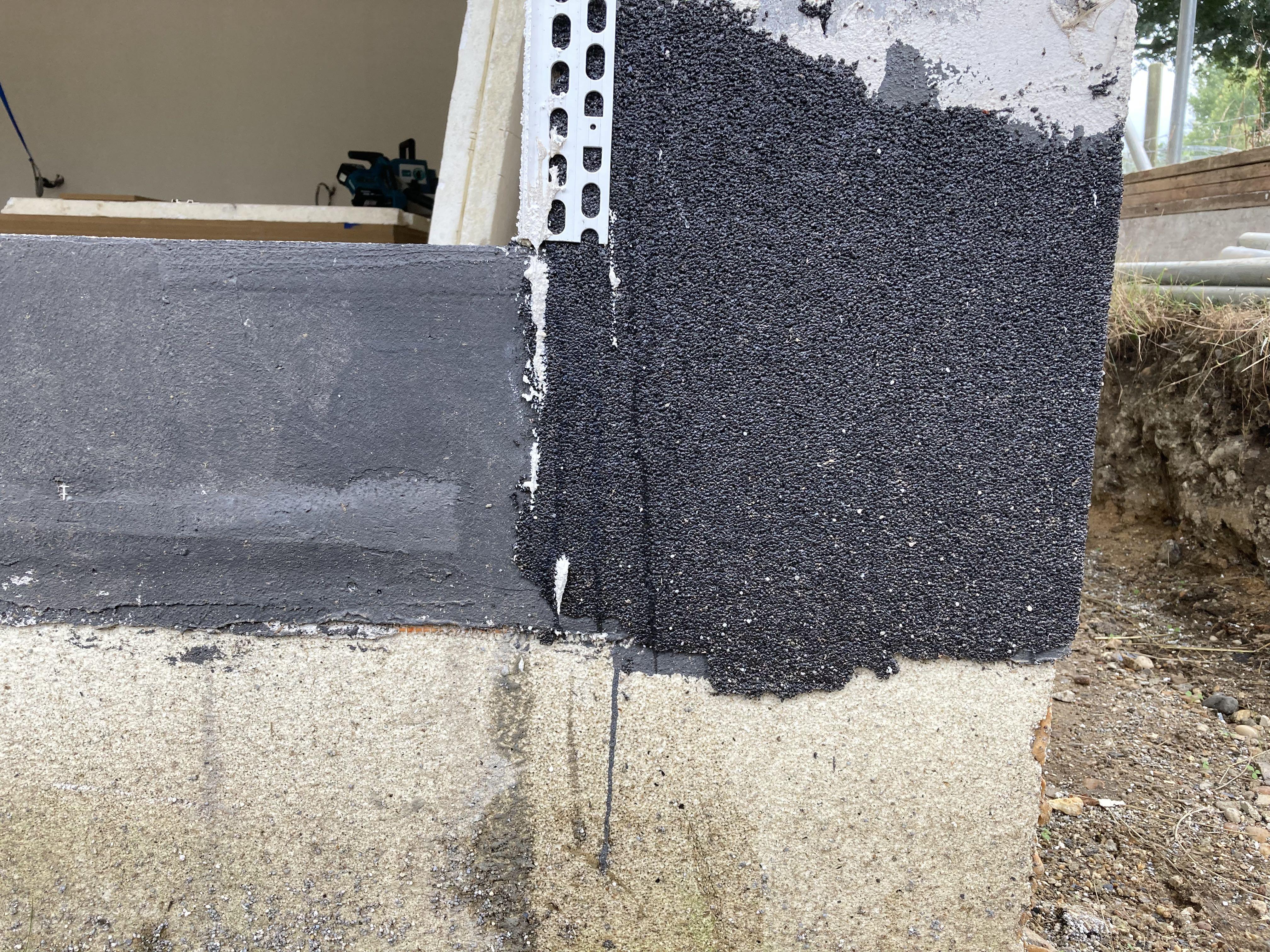

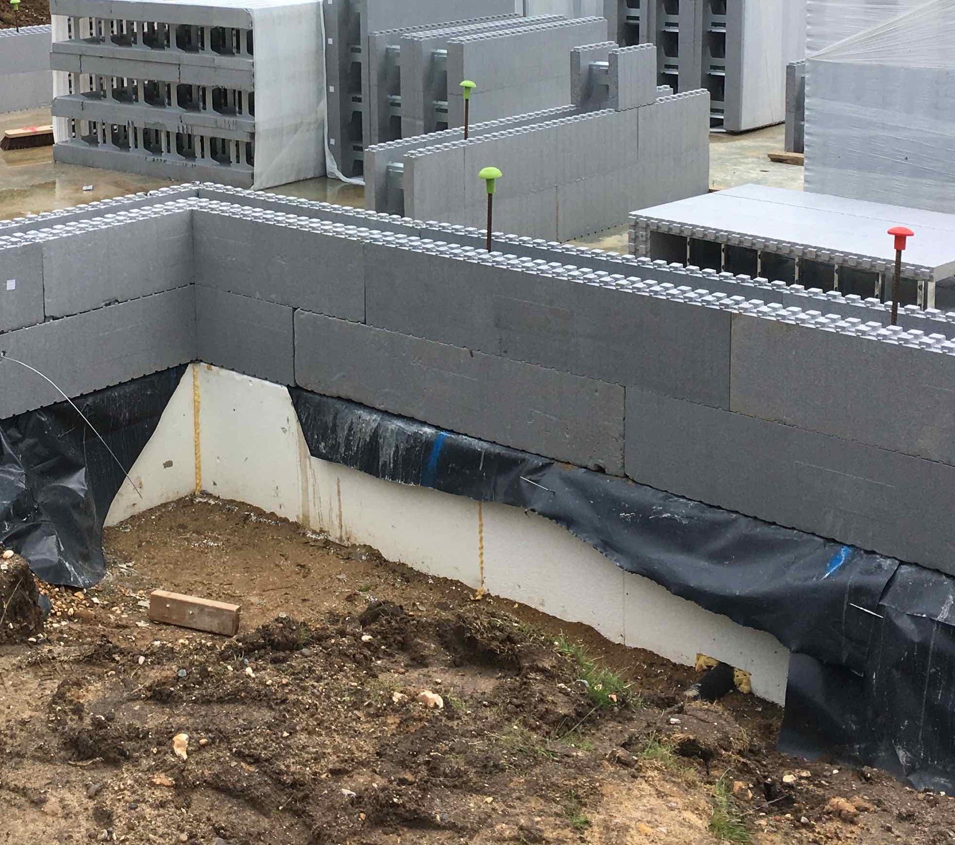

We had our Kore Insulated Foundation perimeter rendered with EWI-050 Mosaic, this is their below DPC product. This was about two months ago.
https://ewistore.co.uk/shop/external-wall-insulation/mosaic-render-ewi-050-25kg/
hi @Nick Laslett So did you do the basecoat and the mesh and then the mosaic render over the top as a second coat?
@Gone Westthose brick slips look amazing was yours isoquick base?
Yes. Base coat, mesh, acrylic primer then mosaic.
EWI-225 Premium Basecoat
Orange Fibreglass Mesh
EWI-330 Acrylic Primer
EWI-050 Mosaic Render
Here is the EWIPro technical drawing for the below ground build up.
https://ewipro.com/wp-content/uploads/2022/02/4-Base-profile-with-an-insulated-plinth-and-insulation-system-installed-below-ground-level-1.pdf
They spec EWI-226 Aquabase in this drawing.
Our renderers specified the EWI-225 Premium basecoat for the walls and the below DPC foundation surround. I never questioned if we needed something different for the foundation. Looking at the spec sheets, EWI-225 is also frost resistant and water resistant. Not sure if the Aquabase is cheaper?
Edited by Nick Laslett
I think EWI-226 Aquabase is preferred for XPS and EWI-225 Premium is preferred for EPS. The Aquabase is more expensive.

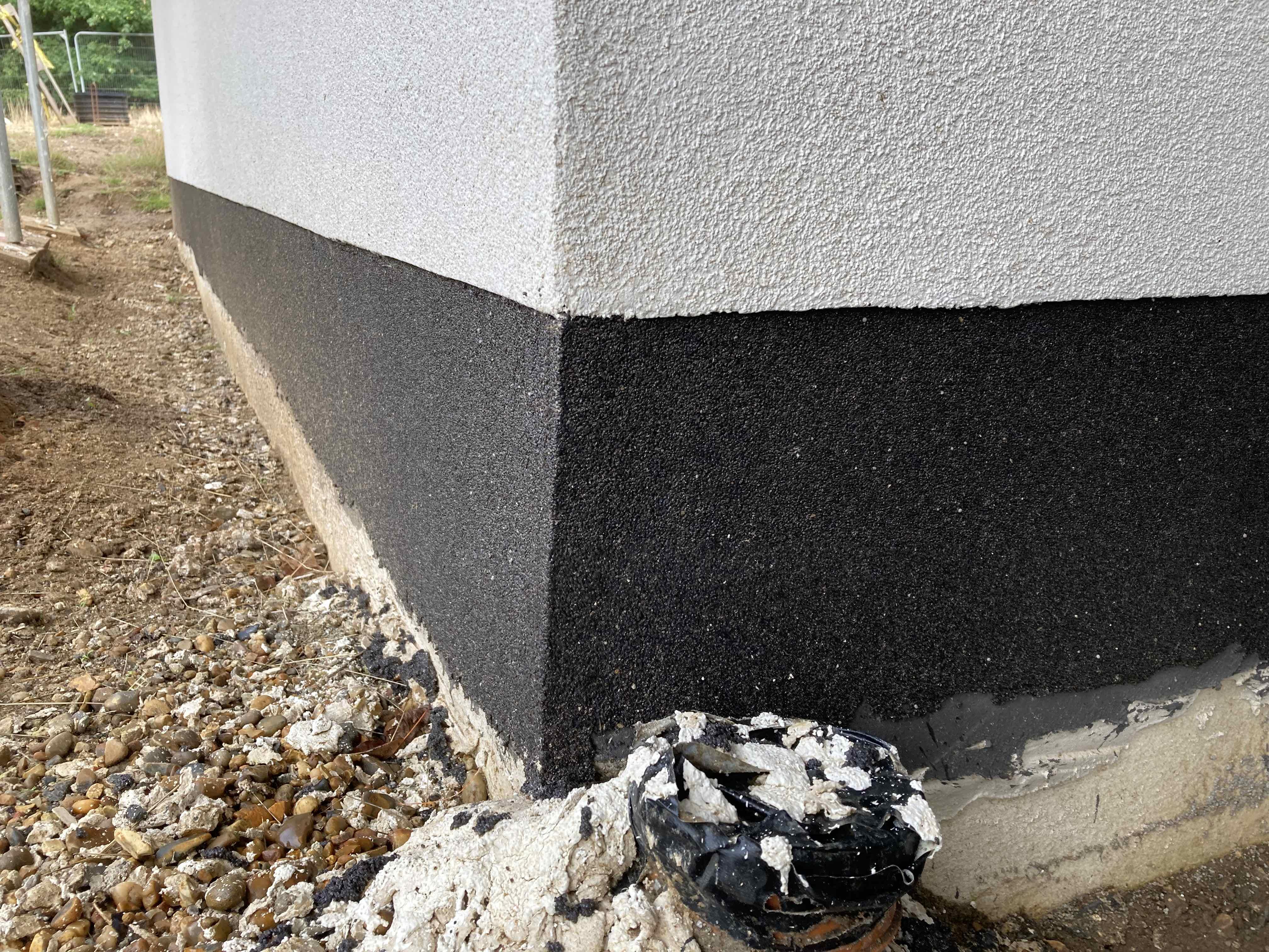

On 06/09/2022 at 09:42, Highland build said:
@Nick Laslett this is amazingly helpful thank you so much had a gur round last night to look at it and i think were gonna go with the render.
Have you got any photos?
First photo is garage, this shows EW-330 acrylic primer on the left and the Mosaic on the right.

33 minutes ago, Highland build said:
@Nick Laslett
Brilliant I've got ten bags of the aquabase 226 and the mesh and corner beads delivered so I'm gonna just go for a coat of that and see what it looks like if the colours too dark for me apparently you can paint it with silicone based paint.
I'll get some before and after pics and see for the group.
Cheers
Maddie
It won’t be dark, it dries a very light grey colour.
You really need the mosaic on top as the base is not very attractive, unless you can get a sponge finish on it.
