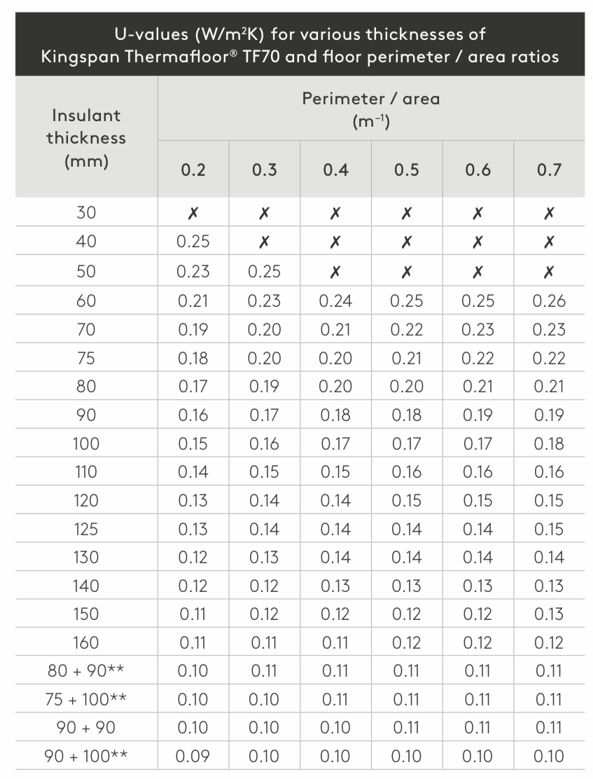

Posted
Thanks JohnMo
I have a ground floor SAP target of 0.10 W/m2K and the plans state, from the ground up.
1. Min 150mm sub base
2. 50mm sand blinding
3. DPM
4. 100 Concrete slab
5. 150mm PIR insulation
6. 50mm Liquid screed (With UFH pipes embedded)
Someone said that I'd require 170mm of PIR to achieve 0.10 for the floor so I wanted to check if 150 was going to do it or not.
Posted (edited)
  On 23/08/2022 at 18:58, ruggers said:
Thanks JohnMo
3. DPM
Expand
Not a recommendation, this was just the quickest PIR board U-value I could find.
https://www.kingspan.com/gb/en/products/insulation-boards/floor-insulation-boards/
Table from Kingspan Thermafloor brochure.  Need 175mm for 0.10.
That is their standard PIR board. They have two other products with better resistance to thermal conductivity, Kooltherm is a phenolic board and Optim-R which is a VIP board. These can be much thinner. Optim-R only needs to be 70mm thick to hit 0.10 u-value.
Here is a calculator for another product, EcoTherm board, it only needed 140mm to hit 0.10.
https://uvaluecalculator.ecotherm.co.uk/calculator/
Edited by Nick Laslett
  • Thanks 1
Posted
Thanks, I might give them a call tomorrow. If 150mm can get down to 0.11/0.12, it's possible that the 100mm slab under the insulation adds a small amount of value to the 150mm insulation and brigs it to 0.10W/m2K.
Eco therm and quinn therm were always cheaper than kingspan.
Posted
I would go into the link Nick gave you.  You need to know your floor area and perimeter and floor buildup.  Then just play with the calculation
  • Like 1
