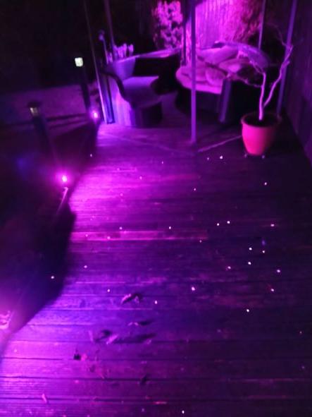

Radian Posted August 22, 2022 Share Posted August 22, 2022 I just found a fuzzy photo I took of my "starfield deck" at the end of its life. This is the prototype of a proper UK manufactured 3W colour changing LED fibre optic set that I developed. Unfortunately the cheapo B&Q deck planks only lasted 10 years and turned to rotten dust so I've had to rip it all out. The stars are actually set out to mirror the sky above on the night of the summer solstice. Many are missing due to the rotted bits falling away. Wish I'd photographed it when new 😌 Another suggestion: Copy one of stellarlighting's recessed ceiling lighting designs. The aim is to use an LED tape around the perimeter of a inverted island that drops down a little way from the true ceiling. The island itself has fibre optic points for interest and the LED tape picks out the contour of the island. The trick is to break the direct line of sight to the LED tape so you only ever see a reflected glow from it. To do this the perimeter is set back a little way from the face to create a small recess. I think you might want to make the perimeter a multiple of 5m: probably 10m e.g. four sides of a 2.5m square to make use of the standard 5m LED tape length. The island panel could be painted exterior grade ply. Also pop in some downlights to create "task lighting". If you pick Tuya/smart life compatible smart RGB GU10 lamps and RGB LED tape you can set scenes in the app for no very much money. Link to comment Share on other sites More sharing options...
