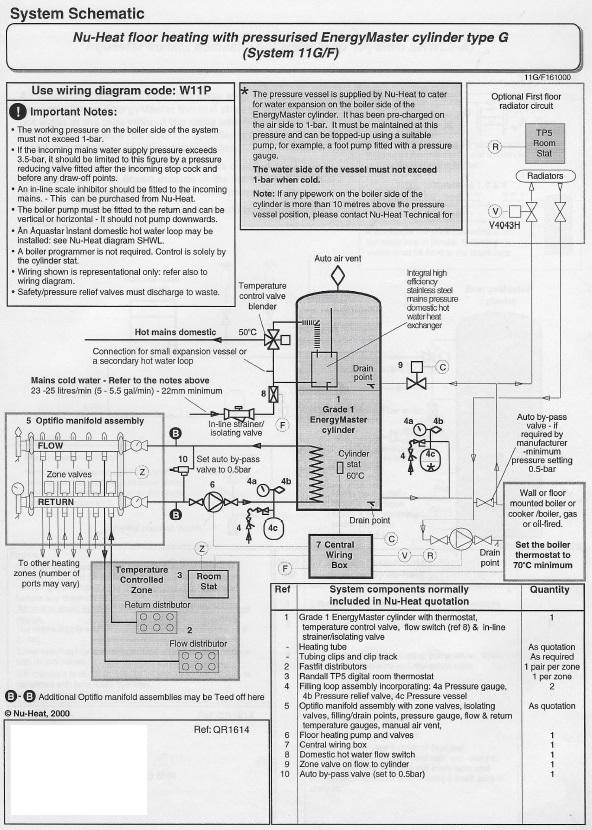

  3. Would not use a combi on a Thermal tore - don't think that is an efficient way to use them. Anway decision now made ... Heart said Intergas, but could find nobody in area who would install, most had never heard of them. So went for option 2 .... Viessmann Vitodens 100-W Heat only. Great reputation, and a key point for me a stainless steel heat exchanger. Comes with 10yr warranty as standard, and got price down to £1,024 (Incl flue) so good deal.

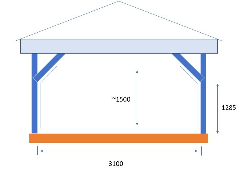

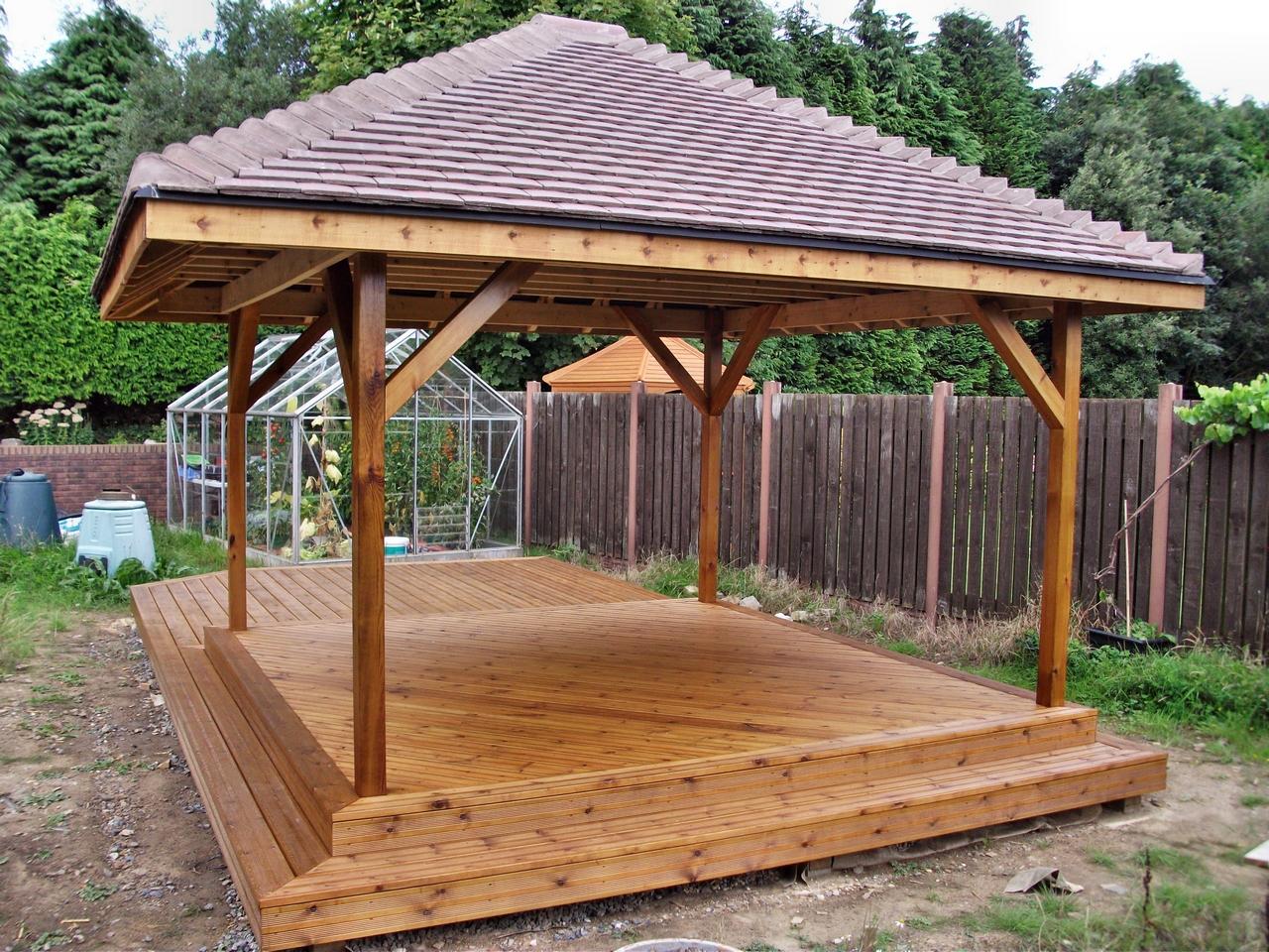

  7. I have a an outdoor 2 level decking, a HotTub is going under the roofed section, and would like to fit an etched (opaque) glass privacy screen down the side (and maybe the back.) It's around 3.1m between the corner posts. Thinking of glass spaced up about 6" from decking floor, and about halfway up the 45 degree gallows brackets. For safety assuming 10mm toughened glass. 2 glass panels with a centre post should work. Anybody done anything like this ... looking for suggestions and suppliers.

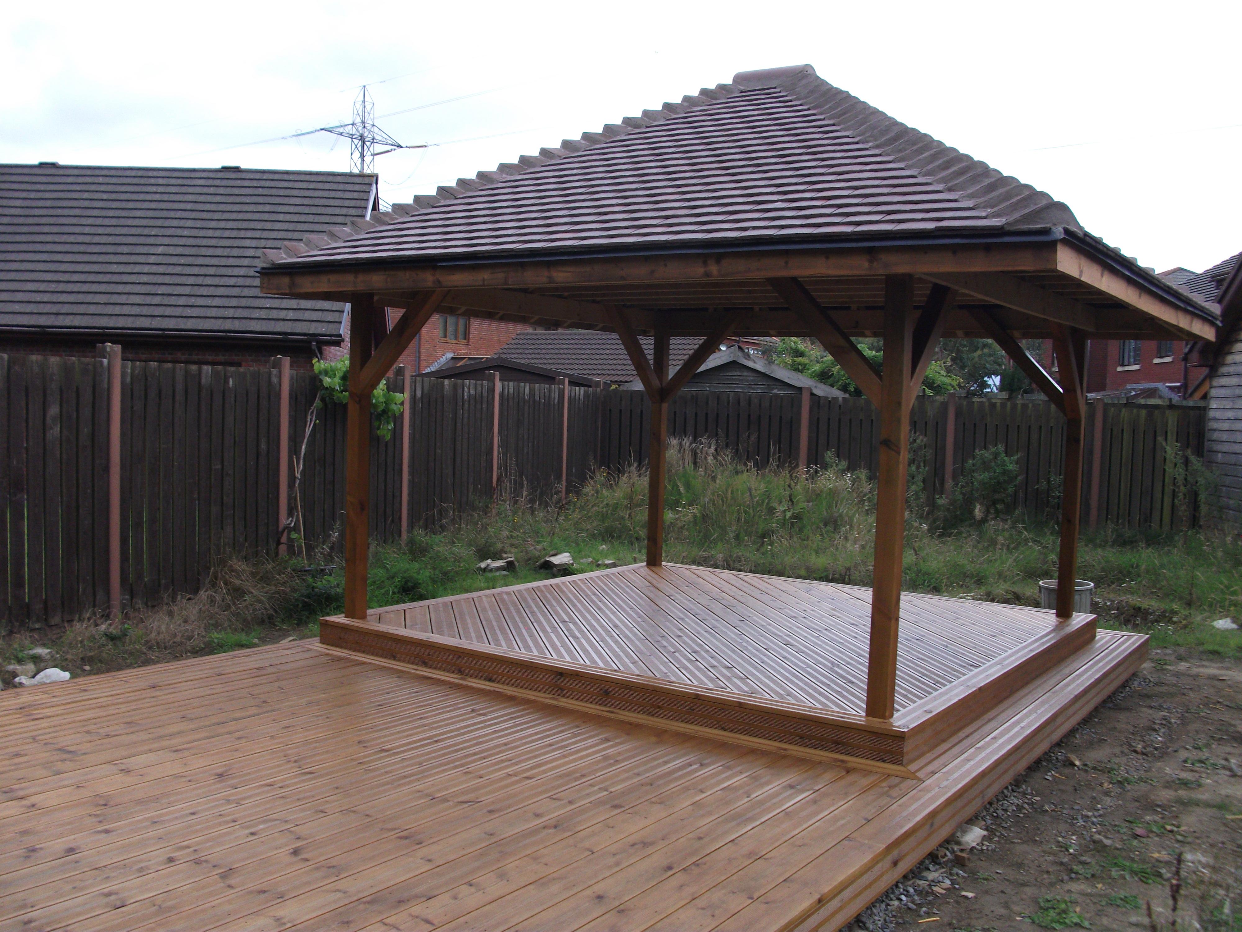

  9. Not an electrical question - seemed best sub-forum to use. I have a Hot-Tub being installed in an outside structure - roofed over decking. I want to cover the inner 'ceiling' with something decorative - currently, it's just joists & rafter of the pitched roof. (pic for context) It would be nice to have some moisture-resistant board with a 'star' like LED array ... maybe changing colour, or just twinkling. Something like this :https://www.stellarlighting.co.uk/inspiration/hot-tub-star-ceiling Has anybody done this or suggestions?
  10. My investigations have shown 3 options (options worth considering) Veissmann Vitodens 100-W in 30kW .. has advantage of excellent build quality and a full stainless steel INOX heat exchanger. Intergas HRE 30 OV in 30kW ... while not stainless heat exchanger it is copper, disadvantage, no GasSafe guy I have contacted has heard of them, no approved installers anywhere near me (75 miles) Worcester Greenstar 8000 Life 30kW .. expensive for a standard aluminium heat exchanger boiler, a lot of money for what it is. Positive is they give a full 10 year guarantee ... anything at all part & labour covered. Much better than warranty, My GasSafe guy used to be Veissmann approved installer, which would get me 10yr warranty .... if he can get 're-approved' then Veissman may be the choice. If not then the Worcester.
  11. Thermal store contents is circulated around boiler. The DHW circuit and UFH both have own transfer coils/heat exchanger
  12. No Thermal store (and hence primaries )is pressurised (1 bar). Agree as per OP .... its a HEAT only boiler I want.
  13. The Thermal store is connected to boiler .... everything else come off Thermal store. Pic may help
  14. The original design for my build included 'Comfort Cooling. While not full AC, the unit was supposed to lower incoming air temp by 5-10 degrees, therefore making house more comfortable in hot weather. The unit never materialised with the MHRV supplier. Has anybody added 'Cooling' to their MHRV install ?
  15. I just need a HEAT only boiler to connect the primaries to thermal store - no other connection to boiler side.
