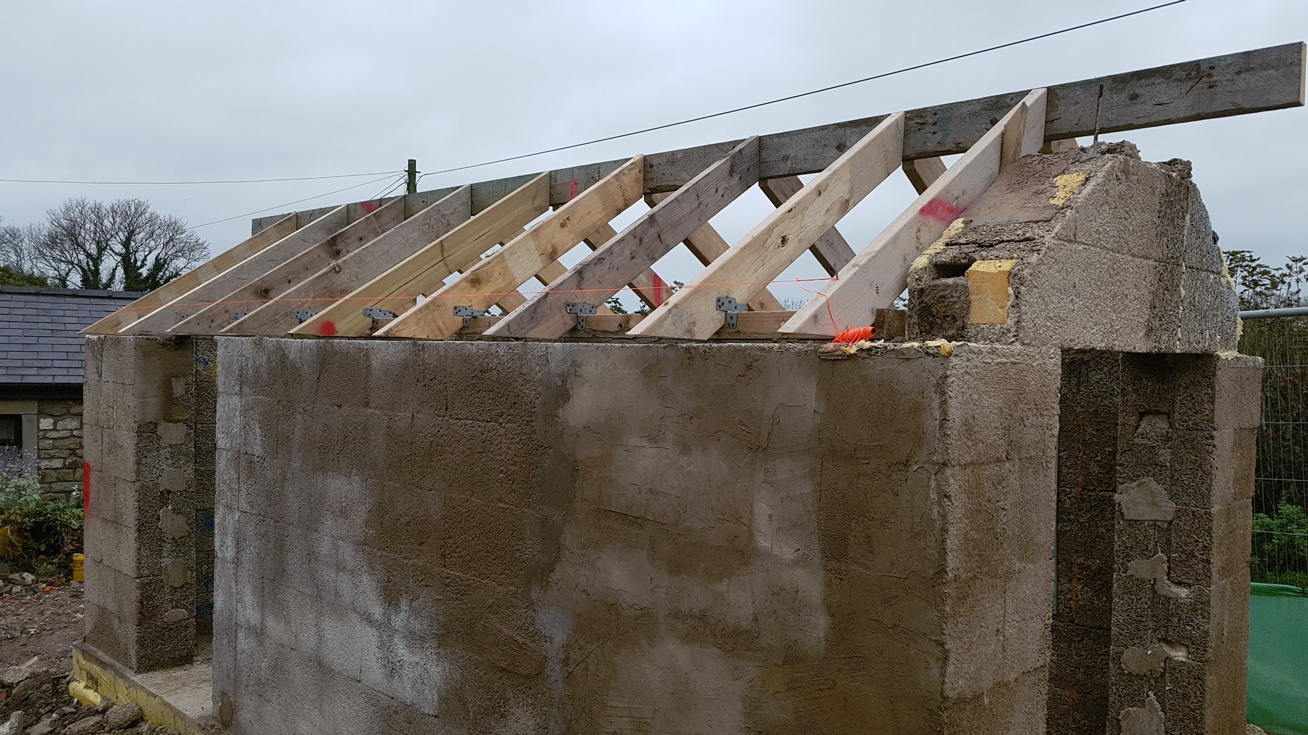

ToughButterCup Posted October 31, 2017 Share Posted October 31, 2017 Hmm... Shouldn't be too hard, the roof is a small, simple one - for the piggery. Pics to follow. Link to comment Share on other sites More sharing options...

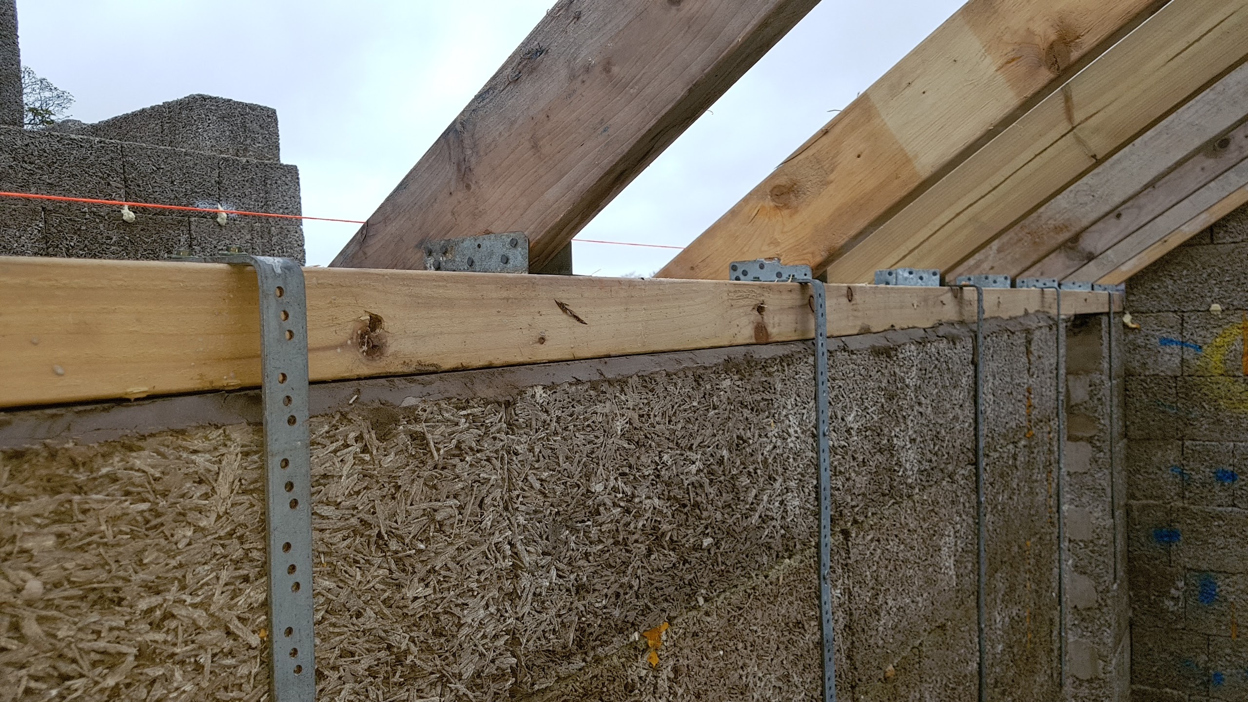

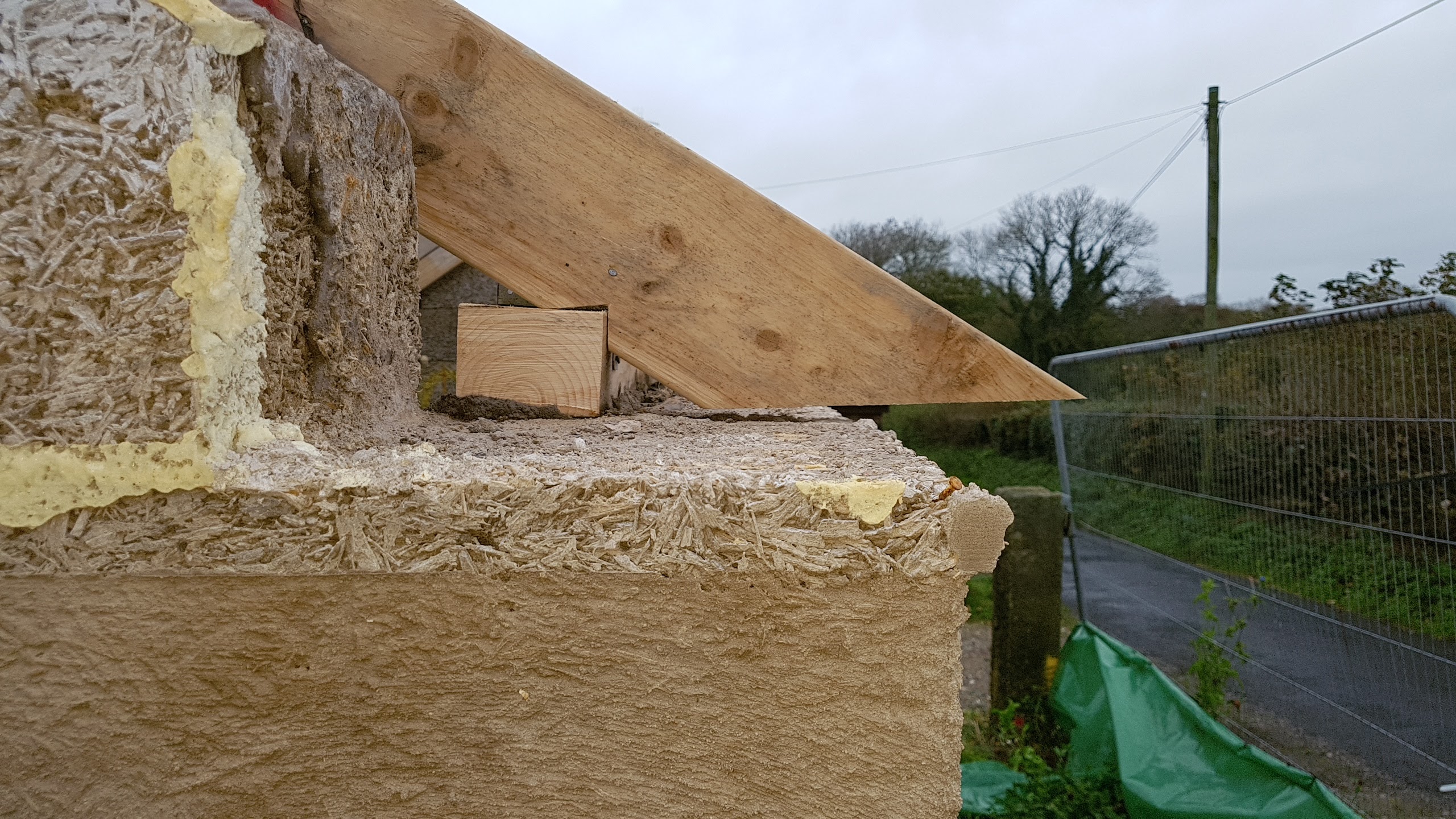

ToughButterCup Posted October 31, 2017 Share Posted October 31, 2017 I made this bit of roof out of bits of timber that were lying around on site - the ridge was in an old shed we had to knock down to make way for the house...so it's at least 30 years old. Wall straps put in yesterday Pleased I thought to make a space for a soffit so that I can disguise the banana shaped front wall So, it's a few hours on YT -again- so I can work out the batten positions. I think I have enough spare discarded 4 by 2 to cut up and make my own battens. Anyone got a link to decent online roofing (as in DIY your own roof)? Ian 1 Link to comment Share on other sites More sharing options...
