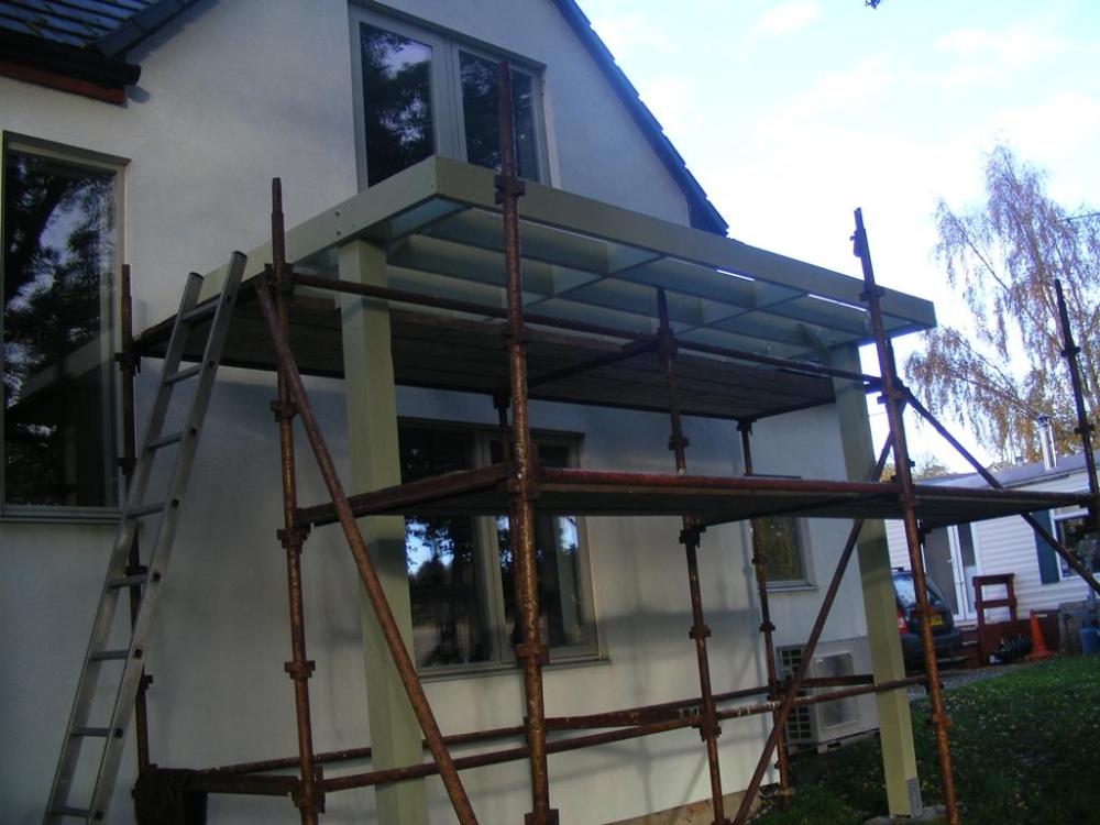

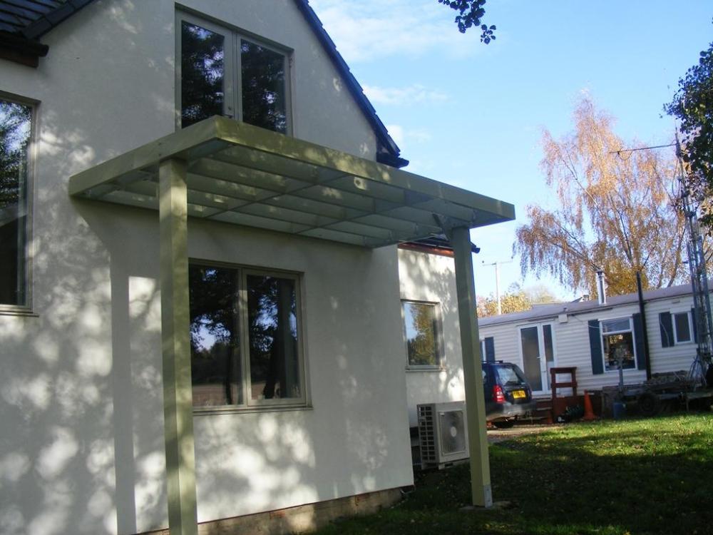

ProDave Posted October 29, 2022 Author Share Posted October 29, 2022 9 minutes ago, Radian said: Looking good! Are the little diagonal braces at the top of the posts really necessary with the deck bolted to the wall? (sorry if this has been asked before) Probably not, but it just looked like something was missing without them. Link to comment Share on other sites More sharing options...

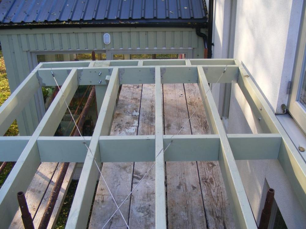

ProDave Posted April 6, 2023 Author Share Posted April 6, 2023 So I put the balcony project to bed for the winter, while I pondered what to do about deck material, handrail, banister etc. I had pondered what to do about the floor (deck) material and in the end decided on standard decking planks. They have been ordered from Jewsons, delivery in a week. Since our local branch closed last year, we have to order from the Inverness branch, and tomorrows wagon trip up this way was full so next Friday was the soonest they could deliver. I could go and collect but I don't want to. No rush. Since the failure of the decking pant experiment, these will be left plain wood colour, contrasting with the frame, and will get painted with a coat or 2 of "clear decking sealant" (lets see if that works) Now I would like the area under the deck to be reasonably water tight. Not water tight like a roof of a building, but to minimise rainwater getting onto the deck frame, and we would like to use the space under the balcony for winter storage of garden furniture, to keep the worst of the rain off it. That is why I was pondering alternative solid boards to use. The current idea is standard deck planks, but run a bead of clear waterproof sealant along the joining edge to seal the gap between adjacent planks. It will never be totally watertight, but can anyone suggest why not? I discussed before we will be using "yacht rigging wire" as the banister. I bought the one I previously linked to from Amazon. It looks okay, and is easy to crimp the ends on with a hydraulic crimping tool so should make a neat job. You can tell the nicer weather is enticing me to get "back to work on the house" Link to comment Share on other sites More sharing options...
saveasteading Posted April 6, 2023 Share Posted April 6, 2023 5 minutes ago, ProDave said: The current idea is standard deck planks For some reason I get lots of ads for a membrane underlay for decking. It is hung loose between joists so that it acts as a channel and spouts the water out at the front, or side. Any fabric would do, but having Proctor visible all over it might be an issue. I guess if you hang it looser at the outlet end it will have a slope. Link to comment Share on other sites More sharing options...
ProDave Posted April 6, 2023 Author Share Posted April 6, 2023 7 minutes ago, saveasteading said: For some reason I get lots of ads for a membrane underlay for decking. It is hung loose between joists so that it acts as a channel and spouts the water out at the front, or side. Any fabric would do, but having Proctor visible all over it might be an issue. I guess if you hang it looser at the outlet end it will have a slope. If you look back the the photos of the deck frame, all sides have a solid edge, so a drooping membrane would just serve as a bucket to collect stagnant smelly water with no means of escape. Link to comment Share on other sites More sharing options...
saveasteading Posted April 6, 2023 Share Posted April 6, 2023 1 minute ago, ProDave said: with no means of escape Best not do that then. But it would stop dripping onto the garden chairs, if you could tolerate a cascade at the perimeter. The ads didn't mention cleaning or the potential buildup of wildlife, tho I expect you could hose occasionally. Link to comment Share on other sites More sharing options...
ProDave Posted April 6, 2023 Author Share Posted April 6, 2023 So what if anything is wrong with my idea of a bead of clear sealant in each deck board joint? It would stop most water getting through and still allow a bit of movement. Unless someone tells me why not, that is my plan. Link to comment Share on other sites More sharing options...
saveasteading Posted April 6, 2023 Share Posted April 6, 2023 11 minutes ago, ProDave said: Unless someone tells me why not, Won't the water just sit there, sometimes freeze and the wood rot? Link to comment Share on other sites More sharing options...
ProDave Posted April 6, 2023 Author Share Posted April 6, 2023 No different to water sitting in any of the other grooves in a deck board. The whole frame is set with a slight fall away from the house to try and prevent that. Link to comment Share on other sites More sharing options...
