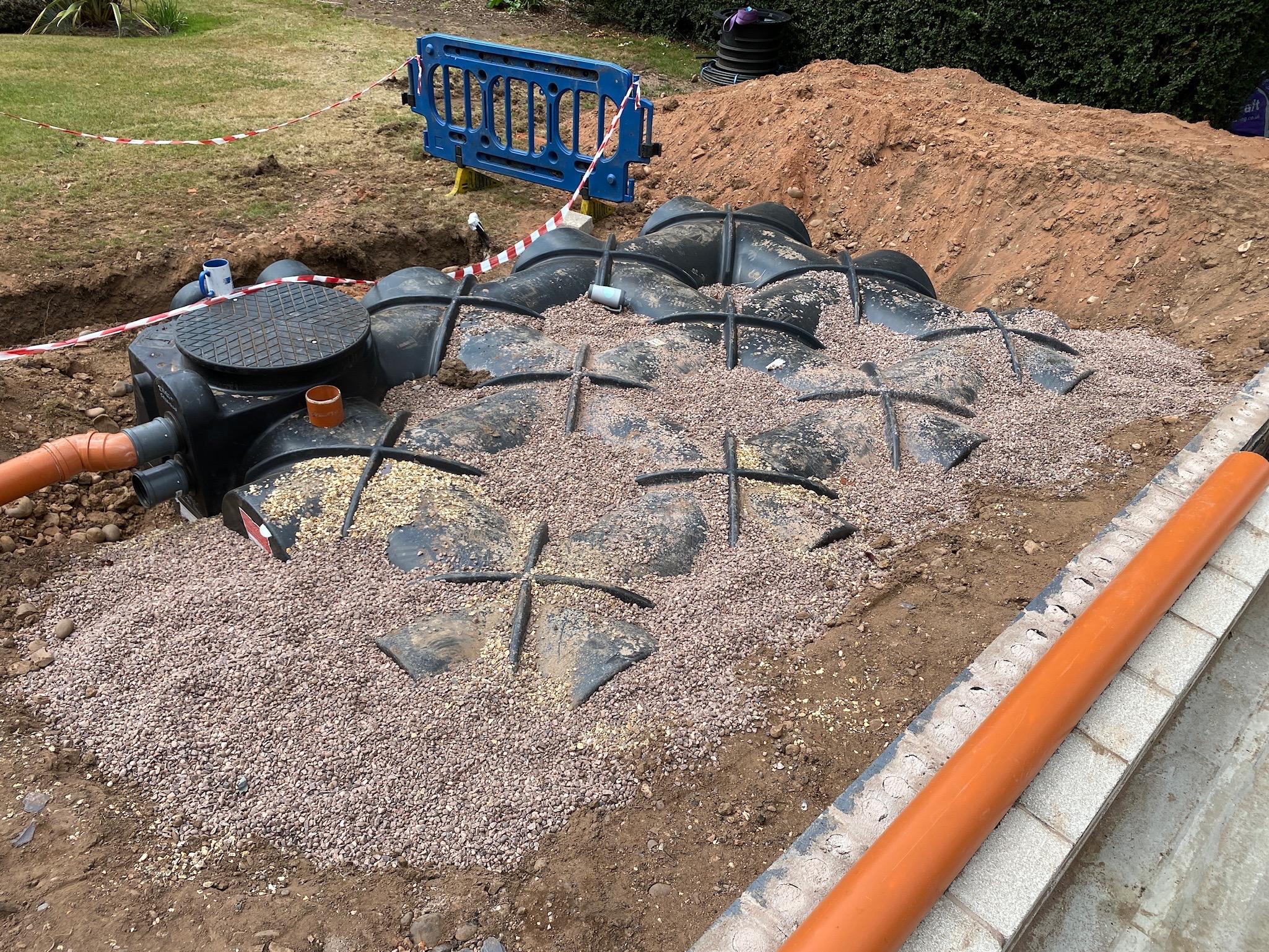

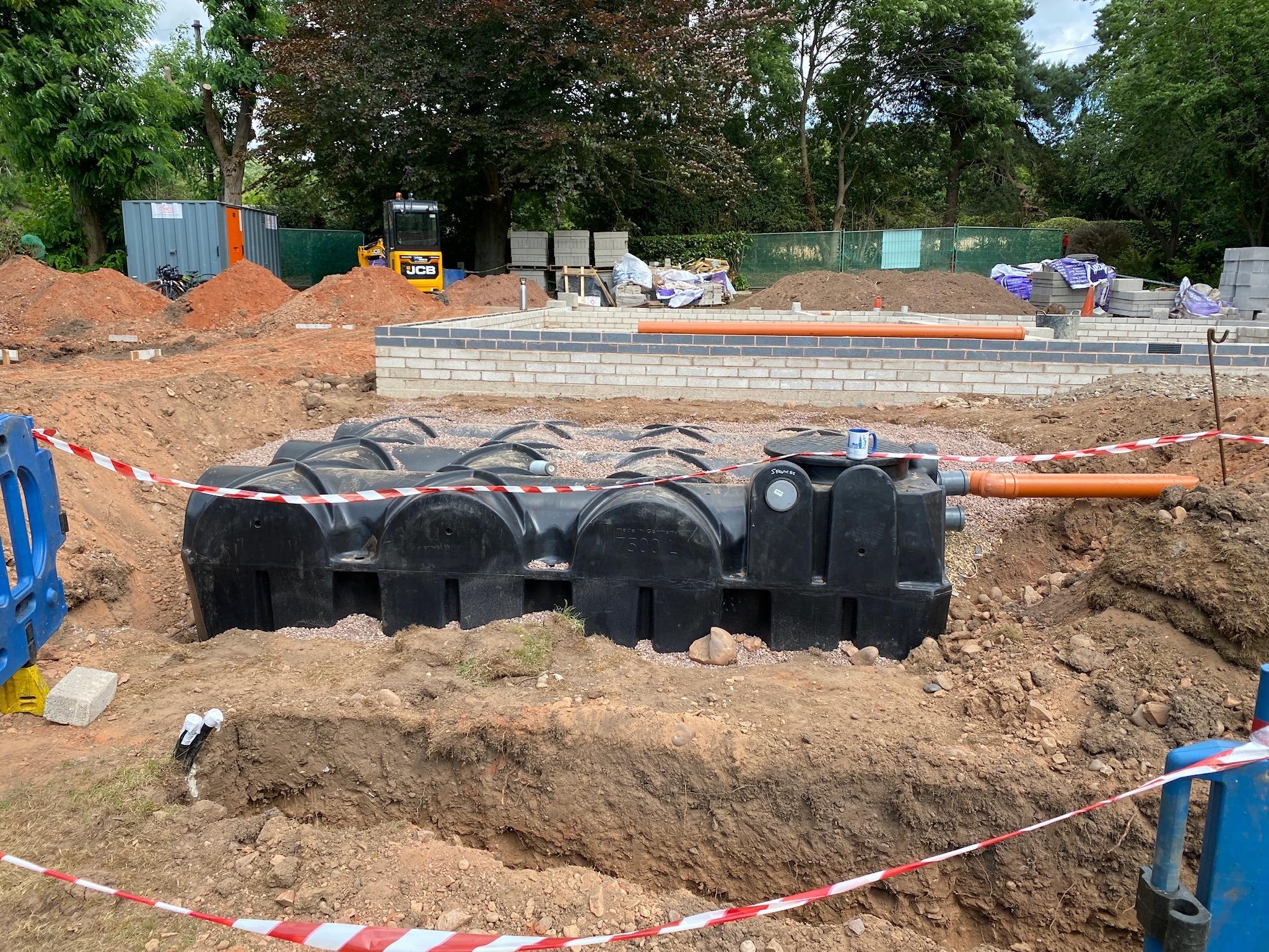

CADjockey Posted September 2, 2022 Share Posted September 2, 2022 Just installed a 7500L tank for toilet flushing, washing machine and watering the garden. Calculations tell me that our usage could be ~71kL and the capture could be ~62kL. Currently not on a water meter, but should significantly reduce our fresh water requirement, and thgeoretically provide 38 days of drought resistance. Link to comment Share on other sites More sharing options...
