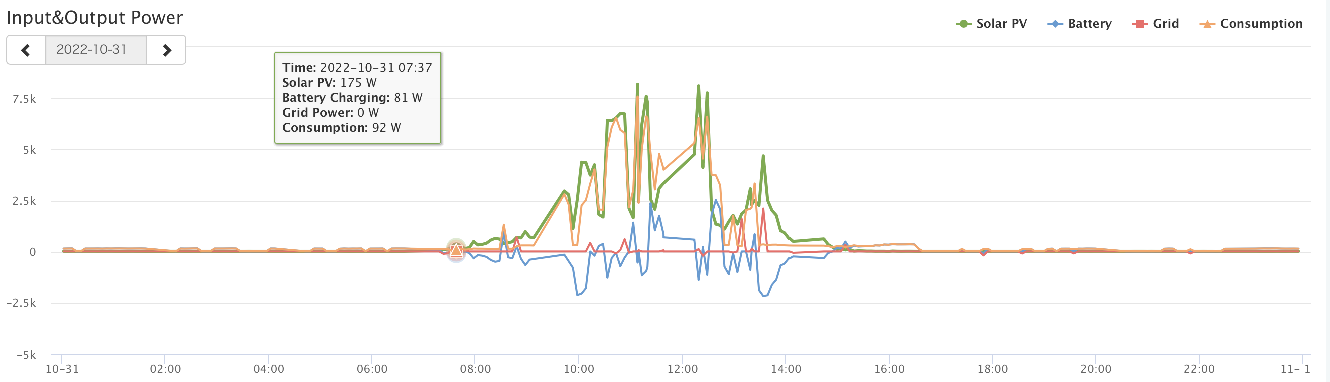

Thorfun Posted November 1, 2022 Share Posted November 1, 2022 Hi @NSS. Glad the Zappi is working out well for you. I've recently purchased an EV charger having used a 3-pin plug for the last 3 years! I wanted something that worked with my solar PV and batteries and, obviously, the Zappi was near the top of the list. But.... ...I decided to go with a Hypervolt charger in the end. not as intelligent as the Zappi for solar/battery but it was quite a bit cheaper! since having it installed by my sparky I have mostly used it to charge from solar PV in what Hypervolt (HV) call their super-eco mode in which is requires a minimum of 1.4kW being produced to charge. I have noticed that in this mode it will also sometimes discharge from the battery to charge. I think the logic is that if the house is exporting to the grid then the HV will ramp up the charge to the car. I guess then that if the solar PV generation drops maybe the battery kicks in to cover the shortfall quicker than the HV reduces the charge rate. I'm not really sure but it seems to work! The reporting side of things is poor in comparison to the Zappi but from my battery usage data I can see that it's working. when you consider that there's hardly anything running in the house at the moment, just site lights mostly and so any consumption in the graph below is the car charging. you can see that the battery definitely discharges to help out with the charge and when the car doesn't need power (or there isn't enough power being generated) the car stops charging and the generated electricity goes back in to the batteries. what this basically means is that for the last month since I installed the HV I have been running the EV for free. 🙂 According to the HV app the amount of energy it has put in to the car during October would've cost me £133.06. I think that's a pretty darn good saving in a month. 1 Link to comment Share on other sites More sharing options...

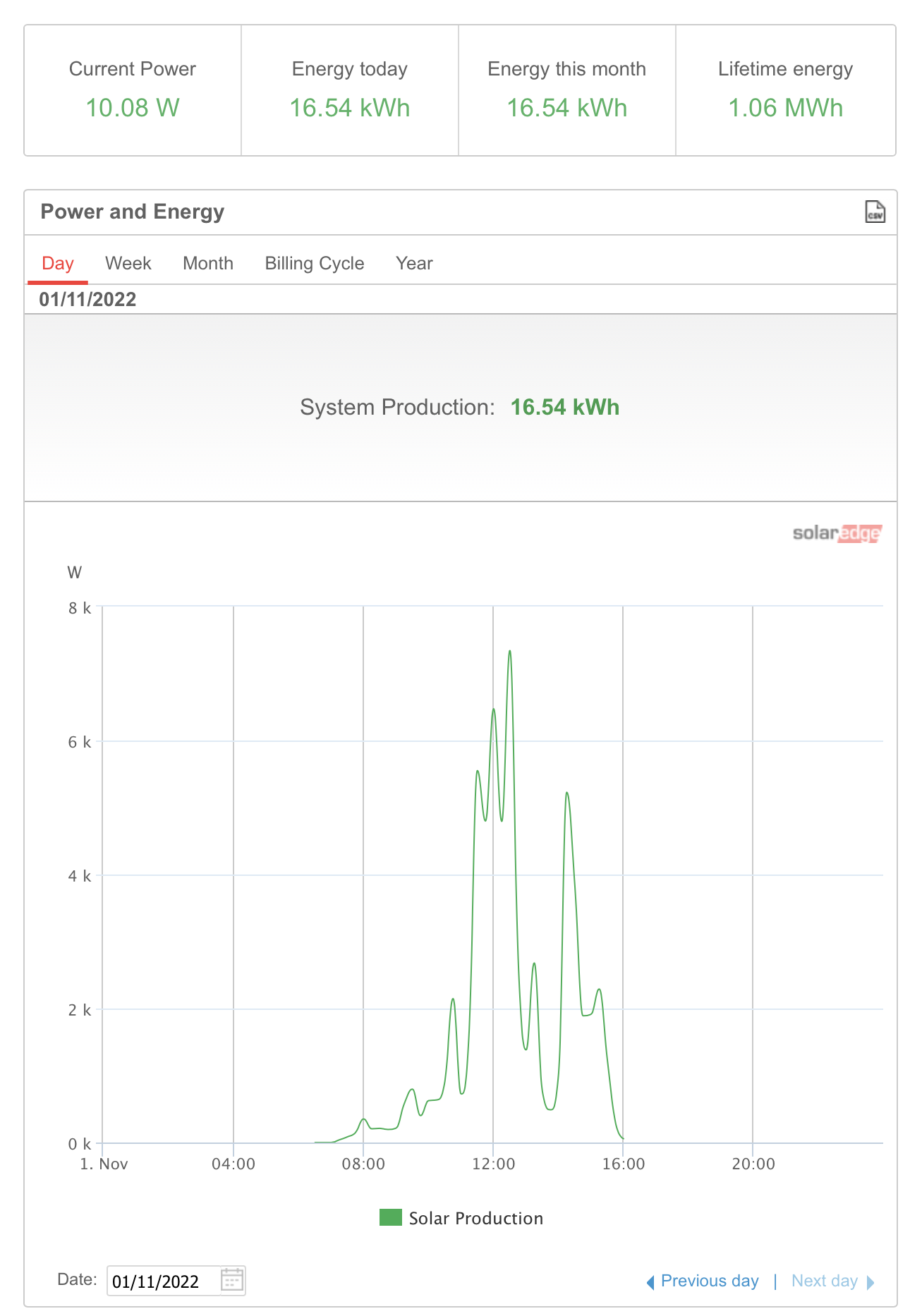

Thorfun Posted November 1, 2022 Share Posted November 1, 2022 2 hours ago, NSS said: Very good. The eco+ mode on the Zappi requires 1.4kW surplus and we rarely generate that much at this time of year so just dump any excess into the Power Diverter. It will perhaps be different when there's more sun, but the current Go rate, the fact that we utilise so much of our PV already, and the relatively low mileage we use the Mini for, means battery storage is probably not for us (at least not until V2H becomes a possibility). I guess that's a benefit of having a 10.5kWp array! even at this time of year with the storm we had today we generated 16.54kWh. 🙂 also helps that we haven't finished the house yet so pretty much all we generate goes in to the car or battery before exporting. I'm sure once we're in the car won't get as much love. 2 Link to comment Share on other sites More sharing options...
NSS Posted November 1, 2022 Author Share Posted November 1, 2022 52 minutes ago, Thorfun said: I guess that's a benefit of having a 10.5kWp array! even at this time of year with the storm we had today we generated 16.54kWh. 🙂 also helps that we haven't finished the house yet so pretty much all we generate goes in to the car or battery before exporting. I'm sure once we're in the car won't get as much love. A measly 3.6kWh for us today. We'd have been better off with nano-hydro generators in the rainwater downpipes! 1 1 Link to comment Share on other sites More sharing options...

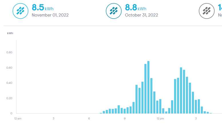

jack Posted November 2, 2022 Share Posted November 2, 2022 17 hours ago, NSS said: A measly 3.6kWh for us today. We'd have been better off with nano-hydro generators in the rainwater downpipes! 8.5 kWh for us yesterday, from an 8.5 kW array. Can you spot when the storm came through? 3 Link to comment Share on other sites More sharing options...
