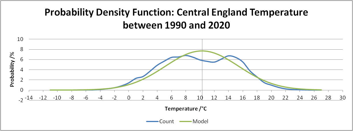

SteamyTea Posted August 16, 2022 Share Posted August 16, 2022 3 hours ago, JohnMo said: Main things you need to know are the highest heat loss, coldest day and least solar gain, then you can size your heating system. For this you need whole house heat loss and room by room heat loss. Then you need to know the heat loss on say a 10-12 degree day to get a heating curve, from this you can look at modulation rates of the heat source and define requirements for buffers etc. Use that in conjunction with a local heat probability density function. Link to comment Share on other sites More sharing options...
Alan Ambrose Posted August 16, 2022 Author Share Posted August 16, 2022 Ah I do like a PDF And I also came across TR69 or something and heathost? Alan Link to comment Share on other sites More sharing options...
