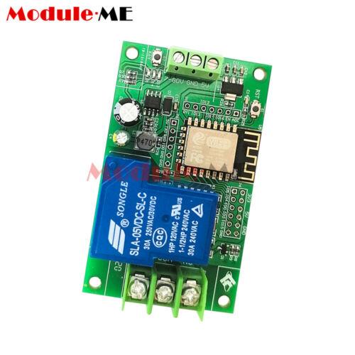

Radian Posted August 22, 2022 Share Posted August 22, 2022 1 hour ago, MrMagic said: @SteamyTea Not an answer to your exact question - I use a cheap sonoff to switch a contactor on my storage heater - all "off the shelf", in a little 2 way DIN rail enclosure. Yes, and @SteamyTea the sonoff products are typically (if not exclusively) based on ESP8266 so you have the choice of taking them as they come, or reflashing with one of the various open-source firmwares or rolling your own using micropython, arduino or whatever. The contactor bumps up the switching capacity as in MrMagic's case. OR you could get a high current relay board + ESP8266 like this one on Ebay Just needs a 9V or 12V DC PSU Link to comment Share on other sites More sharing options...
MikeSharp01 Posted August 22, 2022 Share Posted August 22, 2022 22 minutes ago, Radian said: OR you could get a high current relay board + ESP8266 like this one on Ebay How do they may them so cheap? Wonder if that 3OA relay really is? Link to comment Share on other sites More sharing options...

Radian Posted August 22, 2022 Share Posted August 22, 2022 4 hours ago, MikeSharp01 said: How do they may them so cheap? Wonder if that 3OA relay really is? Course it's not but it may live to a ripe old age at 13A. Unlike many chinese 16A relays. The relay looks like it might have the Zettler footprint so could possibly be swapped out for a pukka brand if needs be. Link to comment Share on other sites More sharing options...
