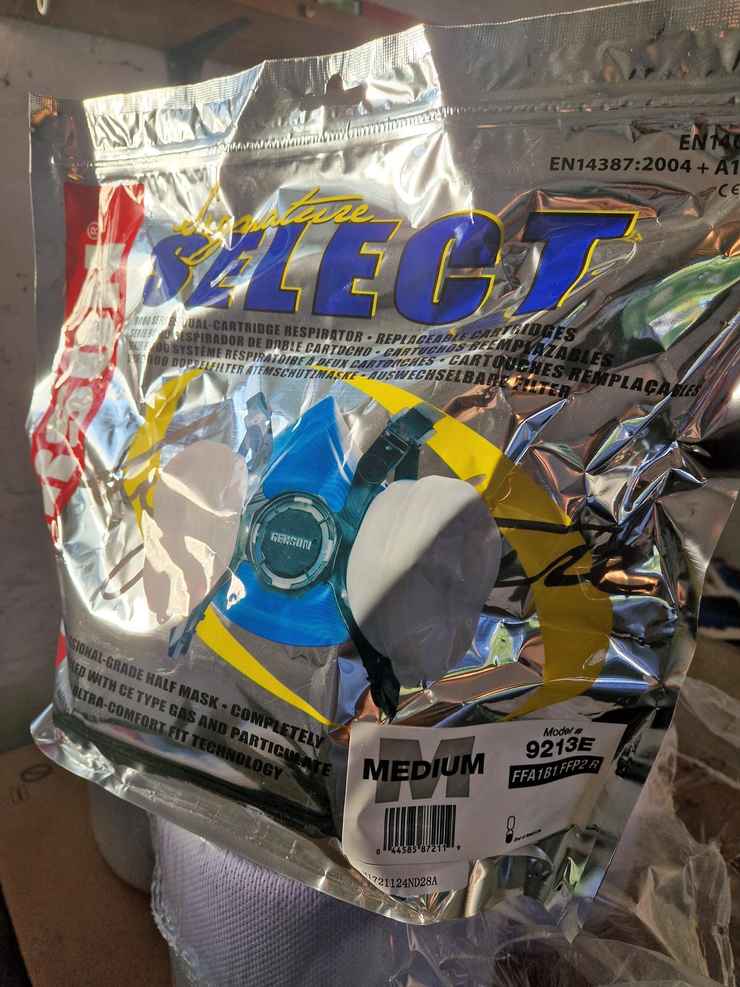

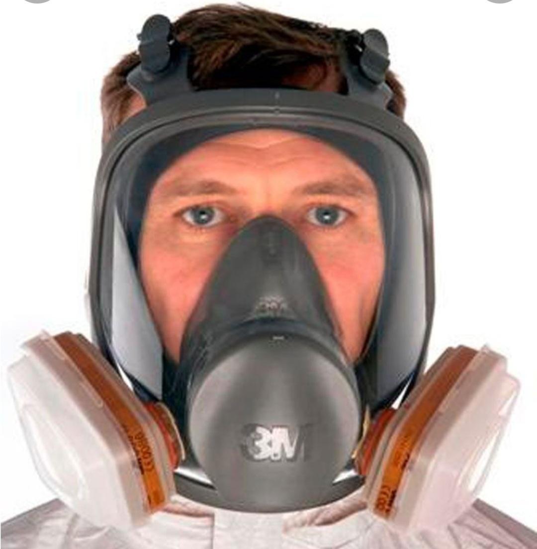

So is it OK to be used with this mask
IF loaded with the right filters yes - read my big post above.

25 minutes ago, Carrerahill said:
painting 2K you actually need higher protection believe it or not.
Would you recommend a model?
Off the top of my head I think the 3M 6057 will do organic gas & vapour - which is basically your petrochem based solvents and paints but also inorganic gas & vapour which I like to have because etch primers etc. can have inorganic chemicals in the makeup.
There are so many in the 3M range, make sure you add a dust filter on top of the cartridge, on the 3M 6057 I list above, you then get a little pad of filter material that click on top with a retention bezel, get the best filtration which is FFP3. You can change these more frequently but the cartridges are good for 12 months or when breathing feel laboured through them.
This setup is also good for doing MDF/PLY because it covers the dust but also any formaldehyde (or other resins) or off gassing from cutting the material.

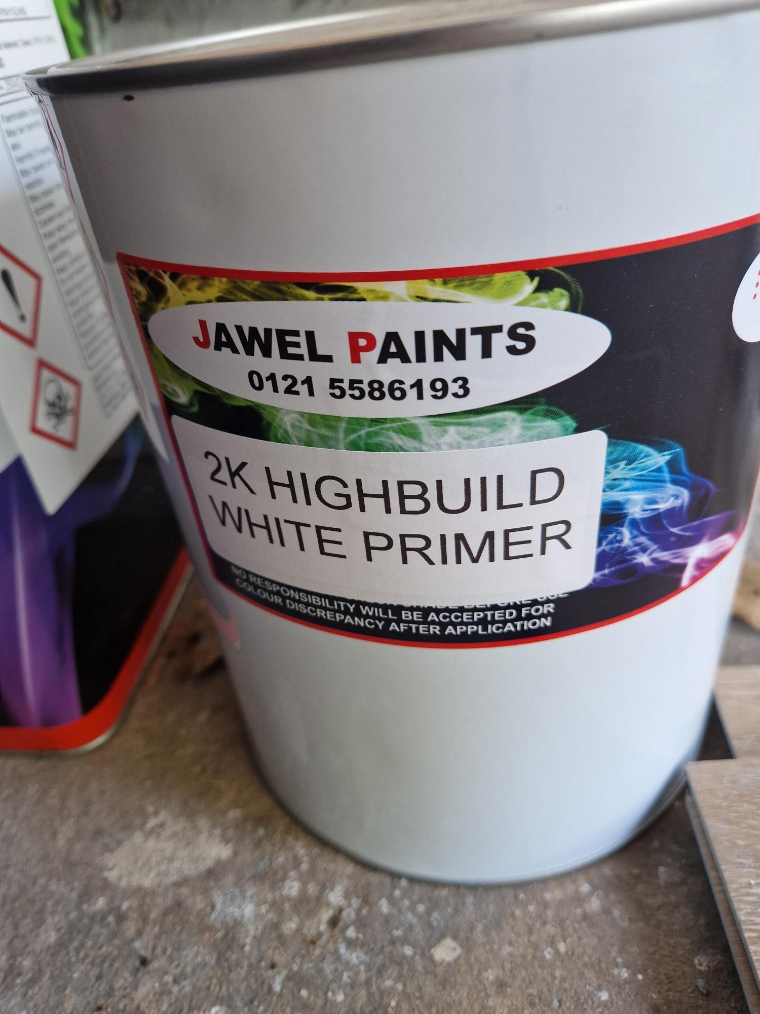

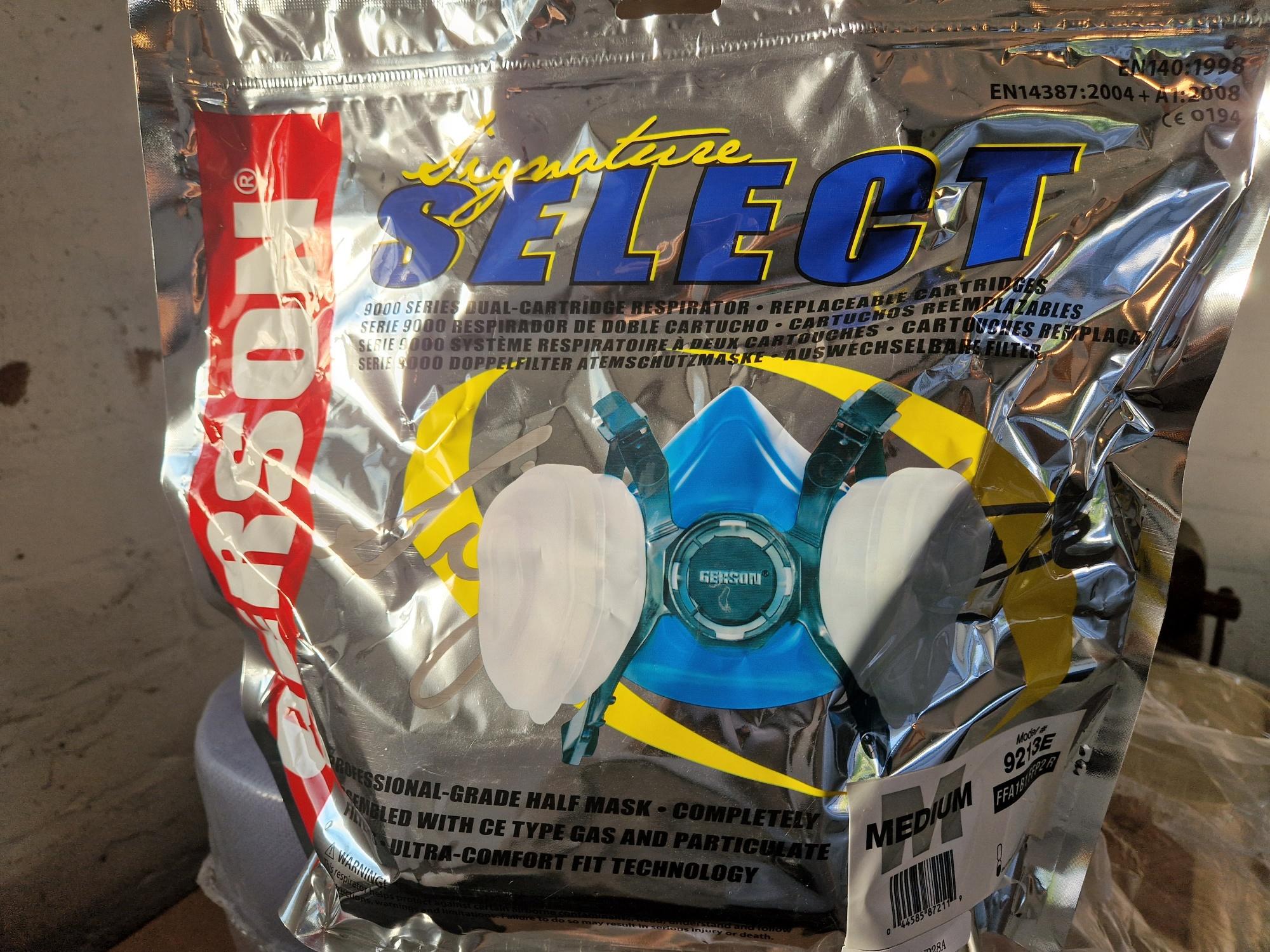

I have checked the mask I had bought and just this one. Is this any good?
The paint primers collection is also here. Any insight/comments would be welcome.

That mask looks reasonable enough, but I think those filter caps are just a dust filter, it would stop the paint particles but not the vapours and gases from the various solvents and chemicals in the paint. Check with the manufacturers datasheets and see what filter it is and what cartridges are available. If unopened and not suitable I’d keep it for general dusty work on your house, or flog on eBay and get a 3M full face mask as you should really protect your eyes too but not critical if you paint outside or in well ventilated areas – I used a ½ face 3M mask like that for years before I upgraded to the full face.
The paint looks fine, it will be good tough paint for sure, my only comment would be don’t use 2k primer going forward, you have it now, fine, just use it, but 1k primer is easier to use, you can literally just thin some, tip it in the gun in any quantity etc. no need to mix up properly. It also means you are reducing your exposure to isocyanide products. If clean you can also tip spare back into the can as it won’t harden in a sealed tin, catalysed 2K will begin to cure immediately.

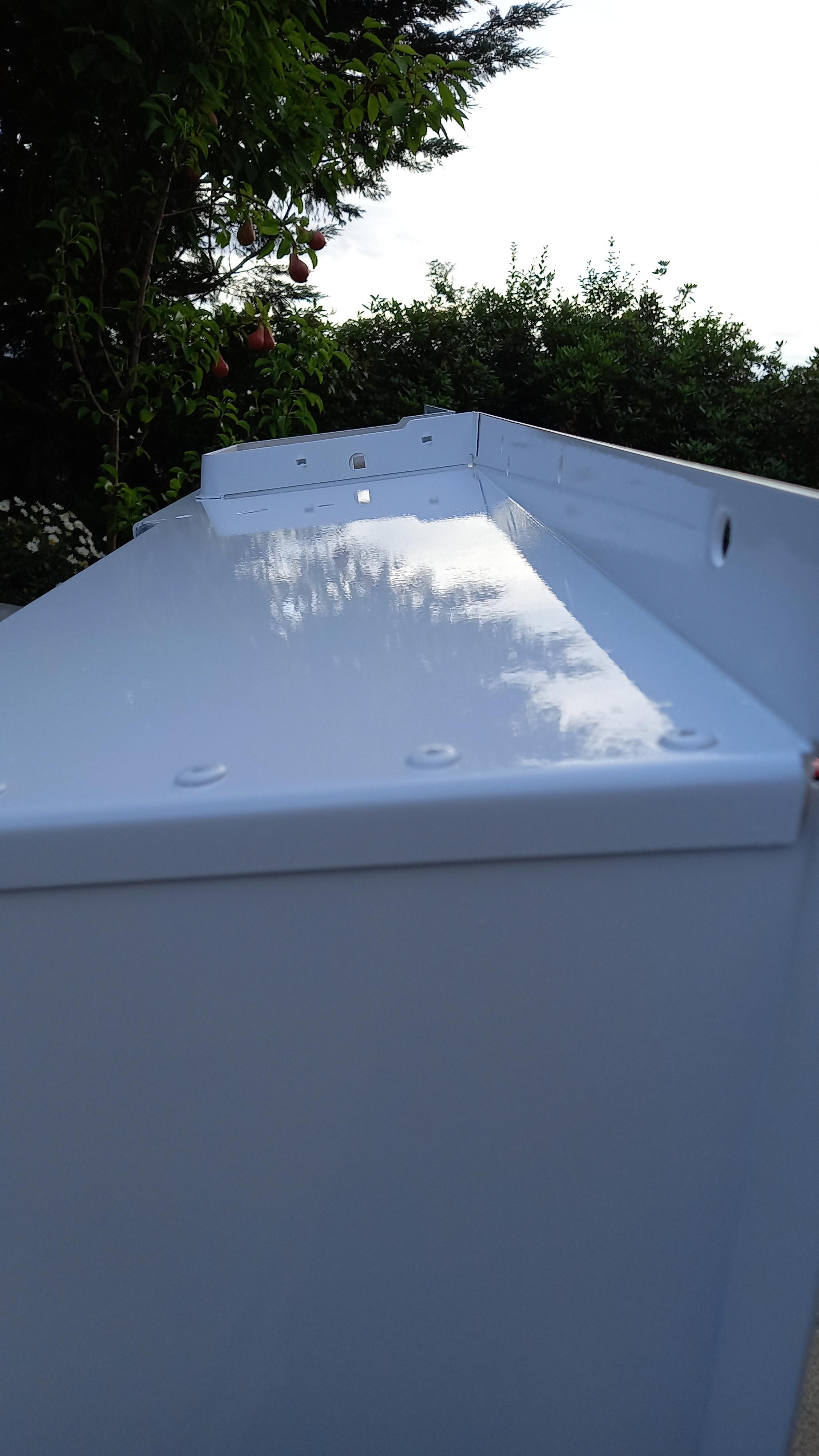

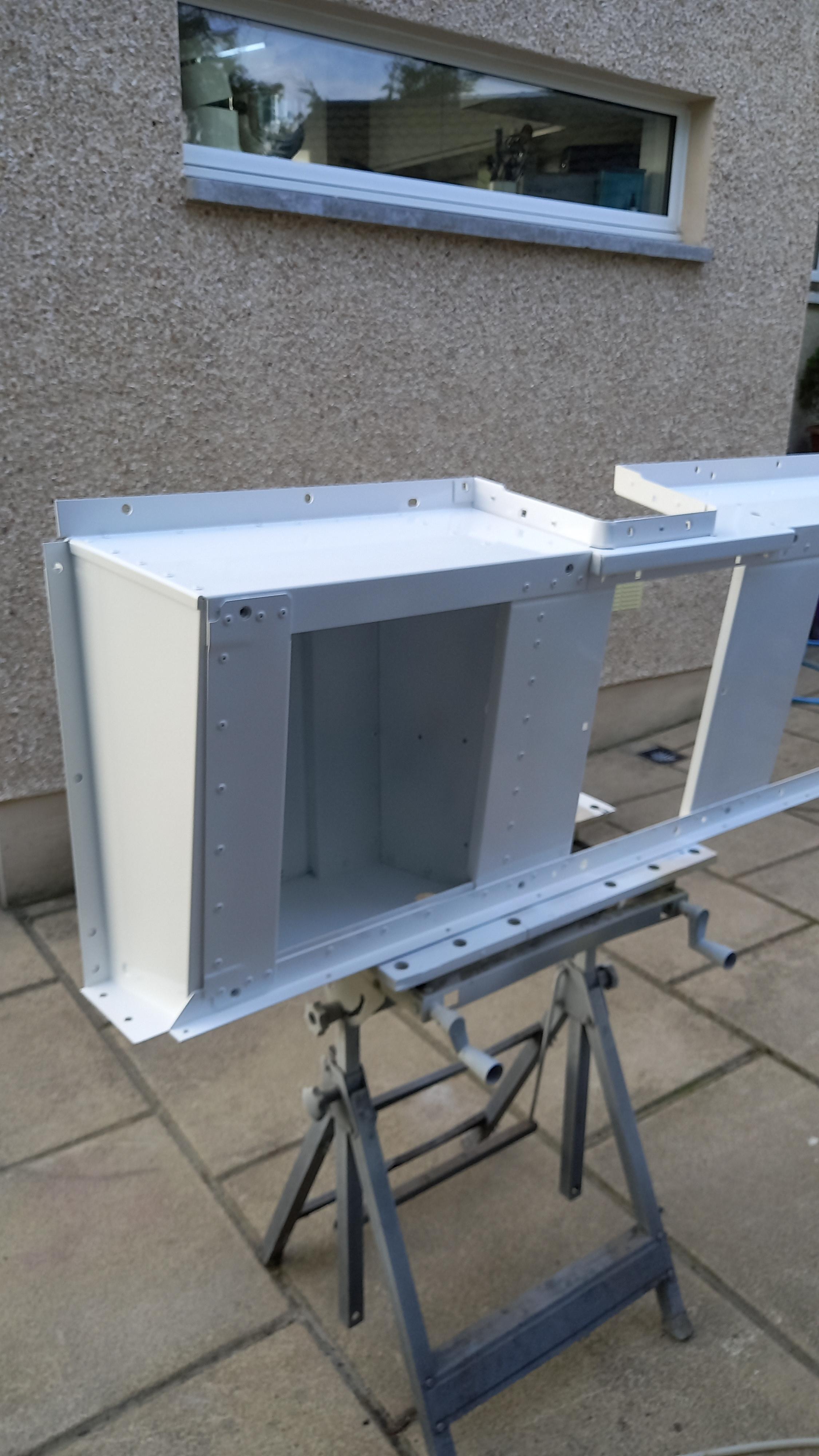

This was last night, perfect painting conditions, light breeze, warm evening, wife and son & dog out, bit of sun, I sprayed the patio with the hose before I started to dampen it, helps reduce dust, finish is about 98% perfect, I have 2 defects on "seen" parts, both tiny and once installed I don't think I could even find them again. If it was a bonnet or door or kitchen door, both of those defects would be resolved with localised 2400 grit paper, then some rubbing compound followed by finishing over the whole panel or a local fade depending on the result.
For that seatbox (from a Land Rover) it took about 120ml of paint, that included the battery box under the passenger side seat area, the last coat was 10% more thinner for a high gloss finish, also easy clean! I am very pleased, and if I had not been, I have more paint and a lots of sanding paper/discs in stock!

Look perfect. We'll done. Thanks for sharing the tips. I will surely need as many tips ss possible. Is it possible to paint door and cabinet without taking the doors off the hinges. The tiles will be repainted or retired and work top installed with née sink and taps. So no issue with spray mist going every where. Can the door be dried vertically?

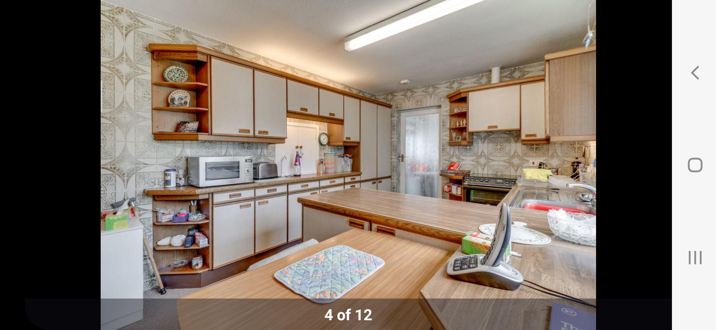

You can paint any object in any orientation, however, it does make it more difficult overall. Can you not unclip the hinges or just back off the two screws and take them somewhere you can work on them flat on a trestle?
Are you planning on painting the insides of the doors too? If yes I would lay them all out on their fronts, paint the backs with some primer and give them a coat, make that your test batch, if not perfect, you might be able to live with it.
Then after that backs have had 3 days to cure well, turn them over and do the fronts and sides keeping the gun pointing at a downward angle at all the times to stop paint hitting your newly finished backs.
If you really need to do them in situ, I would get some masking and mask off the cabinets themselves, mast the hinge up to the point it meets the door and using a scalpel or Stanley knife blade, cut round the hinge perfectly to get a nice finish. This way you can then open the door, spray round the back and sides and get it all in 1 go, but take longer between coats and reduce your thinner a bit as runs will be much more likely for a beginner painter. I personally, would not paint them in situ, I think you might be creating a fair bit of hassle for yourself, unless the hinges are so crusty you fear touching them.

I might buy the paint drying rack and work stand to help with the job.
Is the workstand (you have in the pic) above good in terms of holding items while you paint?
