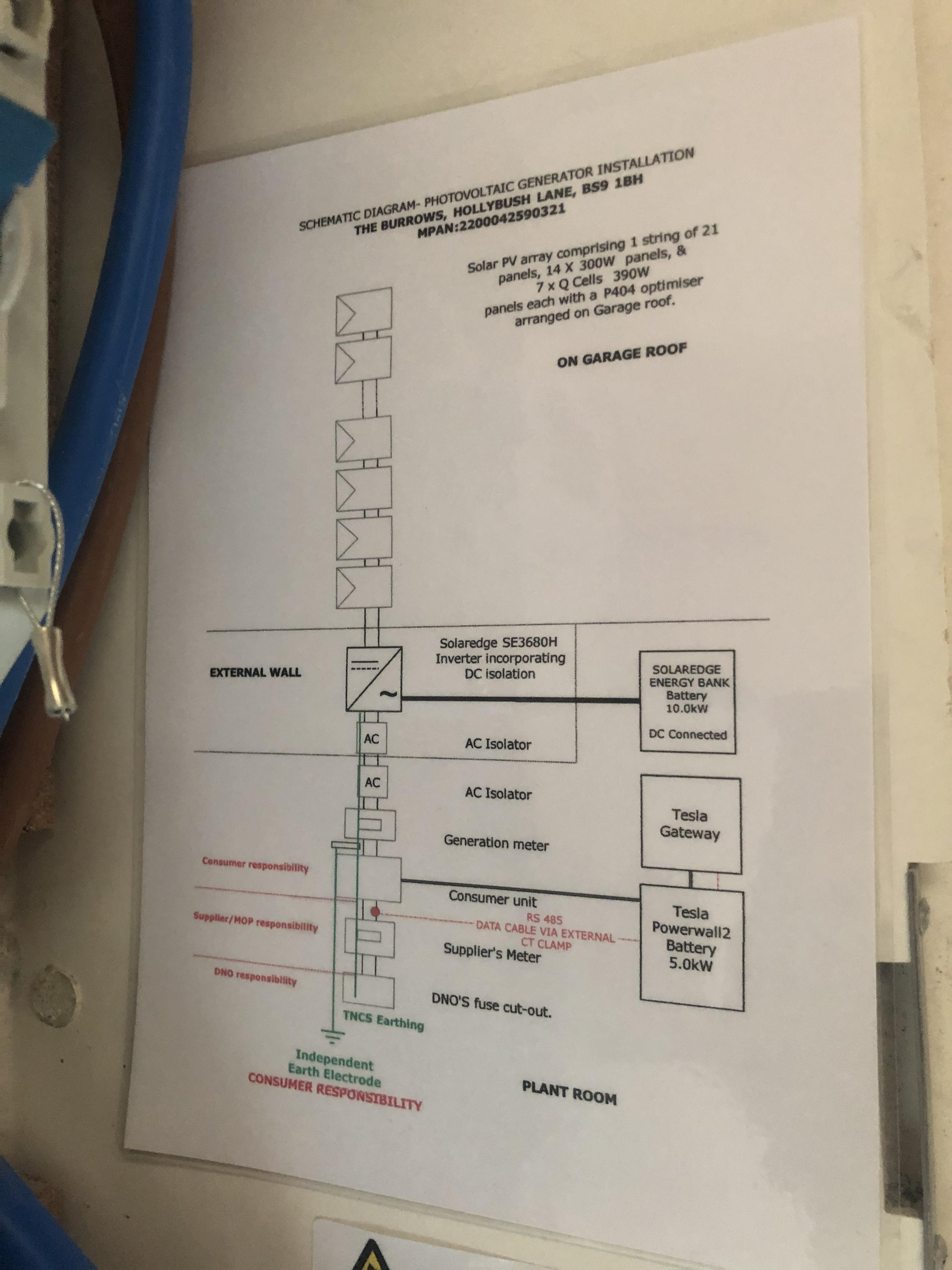

Dillsue Posted August 6, 2022 Share Posted August 6, 2022 20 hours ago, pocster said: Not sure how valid that schematic is as AFAIK if the Tesla gateway is used for power cut backup, it needs to be positioned between incoming supply and consumer unit so it can disconnect the house from the grid. Link to comment Share on other sites More sharing options...

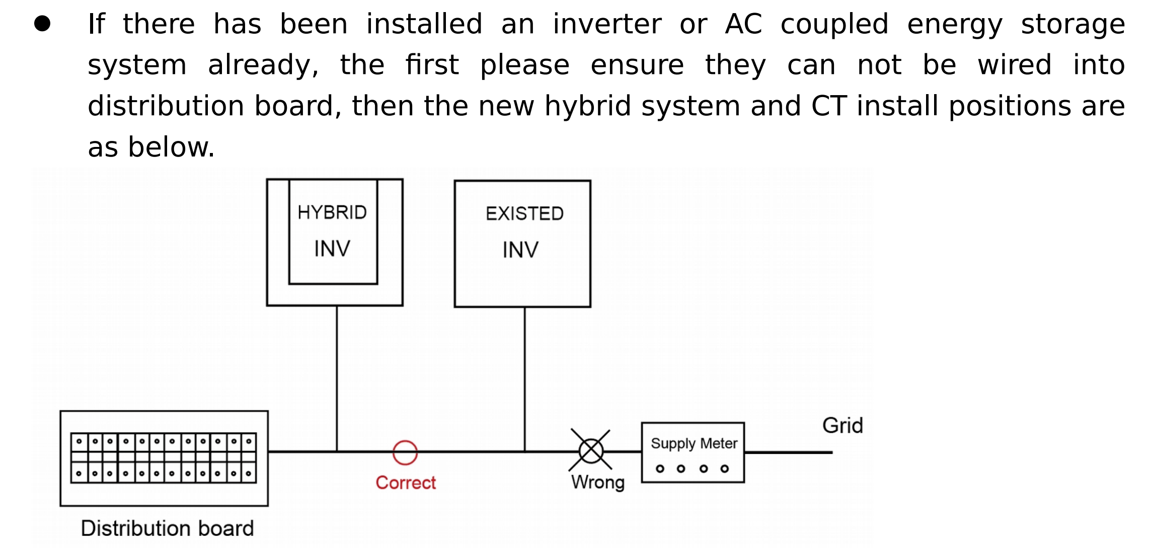

RobLe Posted August 23, 2022 Share Posted August 23, 2022 I was idly looking at Givenergy stuff, and saw the hybrid battery install guide for their current clamp: https://midsummerwholesale.co.uk/pdfs/giv-ct-manual.pdf The snip below is from it, which considers a pre-existing install of an inverter: as I suggested a month back....😁 1 Link to comment Share on other sites More sharing options...
