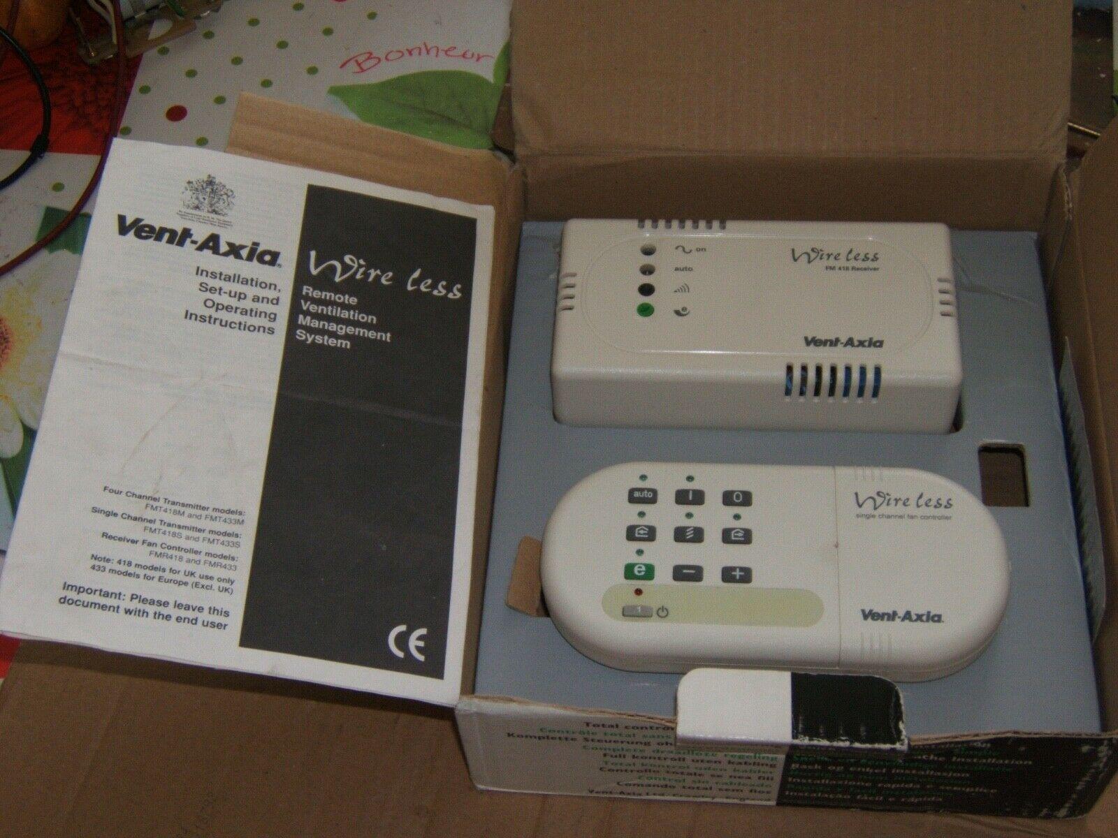

kommando Posted July 23, 2022 Share Posted July 23, 2022 1 minute ago, MikeSharp01 said: And presumably the lights on? No, the lights are separate for now as the room is hardly used during non daylight hours and is bright enough in daylight. As it is the fan gets over ridden and turned off a lot too using battery-powered remote switch in bathroom and control box upstairs. Link to comment Share on other sites More sharing options...
