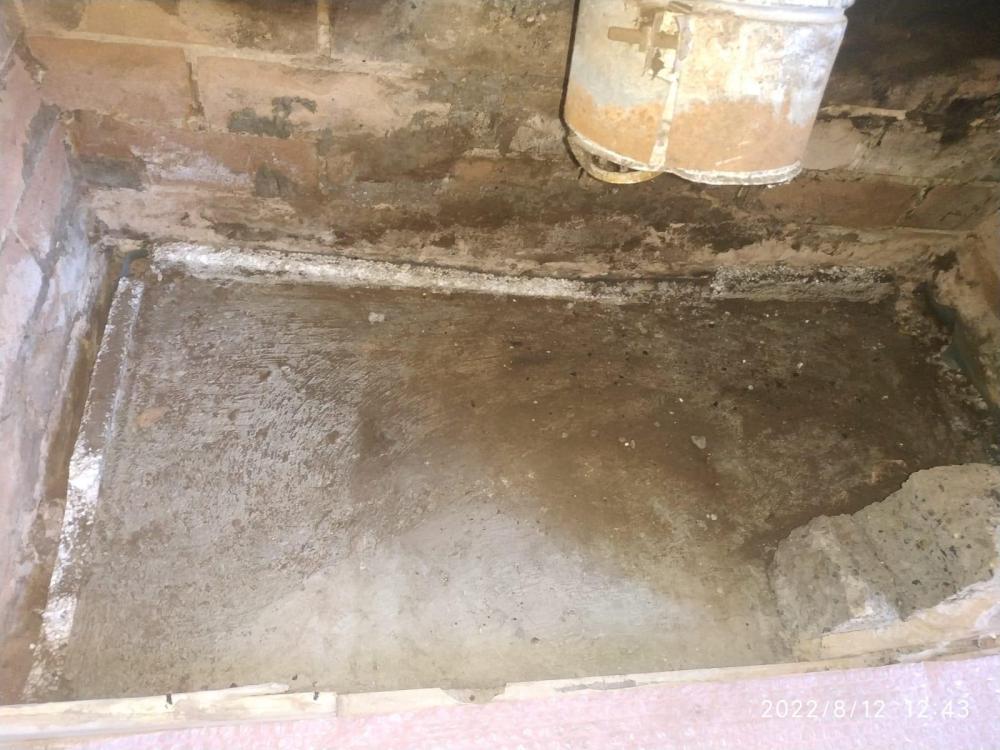

Think you install the liner and register plate at the bottom then fill the space around it with Vermiculite...
https://youtu.be/Kk6Et89GOCg
Are you saying the chimney has been removed in the loft so the bare liner would be exposed?

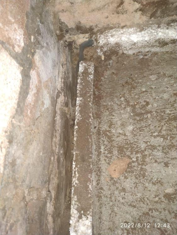

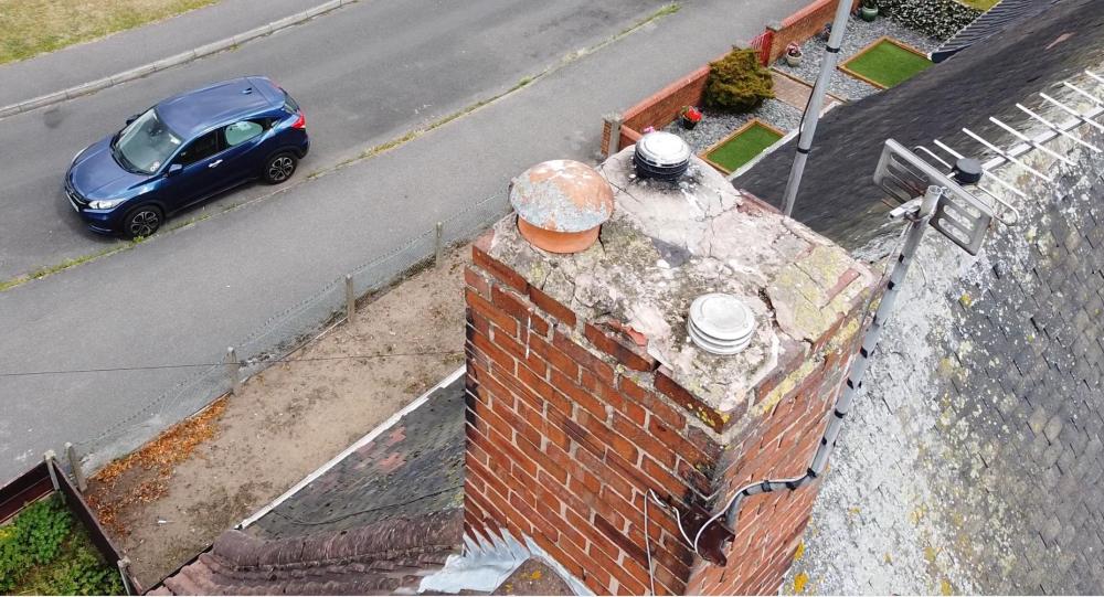

Ok I got the 904 Ultraflex fitted I cut off about 1m of it to fit the adaptor while I wiggled it it went down by about 40cm.
How do I know that it didn't disconnected from the top?
It's not a straight chimney but a bend or even two. I wasn't pulling it.
I am not going to cut another bit then to find out it disconnected and now it's too short. This 904 is quite stiff, hard to work with.
Tomorrow I am going to fly a drone next to the chimney pot to see if I can see anything.
