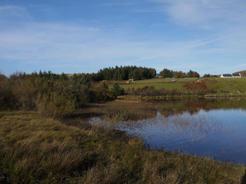

Galileo Posted July 17, 2022 Posted July 17, 2022 (edited) I had a moment four years ago and bought an 8 acre big plot, well, a croft, which currently has no access (boat count?) and I need a sanity check about my thinking. I'll set the scene first. I have an easement for an access road across a neighbours land whose been very helpful and has talked over options of old pathways to the ruined croft house and potential new ones. I've settled on a simple almost straight line down the 170 meter incline from the road using an existing field entrance following the boundary fence to my land where there is also an old entrance, then a turning and parking area. So far so good, the land type is scrub peat, but right by the coast so not too deep, maybe 700mm in one small area. I've PP in place for a 3m wide road, veg strip, textile and 250mm hardcore, joining the road will need to be bitmac dressed for the first 6m. I've had some quotes, £12k plus stone, and therein lies the problem, I only have access to one quarry and they are flat out with other work, plus, £12k plus guessing somewhere around £6k+ for stone (240 tonnes if I could ever get any) is a lot of money and a big proportion to the cost for the land for just access. I realise that's probably a laughable amount for some people, but I've limited funding and so have to work with a tight budget out of my salary. I thought about doing it myself, so spoke to a local haulers about stone delivery who thought I'd need a much bigger excavator than the 3t one or backhoe/loader I had in mind, and experience to pull something like this off, let alone a big issue with delivering to site along a single track road with nowhere to tip, saying their lorry would get bogged down without a solid base. Casual Sunday reading some old posts and I stumbled across someone mentioning that they used a borrow pit to provide the stone for a track on their build and that set me thinking I wonder if I could do the same, at least to get a drivable track in place that I could dress with better stone at a later date, we're talking very low frequency traffic here, not the A9. I'd still need someone to do the entrance as well, that would be a few too many tarmac drive repair buckets. That's a lot of text to get to the point of wondering what my success would be in identifying an area to dig for a stone, as a complete novice, what plant I would need, as a novice, and if I'm just dreaming and should just sell the land or save up like everyone else? I'm not completely useless, spent many years driving tractors around, general horticultural machinery, do my own vehicle maintenance etc. so feel that I might be able to learn enough to do basic stuff with a digger, slowly. This is nice writing it down, feels like therapy! Edit: I'm not sure what all those straight lines are, apart from the obvious fence lines, I'm assuming drainage but some are vertical which makes less sense, it's not very apparent on the ground at all, they pop out when viewed from above like this. Edited July 17, 2022 by Galileo 1

Galileo Posted July 17, 2022 Author Posted July 17, 2022 57 minutes ago, ProDave said: if you can find the stone it is very DIY able That is extremely heartening to hear! I have an idea on a suitable place, it's in-between the house ruin and what looks like a raised square in the top photo, the house area has been dug out of the hill and sits on a rocky shale type surface, so I think that's what might be under the peat. Temp, I have PP in place for the track, along the dotted line in the photo, the previous track routes were by foot only and to the croft house shown in the bottom photo, which was last lived in '82, roof and rear extension removed by the previous owners who wanted to renovate it but only got as far as demolition. I have not decided on a house location yet as I'm undecided on how to work the croft to get some income out of it, when I do, then there's a grant for that, and whilst PP is not guaranteed for a house, being a croft it is normally not an issue if sized correctly and fits in, no 6 bed mansion and more a 2-3 bed single story. The old croft house is a very small single story butt and ben; my neighbours say knock it down and rebuild, I'm a bit more sentimental, as after all it's been there over 200 years and part of the croft, minded to re-roof and use as a store, windows and the front door are still in place to keep the draught out, even if the roof is not.
Thedreamer Posted July 17, 2022 Posted July 17, 2022 It may have been my post about the borrow pit. The ideal rock for an access is called rotten rock. The rock can be removed by a bucket rather than a pecker. You can actually break the rock into pieces by hand and eventually it becomes a dust which is rock solid and water permeable. Our road has been in seven years and it has never had a single pot hole. I'm going to spread a thin layer of chips, later this year. On our croft, we extracted the rock from a raised area. We took a thousand tonnes out for our 120 meter access and for the site. The borrow pit was then infilled with clay and tree stumps. It's quickly regrew to the original condition. I asked our planning officer on the borrow pit and it was fine if it was returned to the original condition. If you don't have access to rock maybe a neighbour might let you take some for a price. Do consider utilities and foundation design as earlier as possible. More stuff at the first entry of my blog. 1
Galileo Posted July 17, 2022 Author Posted July 17, 2022 It wasn't, but that's going to be a good read, thank you. Geology around my croft is "Till and Morainic Deposits - Diamicton, sand and gravel", apparently. There is definitely a lot of very good gravel on the shoreline, not least an entire spit of it, but it's a marine protected area and not only that but a local English landowner dredged the bed and made off with a lot of gravel in the late 19th century upsetting the local fishermen, there's a bit of sensitivity around doing that! Not sure I'd be able to buy a big digger, certainly not in the 5-6t bracket, being in Shetland there isn't really a second hand market. Still, I'm feeling a lot more confident about all this now, I dithered about posting as well.

Hobbiniho Posted July 27, 2022 Posted July 27, 2022 first thing i would be doing is getting a "podger" a thin bit of round bar with a T bar handle on the top and finding out how deep the peat is, you will also be able to tell if what is under is hard or soft, i cant really tell from the photos what you own but if you own most of what is in the second photo those raised bits in the foreground will likely be old dry stone walls so would be suitable to be reused for road construction, without digging trial holes you wont really know if what you have underneath will be hard enough or if it has too much clay and will turn to soup, i presume you are in unst given the reference to 1 quarry and the spaceport
Galileo Posted July 30, 2022 Author Posted July 30, 2022 On 27/07/2022 at 18:29, Hobbiniho said: first thing i would be doing is getting a "podger" a thin bit of round bar with a T bar handle on the top and finding out how deep the peat is, you will also be able to tell if what is under is hard or soft, i cant really tell from the photos what you own but if you own most of what is in the second photo those raised bits in the foreground will likely be old dry stone walls so would be suitable to be reused for road construction, without digging trial holes you wont really know if what you have underneath will be hard enough or if it has too much clay and will turn to soup, i presume you are in unst given the reference to 1 quarry and the spaceport Ah, close! Top end of Yell, the water is Basta Voe looking out to the East. And you're right, bottom picture is mostly mine, top one neighbours land that I'm cutting across. I've done a poke around, seems to hit the hard at around 200mm at the thinnest, 700mm for a few meters at the deepest. Been looking at getting an old Backhoe digger, like a MF 50B or JCB 3CX to have a poke around before hiring a bigger excavator but logistics is not fun, without a trip down on the boat its taking a gamble and getting something sent up freight somehow. Doing things on a shoestring is not for the feint of heart. There is a drop along the fence lines, so assuming that would be the remains of either stone or a peat dyke. Here's a side to side with the 1843 map, well almost, the left side needs to drop down a bit. Just curiosity more than anything else as this stuff fascinates me, I'm guessing livestock enclosures of some kind that have disappeared almost completely at ground level but stand out very distinctly in the aerial shots. All those horizontal lines must be field drains...
