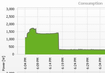

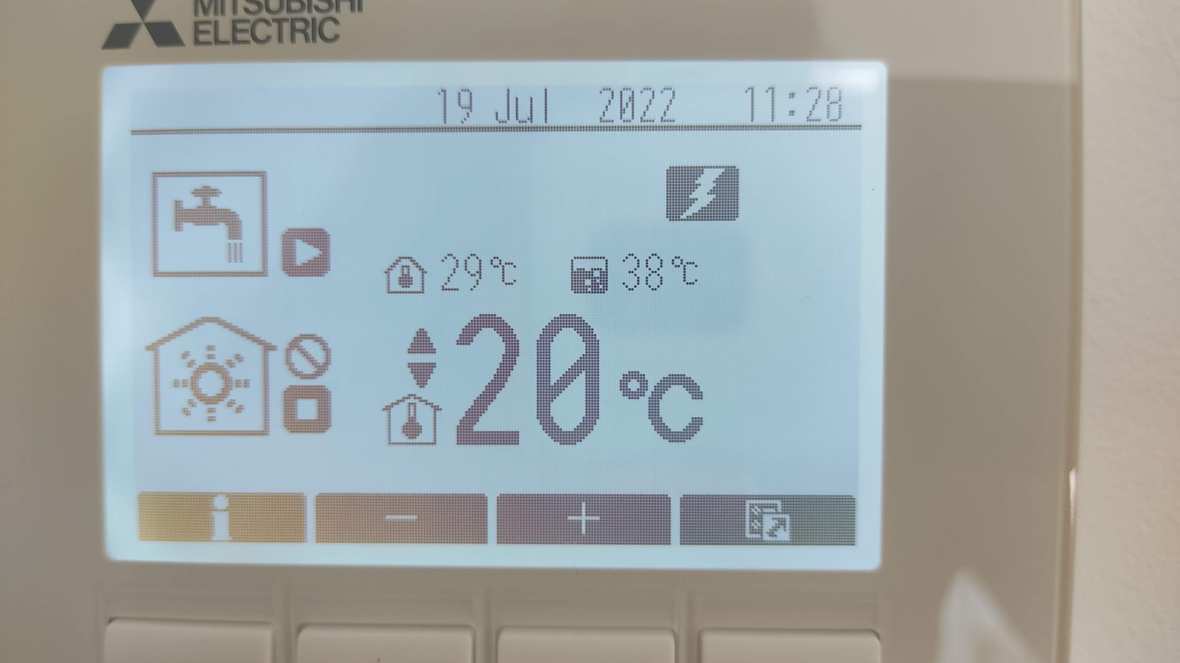

FrankG Posted July 19, 2022 Author Share Posted July 19, 2022 (edited) @TW9I just ran the experiment: set max temp from 50C to 55C. Heat pump stops again at 38C (the power consumption go down), and the FTC shows on the display that the immersion starts (see attached picture). I also tried to set the DHW (hot water) mode in Normal, or ECO - does not make a difference ... What I do notice in my power consumption (I have solar panels, so I can see this almost real-time) is that the heat pump only uses 1.3 kW when in use. I remember in winter that this was a lot higher!? Edited July 19, 2022 by FrankG Link to comment Share on other sites More sharing options...

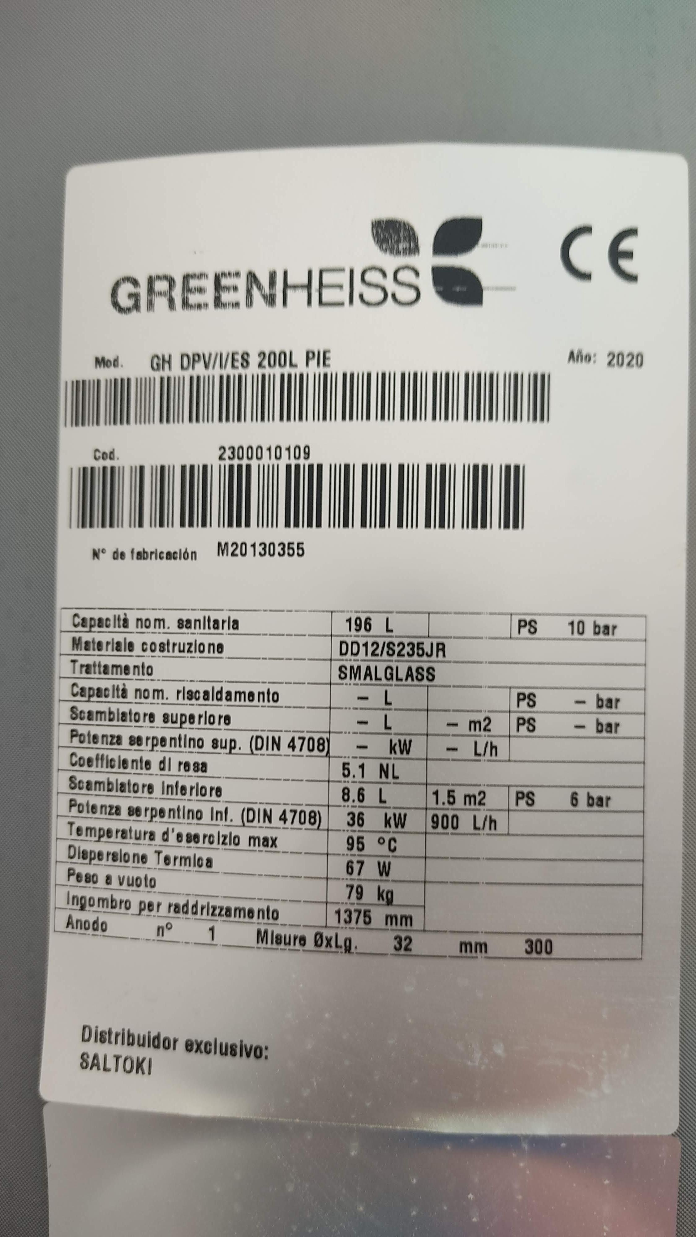

JohnMo Posted July 19, 2022 Share Posted July 19, 2022 No, the return will be lower than 55. If it's reaching 55, then the coil within the cylinder is not suitable for a heat pump. Assume you changed the cylinder when you upgraded to a heat pump. If you didn't or just installed a normal cylinder that is your issue. The coil within the cylinder is too small to transfer the heat from the lower temperature heat pump, compared to a gas boiler which with would be flowing at around 70 degC. The cylinder name plate will have all the info. You take a photo and post on here? 1 Link to comment Share on other sites More sharing options...
FrankG Posted July 19, 2022 Author Share Posted July 19, 2022 (edited) @JohnMo, my house (so also the whole installation) is new - installed in 2020. See attached the plate of the boiler (sorry, in Spanish ...) Edited July 19, 2022 by FrankG Link to comment Share on other sites More sharing options...
JohnMo Posted July 19, 2022 Share Posted July 19, 2022 Looks like your internal heat exchanger coil is 1.5m2 area, I think it more normal to a see a 3m2 coil when connected to a heat pump. So your issue is related to the DHW cylinder and it's internal coil being too small most likely. Did you install yourself or was it specified and bought by the plumber? Also looks like there is an anode to replace to prevent internal corrosion, these normally need to be replaced annually. Link to comment Share on other sites More sharing options...

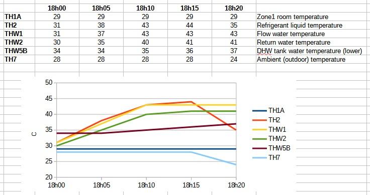

Temp Posted July 19, 2022 Share Posted July 19, 2022 I think I would try measuring the ASHP flow and return temperatures before doing anything drastic with the tank. See if the ashp is even trying to make >38C. Link to comment Share on other sites More sharing options...
PhilT Posted July 19, 2022 Share Posted July 19, 2022 Menu item 3 in the DHW settings determines operation time. Mine is still set at the default 60min which will not be enough for yours if your coil is only 1.5sq m. Until you find a more permanent solution try setting it to the maximum 120min Link to comment Share on other sites More sharing options...
FrankG Posted July 19, 2022 Author Share Posted July 19, 2022 (edited) @JohnMo, @ReedRichards and @Temp, your questions lead to a small test I just did. Attached picture says it all - the temperature of the heat pump / hydrobox does not get above 44C!? Already after 18 minutes the heat pump stops. Not sure why. The operation time is set at 60 minutes, max temp at 50C. What setting (FTC or dip switch) could be wrong here? What's next to test? Edited July 19, 2022 by FrankG Link to comment Share on other sites More sharing options...
HughF Posted July 24, 2022 Share Posted July 24, 2022 1.5m2 is fine for a heat pump coil. Ideally you’d see 2m2 or above but sometimes you just can’t get that size into the cylinder. My vaillant slimline heat pump cylinder is 1.5m2. 1 Link to comment Share on other sites More sharing options...
HughF Posted July 24, 2022 Share Posted July 24, 2022 1 hour ago, HughF said: 1.5m2 is fine for a heat pump coil. Ideally you’d see 2m2 or above but sometimes you just can’t get that size into the cylinder. My vaillant slimline heat pump cylinder is 1.5m2. And by comparison, the non-heat pump vaillant cylinder of the same 150ltr capacity is 0.69m2 coil area. The 300ltr only gets a 0.8m2 coil. Link to comment Share on other sites More sharing options...
