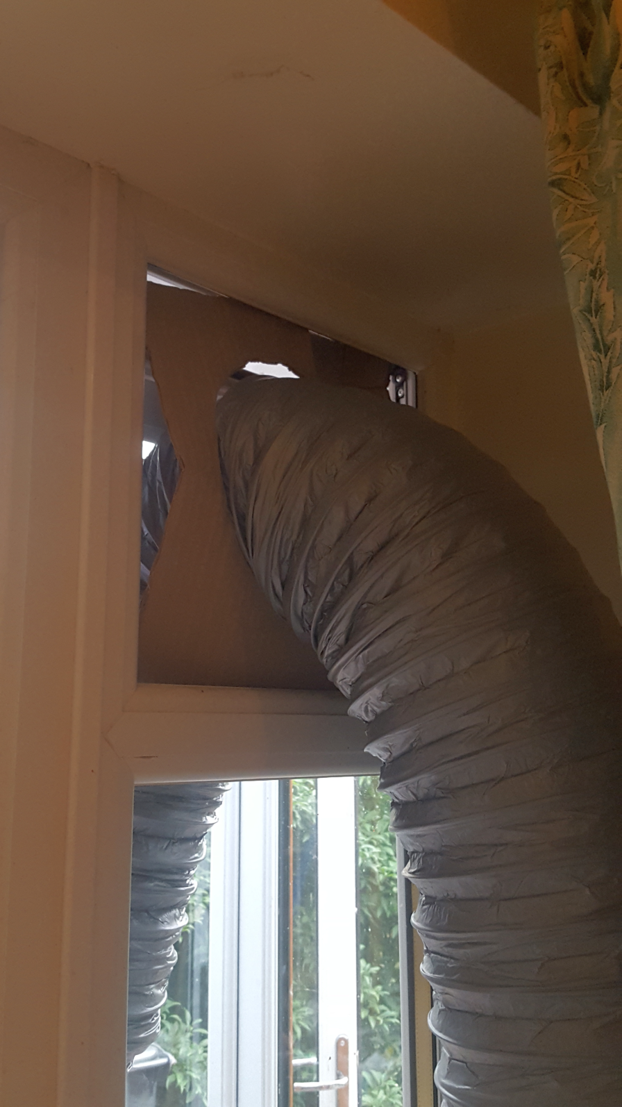

Ferdinand Posted July 17, 2022 Author Share Posted July 17, 2022 Further update: It seems to be keeping my largish - 5x5.5m kitchen - quite convincingly cooler (22C) than outside (29C) on intermittent running on low after a boost early despite being provoked by a 400mm rather than 600mm ventilation pipe (ie 60% smaller) that just goes unsealed via a small window to the conservatory, which has an open window at the other end. It will need tweaking to a 600mm insulated, properly sealed to a window or a wall vent, hose, which should do the job. Getting a few strange noise, but that is perhaps because the venting is jury-rigged. F Link to comment Share on other sites More sharing options...

Ferdinand Posted July 18, 2022 Author Share Posted July 18, 2022 Seems to be working. Just been in my conservatory, and the new aircon has run that up to 40C whilst keeping the kitchen at 23C. On low and the 150mm insulated hose is not here until Wednesday.. Link to comment Share on other sites More sharing options...
Ferdinand Posted July 19, 2022 Author Share Posted July 19, 2022 Update. The insulated 150mm air hose (shades of Fork Handles) has arrived. Very impressive. Ran the air con on full when 35C outside, and it dropped the temp from 25 to 23 in an hour whilst tea was cooking, so seems OK. Even with not-very-good seals. It needs some plywood nurdling I think. Plus some elephant tape. So looking positive. Will see if my proposed model of getting a lowish temperature by about 9am works tomorrow - external temp reported as 25C. Link to comment Share on other sites More sharing options...

Ferdinand Posted July 20, 2022 Author Share Posted July 20, 2022 OK. Reflections. This portable aircon / heat pump is powerful enough to make a difference. I can see it being very useful to cool down in summer and warm up in winter, perhaps even for much of the house if I leave doors open. Potentially it *may* let me significantly reduce the amount I use the GFCH. It will be cost effective if running at the times I want. The biggest issue is that - either via the unit, the handheld or the app - programming cannot go beyond "switch on or off in X hours", which means programming the night before every time, or leaving it on full time with a thermostat setting. The latter runs the risk of it running when I do not want it to - eg in a cool night. I don't believe I can put it on a mechanical timer for say 3 hours a day, and have it auto start at the default temperature. Testing that. I can see daily programming before bed working, but the lack of long term programming is a disappointment. F 1 Link to comment Share on other sites More sharing options...
