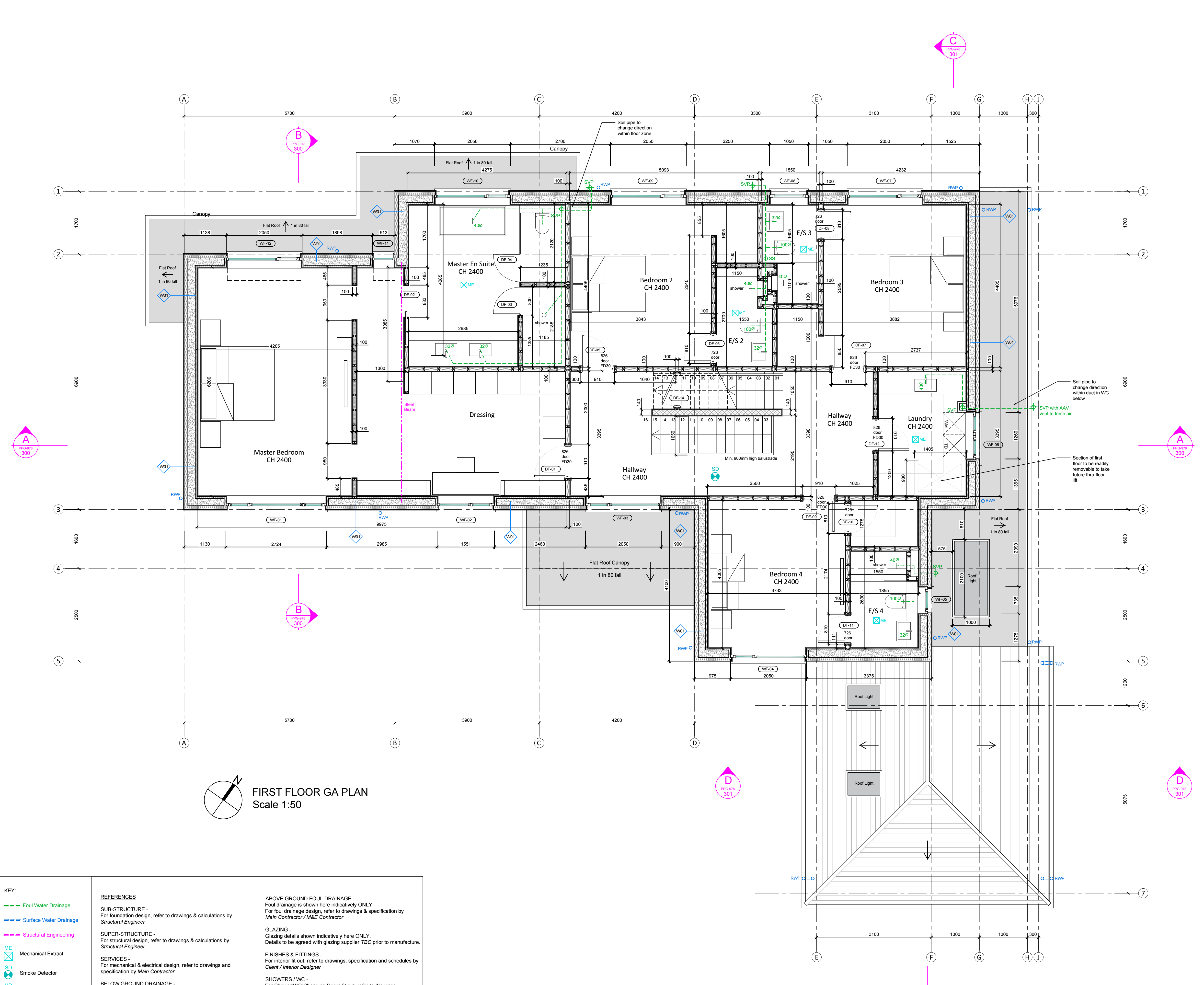

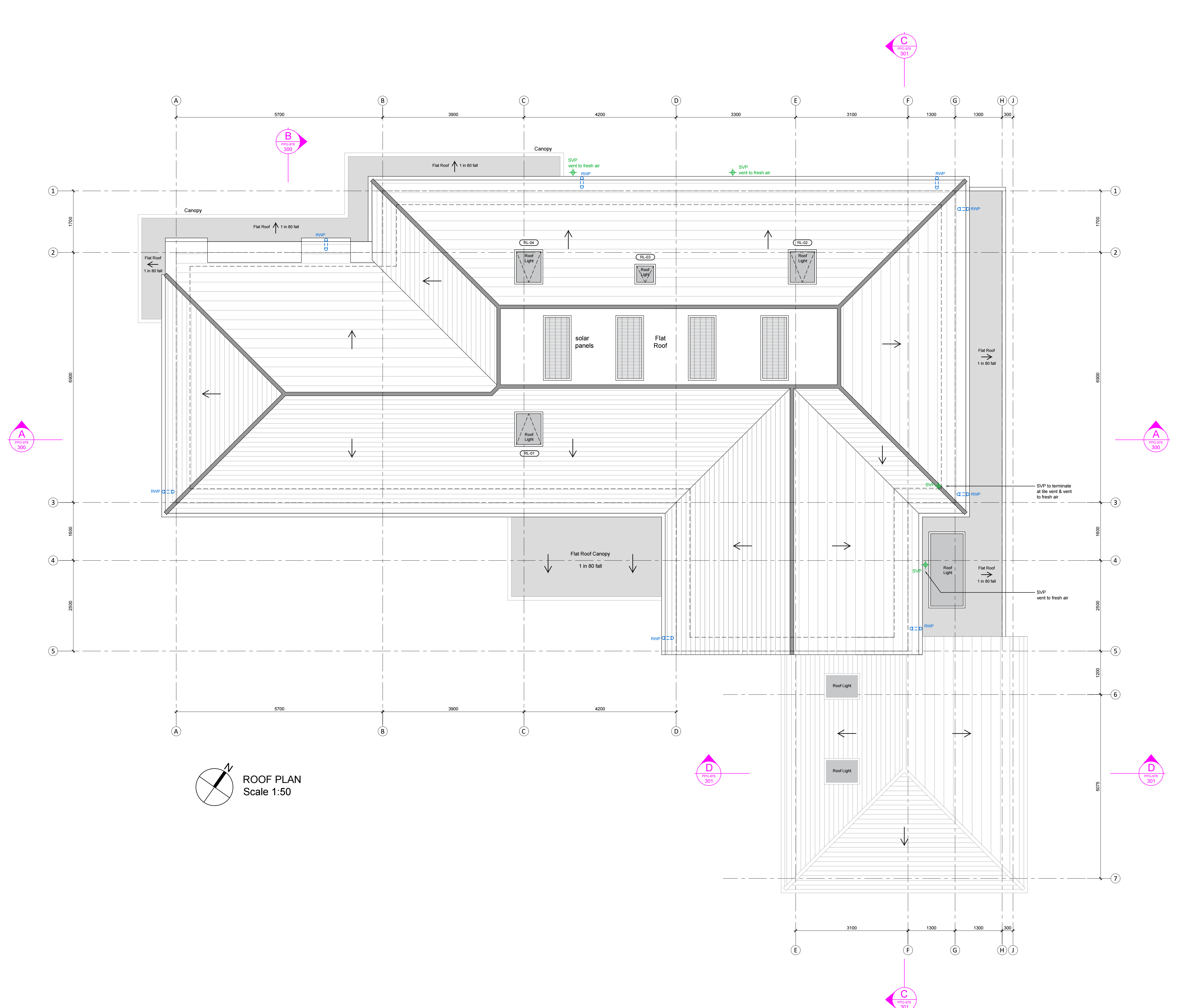

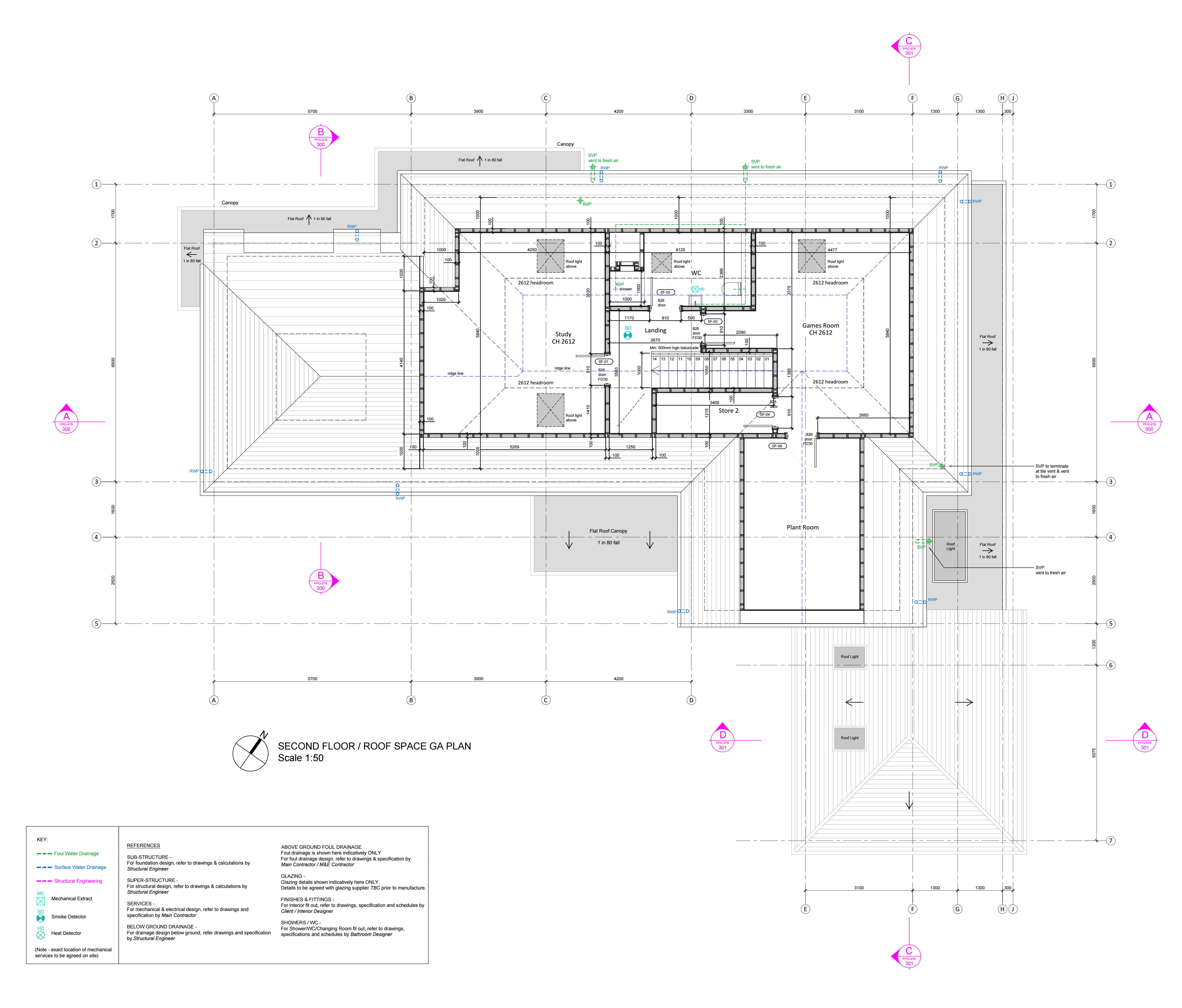

Hi,
I am in a dilemma, I need to decide which way the roof will be designed.
Either Attic Truss which will mean appx £30k worth of Attic Trusses, or I go Cut Rafters on site using large amount of steel work in the roof.
The home will be made in ICF.
What would you guys suggest?
Thanks team.image.thumb.png.8a914b0c811b8cf225adbfbac9fd2de9.pngimage.thumb.png.e4d940183ec02d3b6831f2291f6adbe6.pngimage.thumb.png.0bd045d107552d902e89f2fef76ee581.png

I have decided upon attic trusses, the cost of the steels and then paying chippies to make the cut roof came to a very similar price, but would take much longer.
My chalet bungalow not as big as your house, but the principle will be similar.

I am in the process of framing my roof on an ICF construction. I used UB steels for the ridges and 10mm flitch beams for the valleys and hip. The rafters will be 8x2s filled with mineral wool and 150mm PIR on top to create a warm roof.
It will be slightly cheaper than raised tie trusses because I'll be doing it with a chippie friend. Loft trusses lost me 2m on the width of the rooms and raised tie trusses lost head height.
If the cost is roughly the same, I'd go with steels and a cut roof, you can then maximise the area of the loft.
