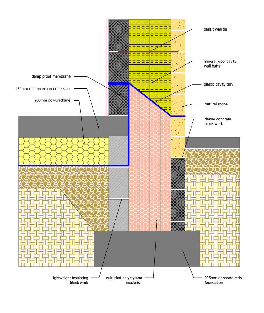

joe90 Posted July 5, 2022 Share Posted July 5, 2022 I did mine in XPS (similar to this) and I am on clay. 1 1 Link to comment Share on other sites More sharing options...

Iceverge Posted July 6, 2022 Share Posted July 6, 2022 Compact sand and gravel here so no heave. We did have a 215mm inner wall so I guess that could be considered structural all on its own. Also we had I think about 3-4 courses of foundation blocks below the cavity. It wasn't built directly onto the poured foundations like the above diagram. If you can assure drainage to a lower plane a French drain would help regulate soil moisture and prevent heave. 1 Link to comment Share on other sites More sharing options...
