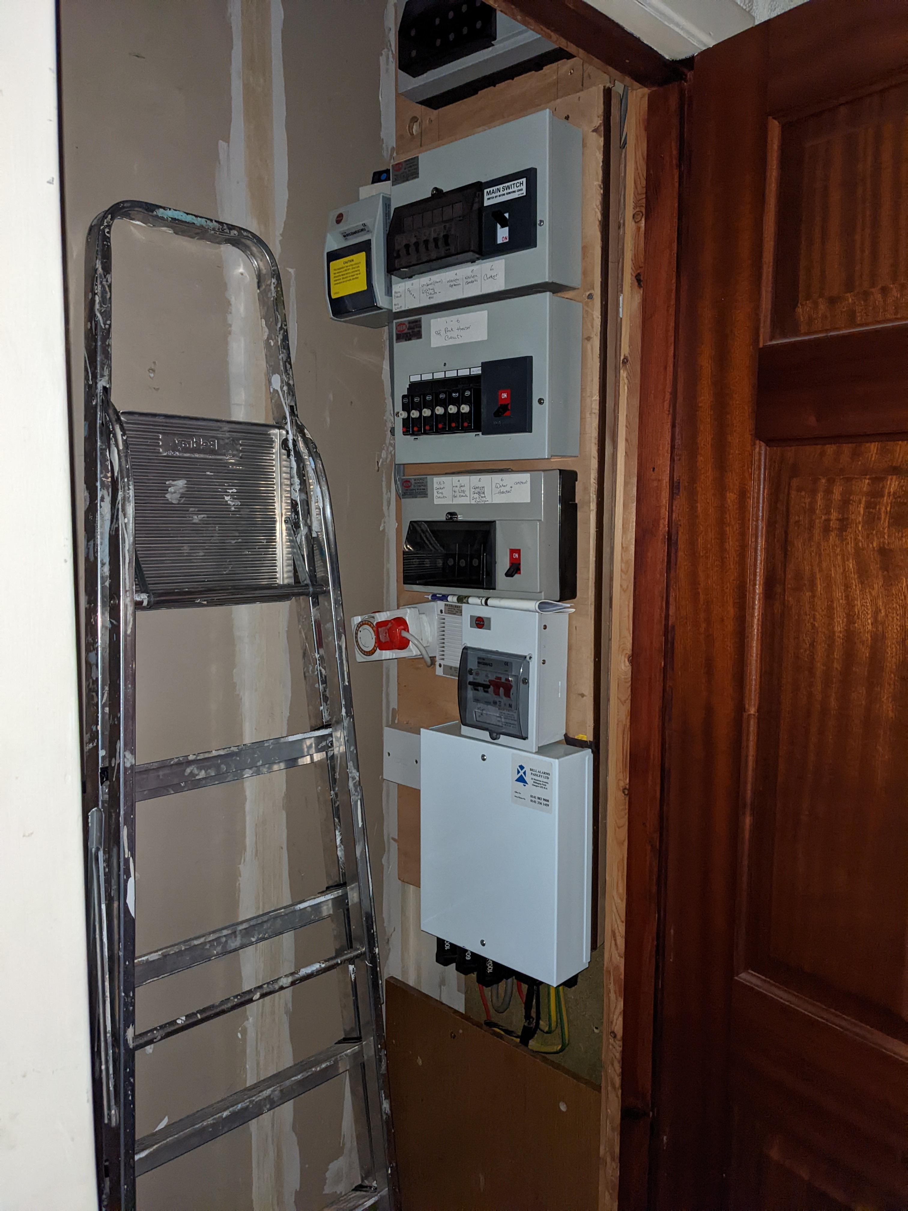

Gill Posted July 4, 2022 Posted July 4, 2022 (edited) I'm looking for a cheap whole house power consumption monitor for eco 7 meter. I'm just after something simple I can scrape the data from that'll give me usage (daily or hourly) and saves me from manual reads. I keep finding products that are no longer manufactured. Any recommends appreciated ? Thanks Edited July 4, 2022 by Gill

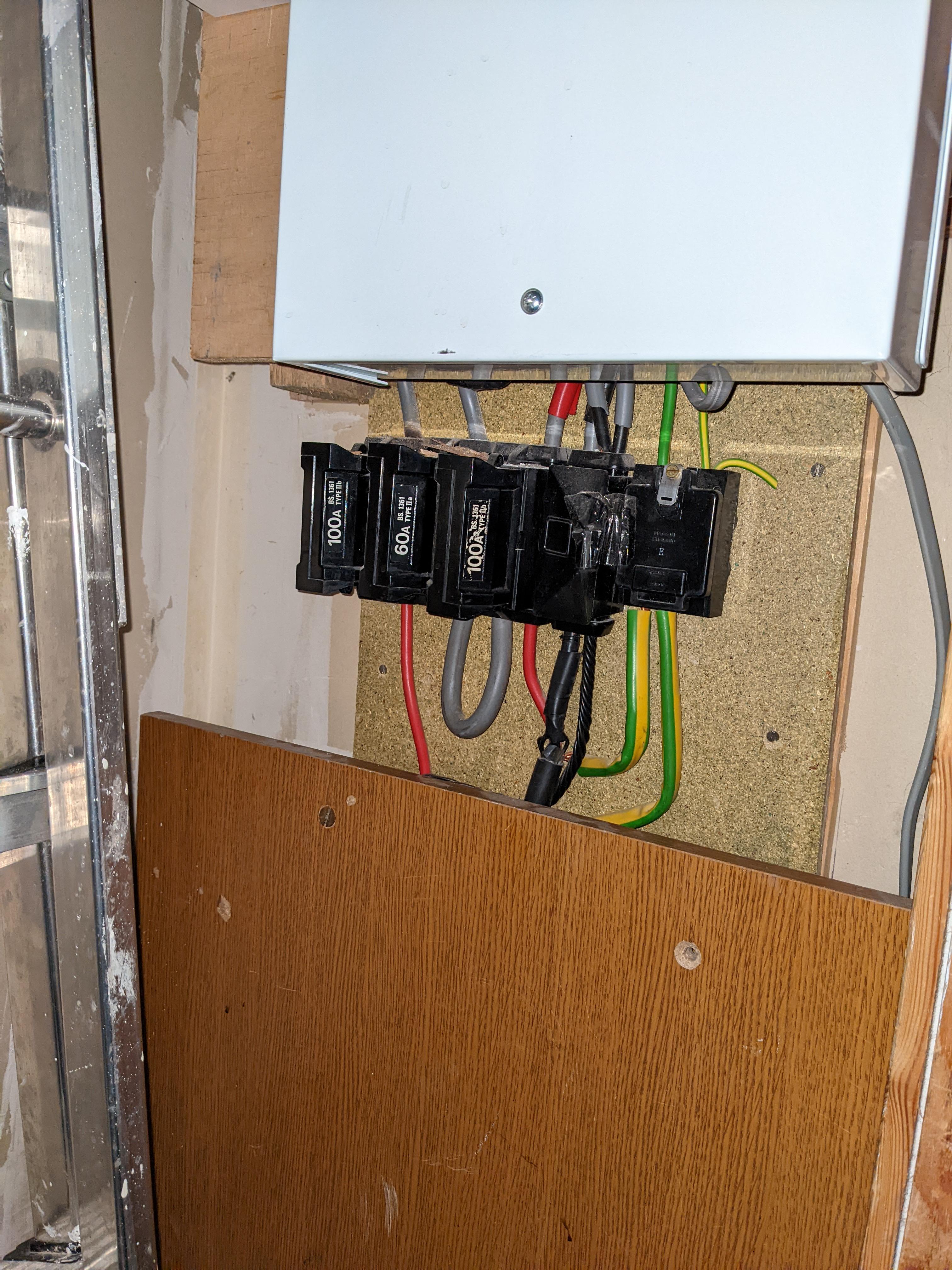

Gill Posted July 5, 2022 Author Posted July 5, 2022 26 minutes ago, ProDave said: My reading is it links directly to your wifi. Are you saying it only works if it can talk to some cloud service? That would certainly put me off. that is why I am asking for someone who has actually used one to tell it like it is. I read through a blog that mentioned enabling mqqt would disable the cloud integration but also reduce the data available via the app so I guess if you're not using HA or similar then seems to indicate a cloud dependancy. I'd be happy to try it out and report back but looking at this I've no idea what the clip(s) attach to in this setup. 🤔
