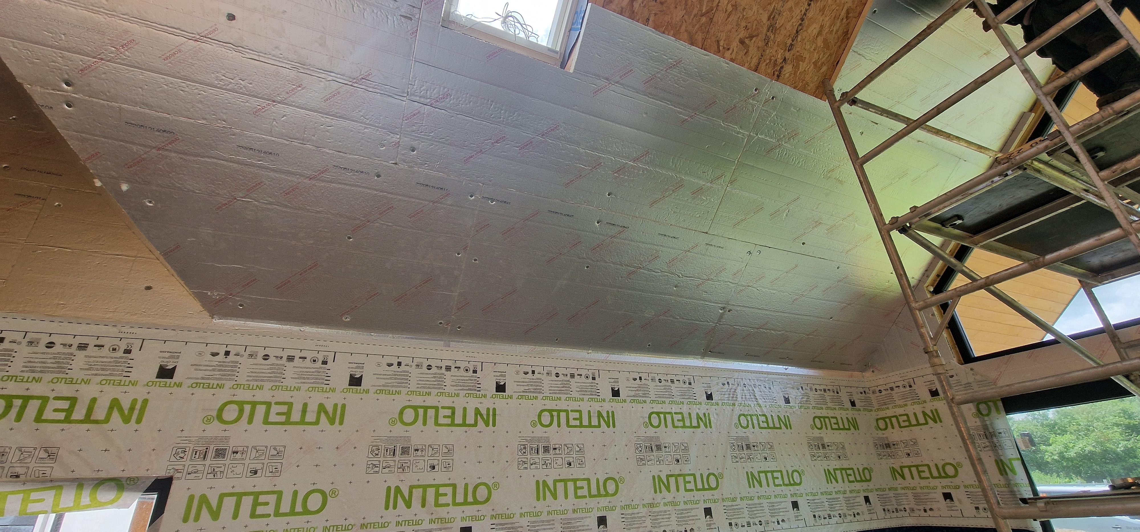

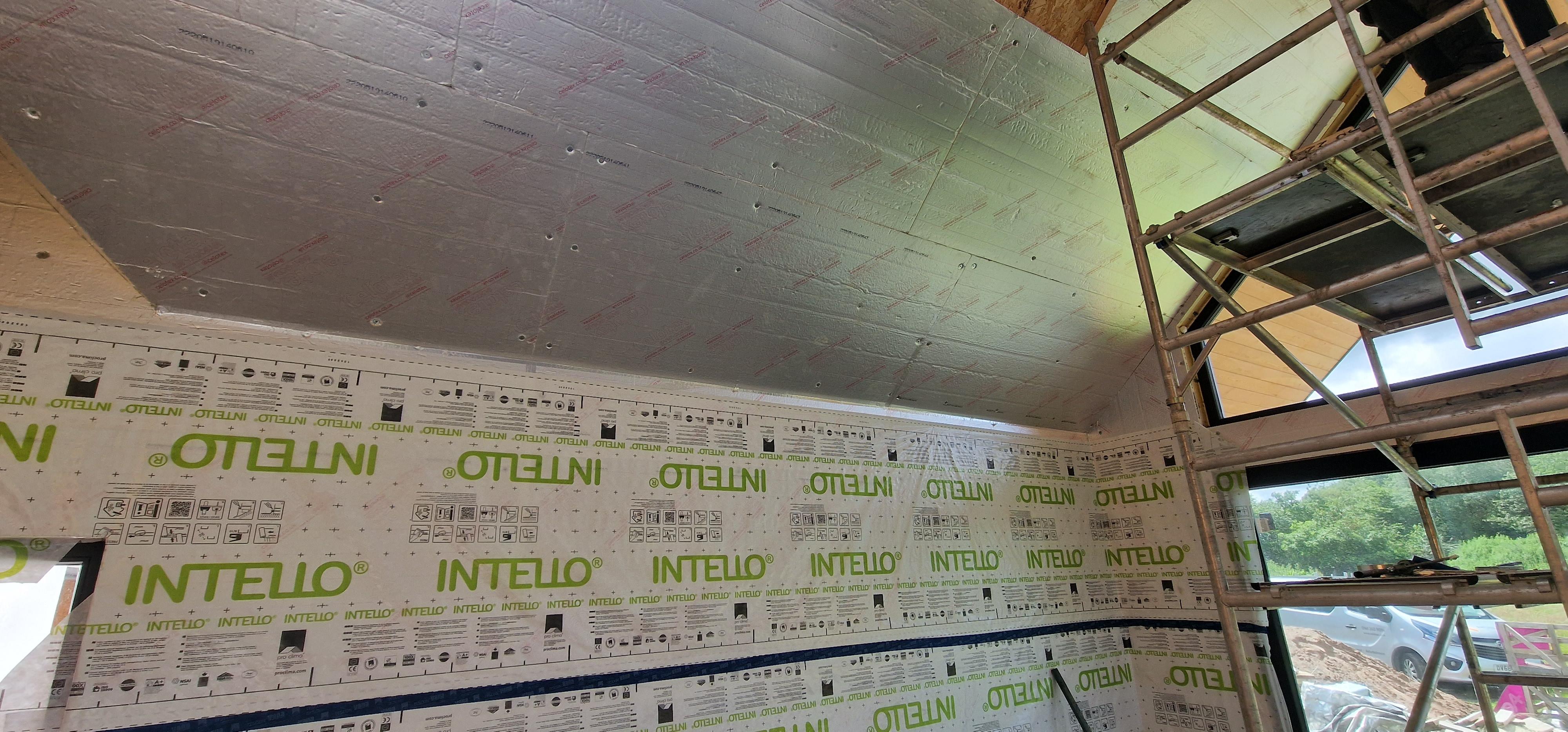

SuperJohnG Posted June 25, 2022 Posted June 25, 2022 I went intello also. Bought from Germany 🇩🇪. Just done today.
LA3222 Posted June 25, 2022 Posted June 25, 2022 2 minutes ago, SuperJohnG said: I went intello also. Bought from Germany 🇩🇪. Just done today. How did you find it in the end? Its easy enough but I found it repetitive and tedius. Cutting PIR insulation is a horrible job - gets everywhere.
SuperJohnG Posted June 25, 2022 Posted June 25, 2022 6 minutes ago, LA3222 said: How did you find it in the end? Its easy enough but I found it repetitive and tedius. Cutting PIR insulation is a horrible job - gets everywhere. I started myself and done a room...was long but today my mate helped who runs a company and brought 7 guys with him. Done full house nearly in a day. Maybe done 90% which has saved me maybe 2 months. 1

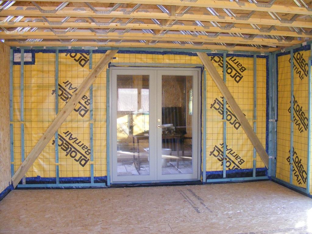

ProDave Posted June 25, 2022 Posted June 25, 2022 I used the Protect Barriair, very similar to the Intello but without the webbing built in so not quite as strong, but a lot cheaper. TIP: This comes with built in adhesive tape but do not trust that, use a good air tight tape as well at the jonints. This comes in a 2 metre wide roll.

SuperJohnG Posted June 26, 2022 Posted June 26, 2022 4 hours ago, LA3222 said: Nice one bud. That's a stroke of luck being able to get that job nipped so quick👍 For sure. Now I'm left to wrestle the airtightness though...these bloody vaulted ceilings are going to be lovely, but they are murder.

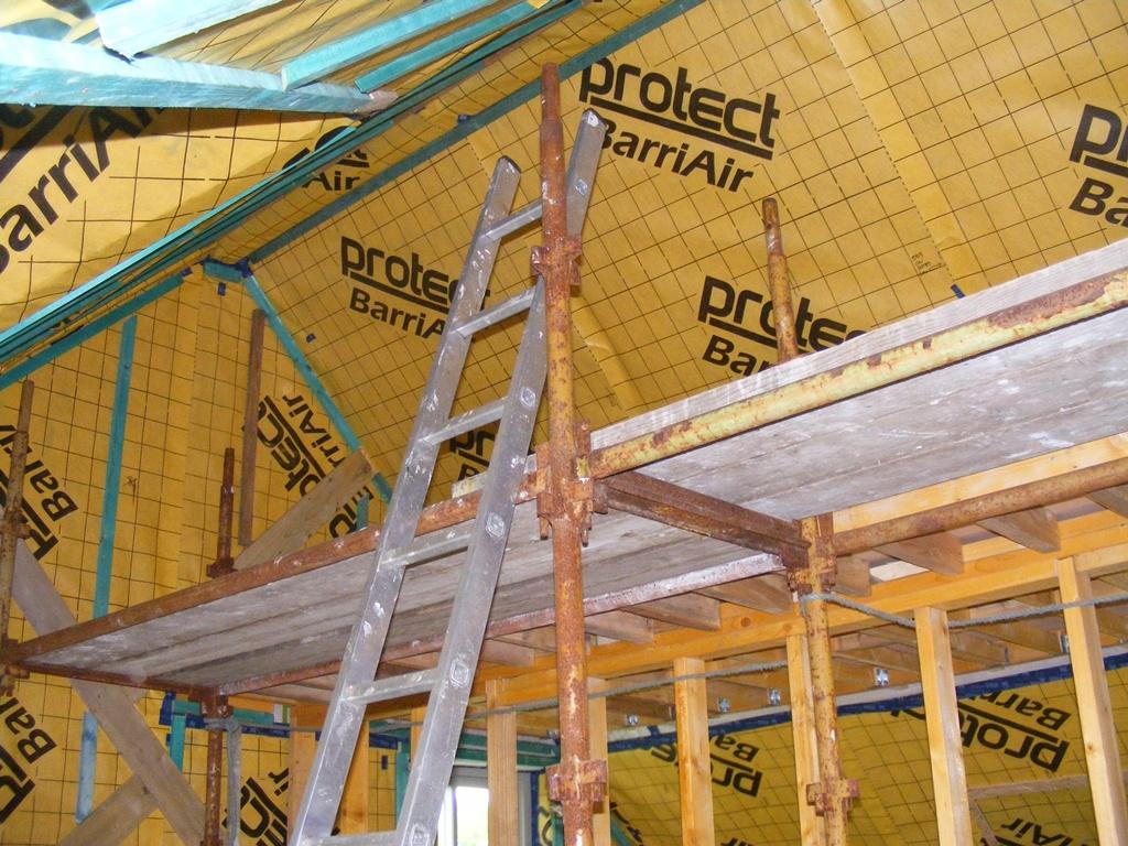

ProDave Posted June 26, 2022 Posted June 26, 2022 4 hours ago, SuperJohnG said: For sure. Now I'm left to wrestle the airtightness though...these bloody vaulted ceilings are going to be lovely, but they are murder. I started at the ridge, fixed a strip of AT membrane in place with a batten (start of service void) then worked down the wall. All single handed. It does feel like trying to put up a massive tent from the inside. Scaffold down the middle to work from and reach the ridge, worked from planks and trestles lower down. If the service void battens don't line up with the self adhesive joints, tape with proper AT tape. 1
