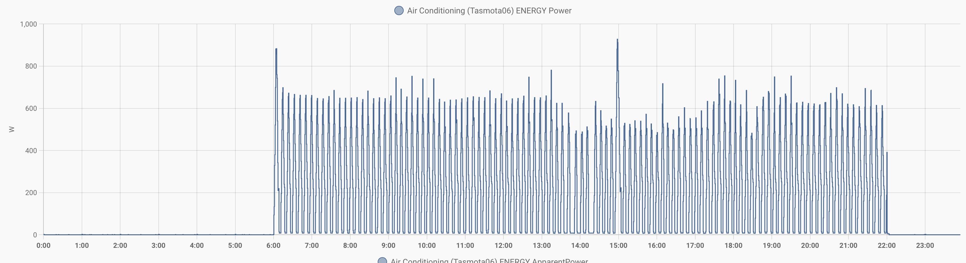

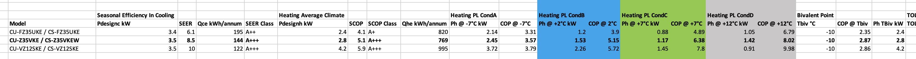

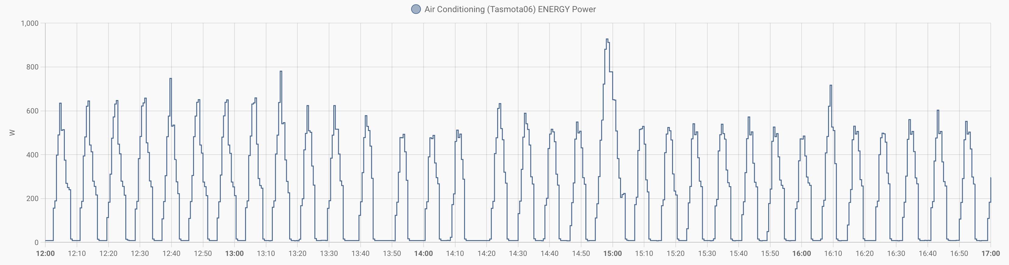

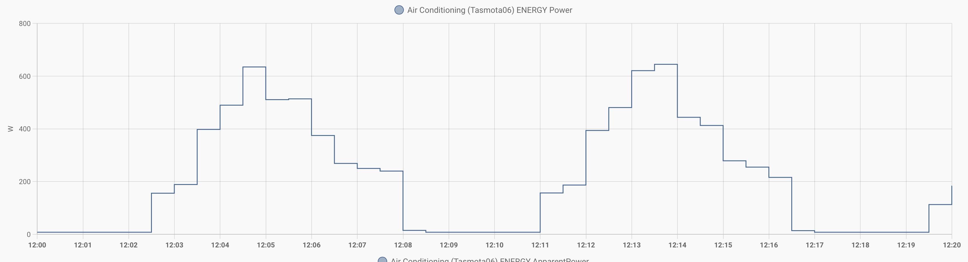

markocosic Posted November 20, 2022 Share Posted November 20, 2022 (edited) I have a single "3.5 kW" Panasonic Etherea unit downstairs in an averagely crap house. (70 m2 1970s council terrace with "filled" cavity, double glazing, and an awful attic conversion) https://www.saturnsales.co.uk/Panasonic-Etherea-CS-Z35XKEW-Wall-Mounted-System.html It's a little undercharged as it has 15 m of pipework rather than the 7.5 m precharge. Turned it on for the first time on Wednesday. It's set to "17C" which translates to the open plan downstairs at 20C - go figure - and bedrooms upstairs at about 17C. It's set to run from 06:00 to 22:00. The overshoot on Saturday was me cooking. It cycles a lot at this low output. It uses about 4 kWh/day. That feels eminently reasonable for 2C overnight / 10C daytime. The COP ought to be of the order 5 (at 2C) to 8 (at 12C) at low outputs - hence running it during the daytime - but there's no way to check. The "heating biased" CU-VZ12SKE / CS-VZ12SKE unit would be a much better choice. (look at the power numbers for what's nominally the same capacity unit) https://www.aircon.panasonic.eu/MT_en/model/kit-vz12-ske-cs-vz12ske-cu-vz12ske/ The "heat charge" is just for defrost; to avoid cooling the indoor air to defrost the coils. Edited November 20, 2022 by markocosic 1 Link to comment Share on other sites More sharing options...

Radian Posted December 20, 2022 Share Posted December 20, 2022 On 20/11/2022 at 22:11, markocosic said: The COP ought to be of the order 5 (at 2C) to 8 (at 12C) at low outputs - hence running it during the daytime - but there's no way to check. I see you're using Tasmota to monitor the power draw using MQTT I imagine. I have yet to insert some smart sockets to measure my A/C units. I bought a pack for this purpose but they've all been nabbed for the x-mass deccies. 🙄 But I think I might have made a mistake by scheduling the heating to be running all night set back to 16oC - I only have the crude energy report in the Daikin App to go on but it shows an average of 12kWh per day to maintain 16oC/20oC inside for two 3.5kW units heating 60m2 throughout last week when it barely got above freezing all day. On the other hand, by comparison, that's pretty good compared to the 160kWh/day average for my gas CH serving 190m2 😧 Link to comment Share on other sites More sharing options...
