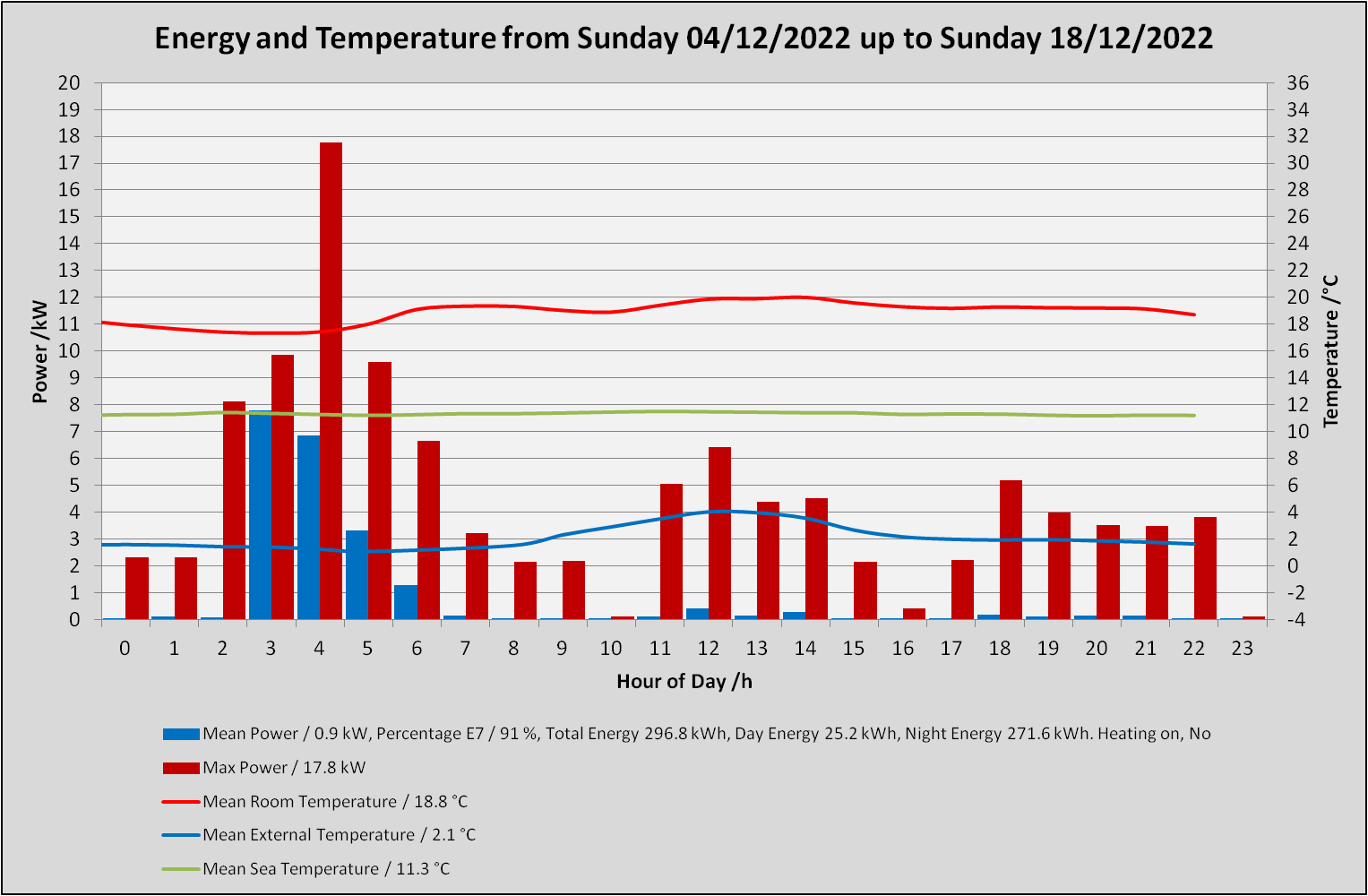

Right.  Here is the last two weeks data.  I know that I live in the warmest part of the country, but for here, it was artic.
Work out at 4.6 kWh/m2 for that periods space heating.  As my heating season is about 12 weeks, that will be 28 kWh.m2.
Not too bad, especially as the mean temp was only a gnats over 1°C down.

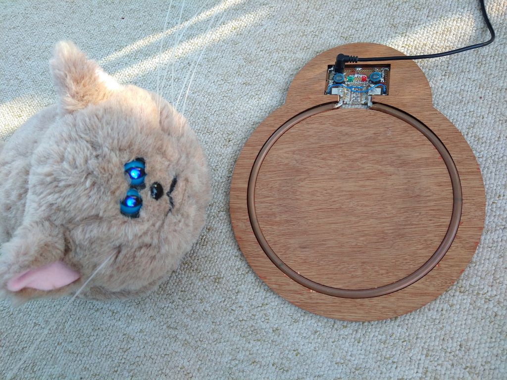

Yes. The resonant frequency is always kept above audio frequencies - usually somewhere between 25kHz and 60kHz. I made a wireless power transfer system to charge our robot cat (he just drives on and off a flat plate) but that's running at over 1mHz. At such high frequencies the inductive reactance of that single loop of copper tube is not a short circuit but allows around 10W of power transfer from a 12V 1A power supply.
