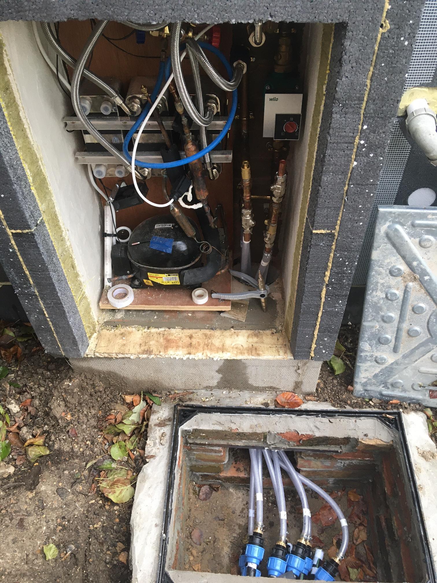

RobLe Posted June 4, 2022 Share Posted June 4, 2022 Here's a pic of ours, been heating our house 'since Dec last year. Diy....maybe you can tell that from the piccy! It uses ~200g of R290, not an F-gas, but lots of care is needed. It lives outside, but inside the ongoing garage EWI to keep it a happy temperature all year. We still have the gas boiler plumbed in - Mrs RobL needs a year of heatpump use to be convinced we can disconnect. I say she needs more faith. It's 600W in, ~2400W out. Ish, as it's very hard to measure accurately the heat out. Standby loss is 2W from a micro logging stuff, there's no heaters, no immersion nonsense, no fancy clever stuff, just on or off and a few safety checks (flows, temperatures). I reckon it cost: £500 for the bits you can see and £1500 for the stuff under the ground you can't. And "some" time, which is of course, free:-) 3 1 Link to comment Share on other sites More sharing options...
