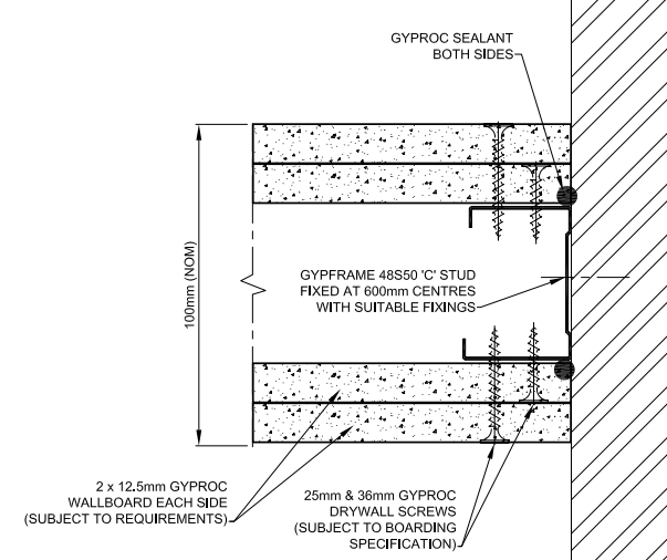

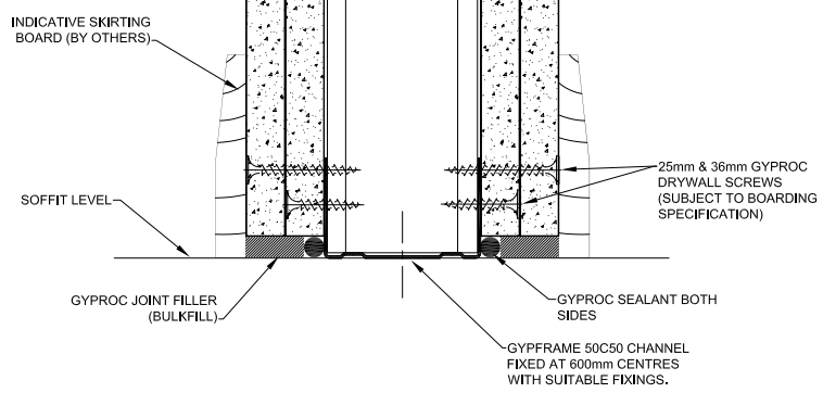

MortarThePoint Posted May 28, 2022 Share Posted May 28, 2022 (edited) BG show this used all over the place. They recommend it is used around the edge of metal frame, so between frame edge and wall, floor or ceiling soffit (couple of examples below). I'm a bit dubious as you're then putting plasterboard over the top and skimming or taping and jointing which ultimately adds far more material. Am I missing something, or are BG just trying to get more of the value chain? They say it "Boosts acoustic performance by sealing gaps". If it is worth putting something there, why not just use caulk or something similar/cheap (Gyproc Sealant >£12/tube, caulk ~£1/tube). I often find I phone up merchants trying to buy parts of a 'system' that it turns out nobody actually bothers with. https://www.british-gypsum.com/products/finishing-products/gyproc-sealant https://www.gyproc.ie/knowledge-centre/cad-drawings Edited May 28, 2022 by MortarThePoint Link to comment Share on other sites More sharing options...

MortarThePoint Posted May 29, 2022 Author Share Posted May 29, 2022 9 hours ago, nod said: Please don’t say that I buy at least a couple of thousand tubes of the stuff each year 😂 Thanks nod, good to hear it is used. There's a lot to be said for following the standard recipe. I can appreciate a sealant could help air leakage, but am doubtful about the sound. Sound can't leak through small gaps like air does due to diffraction. Think of your microwave door with its mesh. Perhaps it helps by acoustic coupling the frame to the background. Link to comment Share on other sites More sharing options...
Onoff Posted May 29, 2022 Share Posted May 29, 2022 Pretty sure if it didn't work it wouldn't be a thing! https://soundproofexpert.com/acoustic-sealant/ Link to comment Share on other sites More sharing options...

dpmiller Posted May 29, 2022 Share Posted May 29, 2022 1 hour ago, MortarThePoint said: Sound can't leak through small gaps like air does due to diffraction. Think of your microwave door with its mesh. Umm, electromagnetic waves are very different to sound waves. Sound is pressure pulses and absolutely will sneak through tiny gaps. 2 Link to comment Share on other sites More sharing options...
nod Posted May 29, 2022 Share Posted May 29, 2022 1 hour ago, MortarThePoint said: Thanks nod, good to hear it is used. There's a lot to be said for following the standard recipe. I can appreciate a sealant could help air leakage, but am doubtful about the sound. Sound can't leak through small gaps like air does due to diffraction. Think of your microwave door with its mesh. Perhaps it helps by acoustic coupling the frame to the background. It’s probably the most photographed item on my phone Said but true All commercial and often housing associations Price sounds high I think we are around a fiver a sausage Buying by the box Link to comment Share on other sites More sharing options...
MJNewton Posted May 29, 2022 Share Posted May 29, 2022 2 hours ago, MortarThePoint said: Sound can't leak through small gaps like air does due to diffraction It absolutely can, and is often the reasoned efforts to provide soundproofing are so significantly undermined due to poor detailing. 1 Link to comment Share on other sites More sharing options...

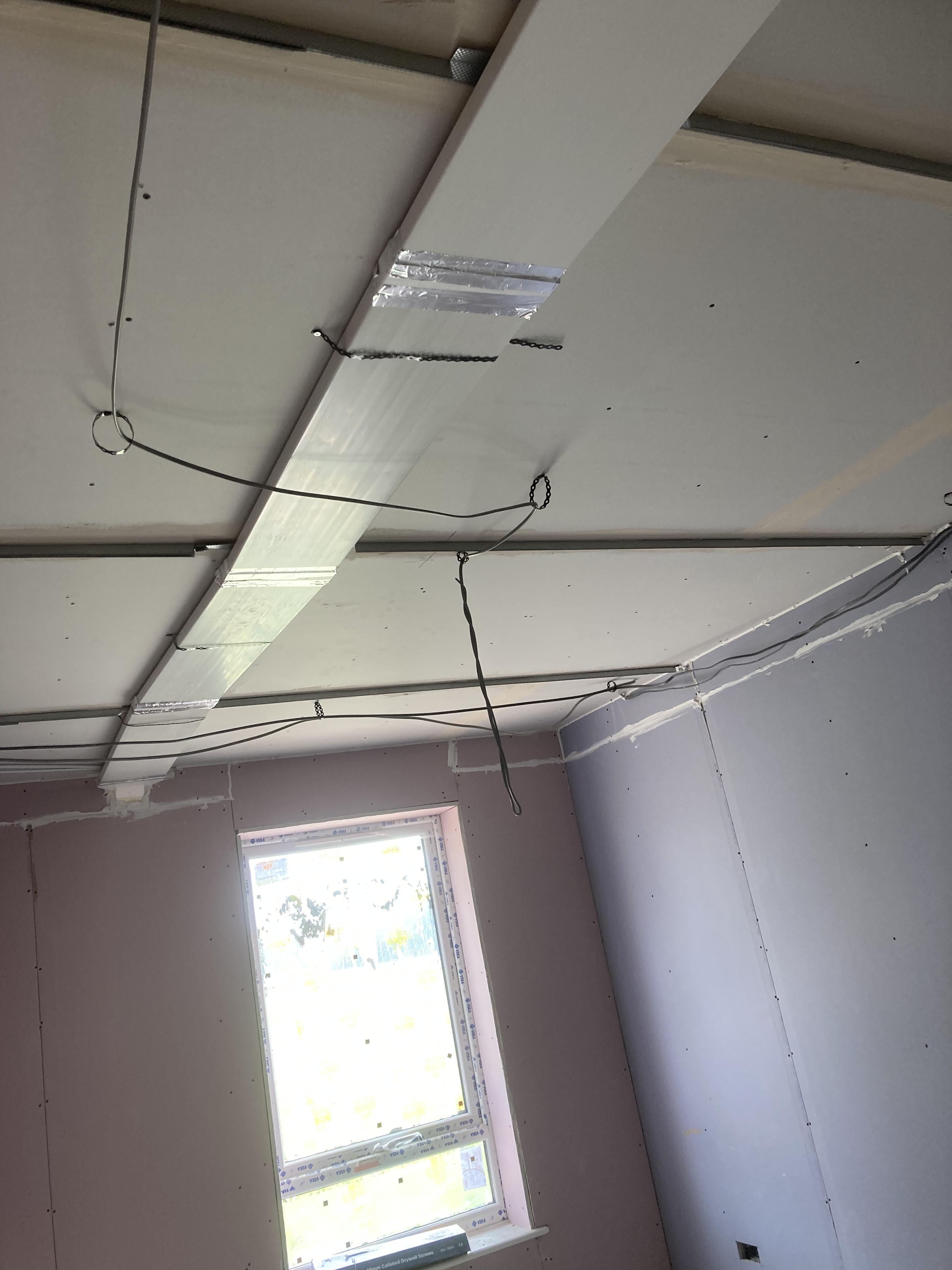

nod Posted May 29, 2022 Share Posted May 29, 2022 10 minutes ago, SimonD said: And your photo has just reminded me that I forgot to tape a couple of duct joints before I fitted some kitchen cupboards and splashback! Thanks The photo shows one of our housing association jobs Far superior to homes that we do at a million pound plus Drop ceilings under all first floor ceilings Link to comment Share on other sites More sharing options...
SimonD Posted May 29, 2022 Share Posted May 29, 2022 7 minutes ago, nod said: The photo shows one of our housing association jobs Far superior to homes that we do at a million pound plus Drop ceilings under all first floor ceilings That's good to know. Hopefully they can all build more of them as we surely need them. Link to comment Share on other sites More sharing options...
