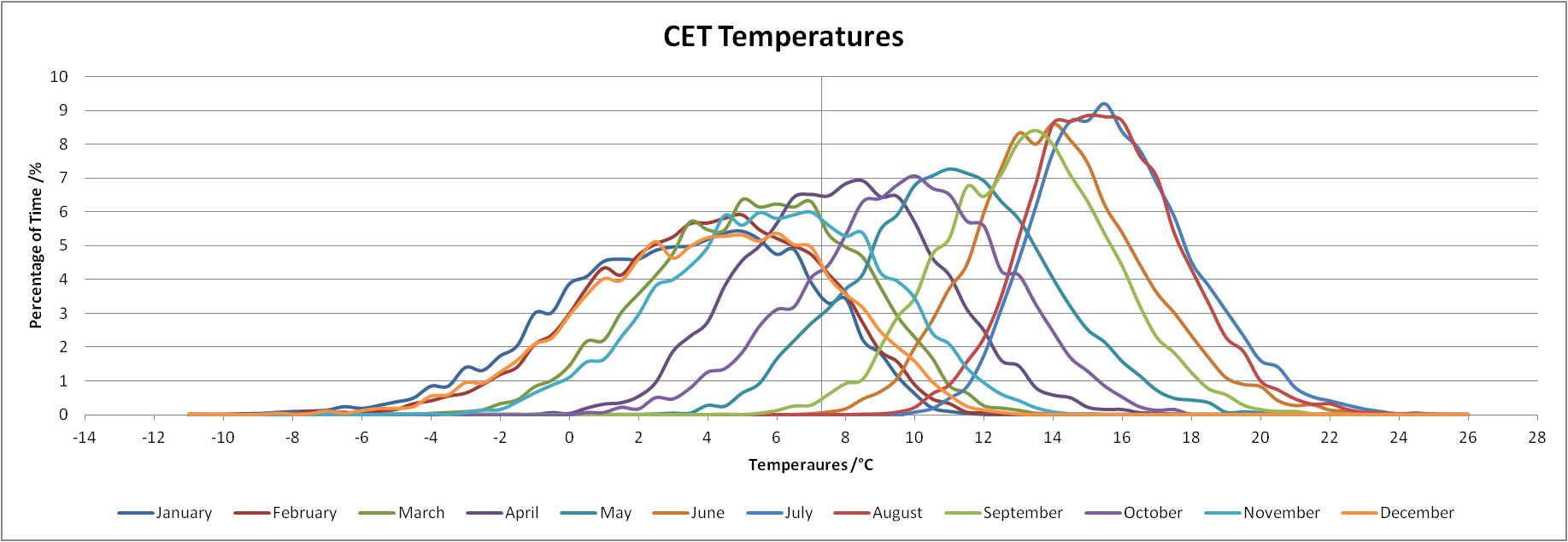

It really comes down to how your house performs for each incremental degree of heating.
One thing you do know about it your hot water, that you need every day, and probably about the same amount.
Assuming you have the heating off at the moment, know is a good time to monitor that energy usage.  You then have your ASHPs base load.  Knowing that, you can play around with different times and tariffs.
It is worth accepting that there may be times when it works out more expensive to run an ASHP at high loads i.e. when OAT are low.  If you can identify those times, compare the running costs to turning down your flow temperature and plugging a fan heater in.
It is all a numbers game.  A fun one.
And remember that mean temperatures can be plotted at a percentage of time they happen.  Here is the Central England ones boing back to 1772
