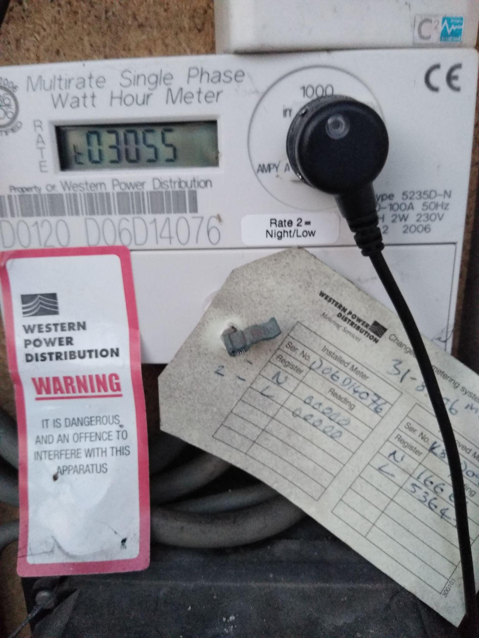

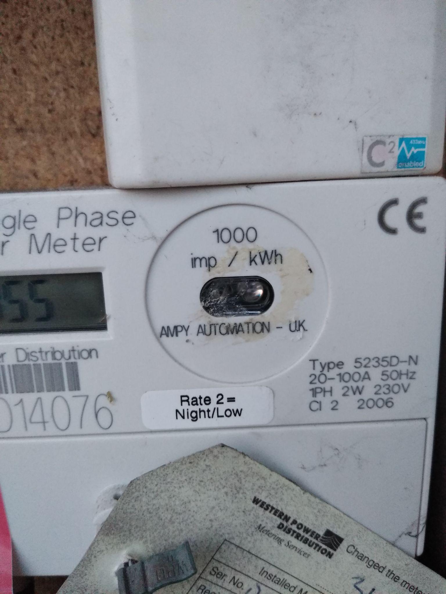

SteamyTea Posted July 18, 2022 Posted July 18, 2022 3 hours ago, SteamyTea said: Does your meter have 2 LEDs, one for direction and one for quantity? I seem to remember that my neighbours smart meter has 2. Follow up. My old meter has two LEDs. First picture is with the CC OptiSense sensor in place, which I notice has its own red LED that flashes in synch with the meter one, so should be easy to test out my homemade logger. Second us just the two LEDs.
TonyT Posted July 18, 2022 Posted July 18, 2022 Isn’t one of the Leds a Indra red receiver, I’m sure I’ve seen the DNO with a laptop program them…. Via a clip on led transmitter years ago mind…
Radian Posted July 18, 2022 Author Posted July 18, 2022 3 minutes ago, TonyT said: Isn’t one of the Leds a Indra red receiver, I’m sure I’ve seen the DNO with a laptop program them…. Via a clip on led transmitter years ago mind… Yes it looks like an IEC 62056-21 optical bi-directional comms port.

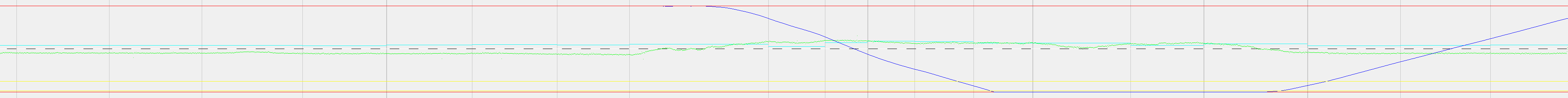

Radian Posted July 31, 2022 Author Posted July 31, 2022 Well, I'm pretty cheesed-off right now. I seem to have lucked-out with my utility supplied smart meter. Unlike the vast majority of meters, mine appears to have a teensy tiny Joule buffer - something less than 450J by the looks of things. To arrive at this conclusion I added a 'live stream' of my cycle-by-cycle plot using websockets. It makes capturing elusive events much easier. Here's a long 'still' from a recent experiment... ..So here I had set things up to measure the size of the Joule bucket (what I've been assuming to be 3600J) by switching off the dump load and letting a couple of hundred PV watts leave the meter and go out into the grid for a few minutes. This is to ensure that the bucket is totally brimmed to overflowing. Then my generation is allowed to fall and power to slowly go from -ve (export) to +ve (import). A close up of the transition... The grey vertical on the left is the last meter impulse tracking my export (yes, the meter impulse LED flashes both for import and export). Then the power (green trace) climbs from -ve (export) to +ve (import). The assumed content of the Joule bucket (blue trace) then falls from the maximum clipped level (3600J assumed) as imported power is draw out from the bucket into the house. But rather than falling to zero, it only gets down 1/8th the way (around 3600/450) before the first import meter pulse arrives and I'm charged for the power. So between me and the supplier (theoretically) being billed for export and import between the two impulses, there's only a zone of around 450J where power may be pushed out and pulled in without charge. This is disappointing as it makes measurement tolerances and response times extremely tight.
Radian Posted October 31, 2022 Author Posted October 31, 2022 Time for an update. I settled with working within a 450J window and it's not too much of a hassle. The diverter has been in constant operation for 3 months now and has only let 6% of what it has diverted out to the grid. However, last week I installed a new UPS for some computer kit and immediately noticed a problem. The switching supply in the UPS puts a tragic amount of wideband noise on the mains when charging the battery and this was swamping my X10 like 120kHz signalling. I was using this as a low latency signal to "burn" cycles remotely around the house. But as elegant as it was, it's no good if it can't be relied on. Back to the drawing board (I always suspected this might be an issue). I then revisited the use of MQTT but nothing I did could get latency down below a max. of 160ms. At 3kW this is about 500J so the buffer could easily over/underflow and hence possibly cost me unnecessary import. UDP was still too slow with a max. latency of 80ms. Something else was needed. This is when I started looking at RF modules like the Nordic Semis NRF devices. But when researching I found comparisons with a thing called ESP-NOW. Turns out I don't need another RF module as Expressif have implemented a low-latency peer-to-peer communication protocol that can run concurrently with the WiFi stack on the ESP8266 and ESP32. It works by allowing small packets to fly between devices point-to-point. They're not passed through access points or switches and have a latency of a couple of milliseconds as a consequence. Perfect! It also has a broadcast capability so my goal of being able to distribute dump loads around the place is nicely catered for. The packets are only 250 bytes but that's plenty to have a 'burn' flagbit and a frame count (to spot missing packets for a QOS check) as well as a cycle-by-cycle voltage and power measurement to keep the immersion unit updated with the bigger picture. Being point-to-point also means the entire network, along with MQTT etc. can go down but the measurement unit and distributed dump load switches will all stay working. The range isn't great though and I've swapped the ESP32's with ones that can have an external antenna to improve the range. However, even with 5% packet loss, with packets sent at the end of every cycle it would be unlikey for 5 out of 100 to go missing in a row and lose 100ms (300J). Also, it's easy to rebroadcast the packets with a repeater that can extend the range. Somehow ESP-NOW manages to step in and answer all my prayers for the sake of a tiny extra code overhead. 2
