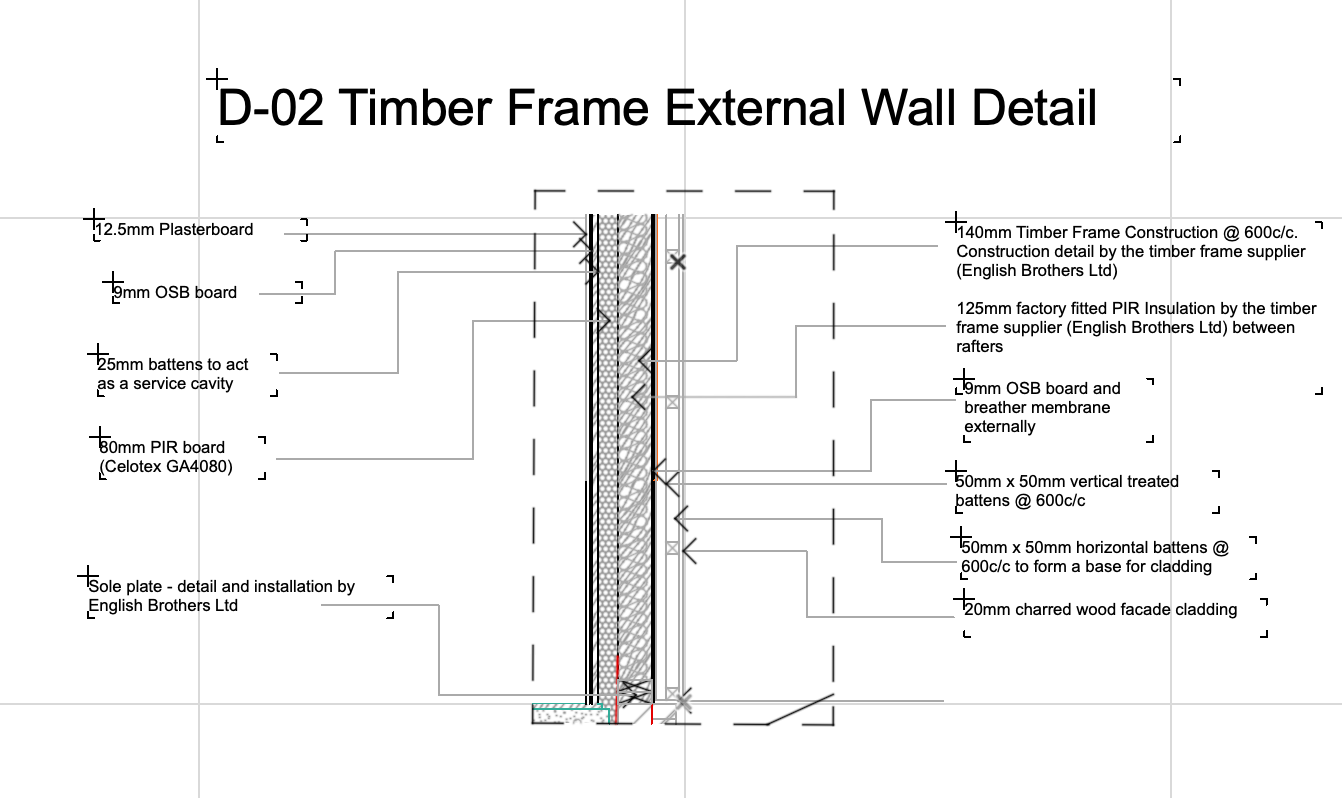

BartW Posted May 14, 2022 Posted May 14, 2022 Hi, We are about to start with the Timber Frame. Shell is in production right now, and is expected to come fitted with 120mm PIR in-between the studs, and osb externally. I have been forever planning on adding 50mm insulation (PIR) internally. But speaking to my neighbour, who is insulating externally, it suddenly made more sense to me: - quicker as no need to negotiate internal studs or floors - more continuous, thus fewer possible cold bridges Most importantly, in view of my recent dilemmas about void ventilation: - I could extend insulation right down "to the ground" - hide the void ventilation telescopes in sections of removed insulation - install cement board across the lower part of the wall, and decorate / render / brick slip it We are cladding open rainscreen. Our timber frame supplier will finish the building by wrapping the whole frame with OSB to the face with VCL. Am I right in thinking I then go: - 50mm PIR - vertical battens - cross battens - vertical rain screen cladding Any downsides to doing it like this? Many thanks! Bart

Iceverge Posted May 15, 2022 Posted May 15, 2022 1 hour ago, BartW said: Back on topic, is there anything wrong with applying secondary PIR externally, rather than internally? Have you considered an airtight/vapour barrier anywhere in the buildup? If you add external PIR there's a risk of condensate forming on the back of the sheets and rotting the sheathing (OSB I guess). It'll probably be fine if you've got a good airtightness/vapour control layer with no holes inboard somewhere. Airtightness will be much more important from an energy use and comfort point than insulation, what target do you have?

Iceverge Posted May 15, 2022 Posted May 15, 2022 I should probably ask a more specific question. Can you describe your total wall build up from outside to inside specifying will be done when the timber frame factory has done and what remains to do yours self.
BartW Posted May 15, 2022 Author Posted May 15, 2022 6 hours ago, Iceverge said: I should probably ask a more specific question. Can you describe your total wall build up from outside to inside specifying will be done when the timber frame factory has done and what remains to do yours self. So, the anticipated build-up from inside out was going to be (does not detail the membranes):
Nickfromwales Posted May 16, 2022 Posted May 16, 2022 21 hours ago, BartW said: is there anything wrong with applying secondary PIR externally, rather than internally? 9 hours ago, BartW said: So, the anticipated build-up from inside out was going to be (does not detail the membranes): 185mm gross is a healthy amount of PIR, so I would stick with this tbh. Now I see the 60mm internally the concern of cold bridging from the frame is dealt with. Don't apply to the outside, as others have said, as it will unnecessarily complicate things ( with little reward imo ). Looks good as-is. 1

JohnMo Posted May 18, 2022 Posted May 18, 2022 Looking at your wall build with respect your service cavity. You have plasterboard, OSB, batten for service cavity. This should be plasterboard, batten for service cavity, OSB. If you floor has a ventilation within the void it's there for good reason. If your insulation is above the ventilation why are you worried?
Thorfun Posted May 18, 2022 Posted May 18, 2022 3 minutes ago, JohnMo said: This should be plasterboard, batten for service cavity, OSB. why do you specifically state this? I see no issues with putting OSB on top of the service cavity with plasterboard on top of that. I've spoken to a number of builder friends and they all say that they put plasterboard on top of OSB as it gives the wall a rock solid feel. it is something I am very seriously considering. On 15/05/2022 at 22:07, BartW said: So, the anticipated build-up from inside out was going to be (does not detail the membranes): can I ask if you have a specific reason for using 2" x 2" battens for your timber cladding? we used 2" x 2" for ours due to the fact that our external blinds needed the space between the building and the cladding to function but it cost us a LOT of money especially as we, like you, are going for vertical cladding so needed to batten and counter batten. if you don't specifically need that size battens it might be worth using 2" x 1" roofing battens as that should save a ton of money? just a thought. 1
JohnMo Posted May 18, 2022 Posted May 18, 2022 5 minutes ago, Thorfun said: why do you specifically state this? I see no issues with putting OSB on top of the service cavity with plasterboard on top of that. I've spoken to a number of builder friends and they all say that they put plasterboard on top of OSB as it gives the wall a rock solid feel. it is something I am very seriously considering. First the OSB layer has done 90% of your airtightness especially if you use airtight OSB on the joints to worry about. Or if using a membrane a great flat surface to affix to. Your service cavity will have your plumbing and electric stuff within it, why would you want then to make loads of holes for light switches etc in the OSB to allow it to be installed? Seems like a double work effort to me for less gain
Nickfromwales Posted May 18, 2022 Posted May 18, 2022 5 minutes ago, JohnMo said: First the OSB layer has done 90% of your airtightness especially if you use airtight OSB on the joints to worry about. Or if using a membrane a great flat surface to affix to. Your service cavity will have your plumbing and electric stuff within it, why would you want then to make loads of holes for light switches etc in the OSB to allow it to be installed? Seems like a double work effort to me for less gain Membrane can go atop the 60mm PIR and be fixed by the battens. After that 1st fix electrics / plumbing. The OSB would be affixed AFTER 1st fix, so all metal back boxes would be in already and the OSB cut out to suit. Sounds like a good plan IMO, and AT detailing with a membrane behind the battens is shit-loads easier to manage and preserve IMHO.
