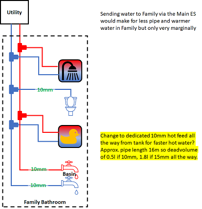

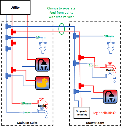

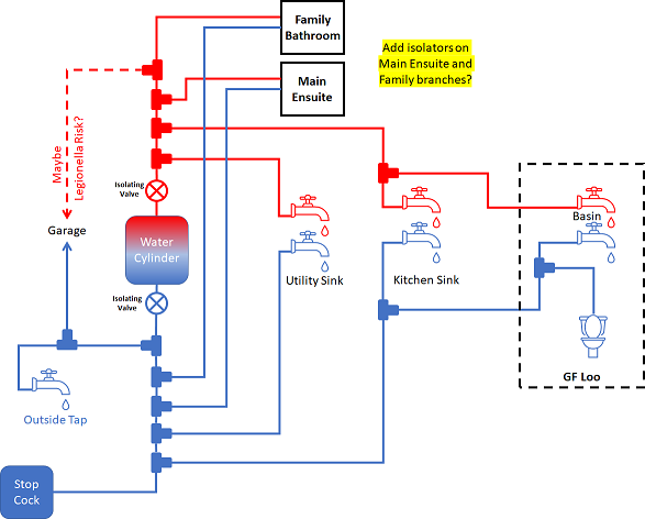

MortarThePoint Posted May 13, 2022 Posted May 13, 2022 I thought I'd start a thread of considerations to do with the plumbing. Below are some pictures that show the proposed layout. I'm presuming that I'll use 15mm for all pipes except those shown as 10mm and probably the stopcock to Water Cyclinder will be 22mm (inc manifold) --------------- -------------------
JohnMo Posted May 13, 2022 Posted May 13, 2022 Take outside tap off first and include isolation and check valve so you cannot contaminate the rest of the system. Have you considered a manifold for cold and hot water, this allows each stream to be isolated. We found this great when we moved in as main parts of the plumbing was complete but ensuites not complete. 1
Iceverge Posted May 13, 2022 Posted May 13, 2022 We had a mare with ours. I ended up redoing all the plumbing myself in Hep. It's an excellent system. We had a 13m run to the kitchen tap so in the end I ran a 10mm pipe to that too. About 5-6l/min flow rate. Not as much as the 8l/min for the cold tap but perfectly useable. It might be a consideration if your distance is large. A manifold radial system works a treat. 10mm for all hot basins straight from as near to the cylinder as possible. It works a treat and the difference is really noticeable compared to the ones I left the 16mm pipe from the plumber in place. Hot water in 5secs instead of 25. Pipe is cheaper than fixings so I don't think there'd be much of a price difference. You get the added benefit of having no fixings hidden anywhere in case of a leak. 1

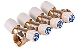

MortarThePoint Posted May 13, 2022 Author Posted May 13, 2022 1 hour ago, JohnMo said: Have you considered a manifold for cold and hot water, this allows each stream to be isolated. I'd like that. I haven't seen a Hep2O manifold that can do that yet, but maybe it's less widely carried that 5he simple non-isolating manifolds.
JohnMo Posted May 13, 2022 Posted May 13, 2022 These are what I used. https://www.outsourcedenergy.co.uk/product-category/manifolds/plumbing-manifolds/ 1

MortarThePoint Posted May 14, 2022 Author Posted May 14, 2022 Need to add appliances: washing machine, dishwasher and option for fridge
Thorfun Posted May 14, 2022 Posted May 14, 2022 I loved the idea of a manifold system even one where each room can be isolated from the plant room. but when our plumber came to price up the job and I mentioned it he said it'd cost a lot more and we'd need 24 pipes from the plant room instead of 3. we will have 4 bathrooms, 2 x WC, kitchen and utility room so with each having a cold, hot and HRC it just seemed excessive amount of pipework for a convenience that I don't know when/if we'd ever need (isolating a room that is).
HughF Posted May 14, 2022 Posted May 14, 2022 5 minutes ago, Thorfun said: I loved the idea of a manifold system even one where each room can be isolated from the plant room. but when our plumber came to price up the job and I mentioned it he said it'd cost a lot more and we'd need 24 pipes from the plant room instead of 3. we will have 4 bathrooms, 2 x WC, kitchen and utility room so with each having a cold, hot and HRC it just seemed excessive amount of pipework for a convenience that I don't know when/if we'd ever need (isolating a room that is). Yes, but you don’t need any fittings? And mlcp on a coil is cheap as chips these days….
JohnMo Posted May 14, 2022 Posted May 14, 2022 Our manifold isn't in the plant room, as it would have meant lots of long runs of pipes. So it's right in the middle of where it needs to be. Hot water Kitchen goes off to the left in the plant room and isn't on the manifold, manifold pipe goes right and it located in the utility cupboard. One supply to each room and branches of within the room. Cold water Manifold same place as hot, all room piping is under the floor insulation within the concrete (ducted). A supply branches off to plant room. I have secondary circulation to the furthest away room only, this heat the manifold up by default.
Thorfun Posted May 14, 2022 Posted May 14, 2022 27 minutes ago, JohnMo said: Our manifold isn't in the plant room, as it would have meant lots of long runs of pipes. So it's right in the middle of where it needs to be. Hot water Kitchen goes off to the left in the plant room and isn't on the manifold, manifold pipe goes right and it located in the utility cupboard. One supply to each room and branches of within the room. Cold water Manifold same place as hot, all room piping is under the floor insulation within the concrete (ducted). A supply branches off to plant room. I have secondary circulation to the furthest away room only, this heat the manifold up by default. our plant room is in the basement but is pretty much central to the house so it wouldn't be a huge increase in pipe length to put it there rather than in the cupboard that is on the ground floor directly above the plant room. I might ask our plumber to cost up the manifold and extra pipe and see how much extra it would be.

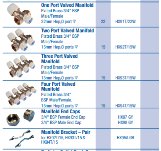

MortarThePoint Posted May 14, 2022 Author Posted May 14, 2022 12 hours ago, MortarThePoint said: I'd like that. I haven't seen a Hep2O manifold that can do that yet, but maybe it's less widely carried that the simple non-isolating manifolds. A bit of pocking around and I have found some (up to 4 way): https://www.jtmplumbing.co.uk/pipe-fittings-c433/hep2o-pipe-fittings-underfloor-heating-c999/hep2o-brass-manifolds-c661/hep2o-four-port-valved-manifold-15-tm-tf-fp-p21691/s27296

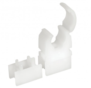

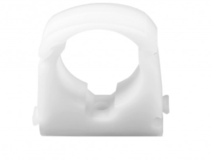

MortarThePoint Posted May 20, 2022 Author Posted May 20, 2022 I want to clip my 15mm and 10mm pipes to the underside of the concrete HCF flooring. I'll be using standard pipe insulation that has a 13mm wall. The standard clips, example below, look to leave less than 13mm between the pipe and whatever the clip is mounted on. Can anyone recommend on that is better for this as I don't want to have to kink my pipe for each clip or have the insulation pushing the pipe out of the clip.
MortarThePoint Posted May 20, 2022 Author Posted May 20, 2022 Talon do spacers, but it looks like a bit of a bodge: https://www.talon.co.uk/products/pipe-clips-and-accessories/pipe-clip-accessories/standard-spacer
MortarThePoint Posted May 31, 2022 Author Posted May 31, 2022 (edited) I like the idea of having completely separate loo feeds (10mm?) Which go all the way back to the manifold. Makes swapping to harvested water easy. Additional pipe and clips probably adds £50. Water is about £1/m3 and 20 flushes per day would work out as around 10p/day, so £37/yr. May make sense. Any harvesting method wouldn't have zero annual cost though. Edited May 31, 2022 by MortarThePoint
Thorfun Posted May 31, 2022 Posted May 31, 2022 1 hour ago, MortarThePoint said: I like the idea of having completely separate loo feeds (10mm?) Which go all the way back to the manifold. Makes swapping to harvested water easy. Additional pipe and clips probably adds £50. Water is about £1/m3 and 20 flushes per day would work out as around 10p/day, so £37/yr. May make sense. Any harvesting method wouldn't have zero annual cost though. we're having RWH with a header tank in the loft for our toilets so the toilets will have separate feeds from that tank. this means that when I'm having a shower and someone flushes the loo it doesn't affect the water or temperature! 1
