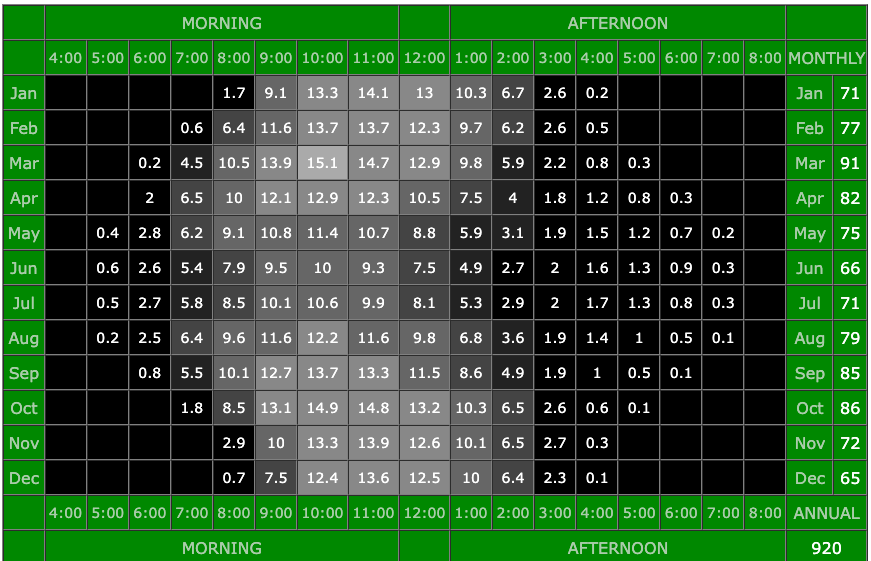

Garald Posted May 12, 2022 Author Posted May 12, 2022 Sorry, winter *morning*. 15 W m^{-2} is slightly optimistic but not wrong, at least not on a sunny day. See http://susdesign.com/windowheatgain/index.php Bit counterintuitive, in that the peaks for March and October are higher than those at other times - why is that? Bit funny that 15 W/m^2 should give very little rise in temperature, given that that's not what it happens in the summer, and, if the app is right, one doesn't get more than 10 W m^{-2} then. Latitude 49 N, orientation SES.

SteamyTea Posted May 13, 2022 Posted May 13, 2022 On 12/05/2022 at 22:19, Garald said: See http://susdesign.com/windowheatgain/index.php Bit counterintuitive, in that the peaks for March and October are higher than those at other times - why is that? Expand Only had a quick look, but the units are showing kWh.m-2. Is that for the whole month? So taking January, at noon, 13 kWh.m-2 Divide by 31 (days in month) and that comes out as a mean of 0.42 kWh.m-2. This seems a bit high, but may be correct for a clear sky when the direct beam is measured.
