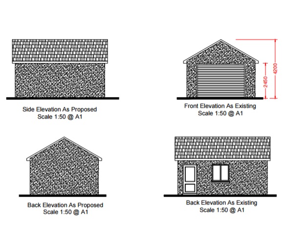

Carrerahill Posted May 18, 2017 Share Posted May 18, 2017 (edited) Hi All, Simple question; but a bit drawn out, regarding my planning permission and the setting out and heights of said proposal onto my site. As an engineer I work with CAD on a daily basis, everything is mm perfect, everything very precise - now come to my site and the location for my new garage - this seems to be a little bit, rough shall we say. I know from my drawings that the garage sits 800mm in and parallel from one boundary and 400mm going up to 1200mm on the rear elevation (site is not square and it made sense to align the garage with the side elevation boundary). So I go out and start to work out the physical location and bang in pegs and what not so I can see where I need to dig out and dig services trenches. Now the boundaries of my site are set out in traditional estate wrought iron fence which have been there forever, so I am going to use these, as my physical marker of boundaries. Now the question is this, if I measure 800mm out from the side fence, check it is square to said fence then measure 400mm in from the back fence and bang a peg in I now have the completed outside corner of the garage location, I can then measure 5000mm across and at that point 1200mm out from the back fence, by ensuring the 5000mm line is square to the side fence I now have the opposite corner of the back wall - the rest is the case of staying square to the side fence and marking out the site. That all sounds fairly easy and with some careful measuring and squaring off it will be fine - however, old fences are not perfectly straight and things do undulate a little, with care and attention I can allow for this and I will be fine. But really what I want to know is how much out could something be and planning would not care, and secondly, planning don't actually come and look do they? How would they ever know if I, through genuine error, ended up 40 or 50mm off course? The next part of this question is regarding ground level, from the front of the garage to the rear of my garage the ground slopes down to the rear about 450mm. My plans show the soffit at 2.4m, if the site was flat then all elevations could easily enough be built to have a ground to soffit height at 2.4m however I cannot do this, I am going to have to have the back end of the garage about 2.8m from ground level to soffit, I may be able to re-grade the access to the front of the garage a bit to lower it, maybe go down 100mm and put the slab in level at the front bringing it down a bit at the back but what is deemed as "ground level". I don't want to build this thing as I said above, only to find that planning say I am too high at the back. Thanks Edited May 18, 2017 by Carrerahill Link to comment Share on other sites More sharing options...
jack Posted May 18, 2017 Share Posted May 18, 2017 What measurements, if any, are actually shown on your planning drawings? Link to comment Share on other sites More sharing options...
Carrerahill Posted May 18, 2017 Author Share Posted May 18, 2017 3 minutes ago, jack said: What measurements, if any, are actually shown on your planning drawings? The location plan simply shows the garage sitting on the site on the scaled block plan. On the proposed elevations plan it just shows the 4 elevations with a dimension showing the length, width, ground to soffit (or is that slab to soffit?) and ground/slab to apex - picture of the actual planning application elevations drawing attached. Link to comment Share on other sites More sharing options...

ProDave Posted May 18, 2017 Share Posted May 18, 2017 If the boundary is not a perfect straight line, then set the garage so it's 800mm from the boundary at it's closest point. Then if it ever comes to "tape measures at dawn" then no part of your garage will be closer to the boundary than agreed and there will be no cause for complaint. you can only set the levels at the front as the plans and the rest take care of themselves. Strictly speaking if the site slopes, then this should have been shown on the elevation drawings. Use any excavated soil to level as much as possible te ground immediately around the garage to make it as level as possible. P.S why did you need planning for a single garage? If it had been 1 metre from the boundary it might well have been permitted development? Link to comment Share on other sites More sharing options...
Carrerahill Posted May 18, 2017 Author Share Posted May 18, 2017 (edited) 42 minutes ago, ProDave said: If the boundary is not a perfect straight line, then set the garage so it's 800mm from the boundary at it's closest point. Then if it ever comes to "tape measures at dawn" then no part of your garage will be closer to the boundary than agreed and there will be no cause for complaint. you can only set the levels at the front as the plans and the rest take care of themselves. Strictly speaking if the site slopes, then this should have been shown on the elevation drawings. Use any excavated soil to level as much as possible te ground immediately around the garage to make it as level as possible. P.S why did you need planning for a single garage? If it had been 1 metre from the boundary it might well have been permitted development? I spoke to planning last year and explained where I wanted to build the garage and asked did I need permission, he came back and said yes because the path constitutes a road - I was going to argue this it's not a road, it's a 1500mm wide path and I own half of it but I didn't want to get my relationship with them off to a bad start. Also the garage sits beyond the front elevation of my house albeit about 10m away to the left where you can't actually see it from the road, it was only a small corner of it that came forward of the house but I would have ended up wasting a 1900mm strip down the side of my garage so I was not keen to lose that. I had to put in planning for the extension anyway so I drew up the plans, gave them to the architect who re-jigged them a little and submitted them as part of the application thus costing me no more anyway. Another argument I made was that if you look at the house and draw a line along the front of it to where it ends fronting a road, then drew a line perpendicular to first line down to the road, that according to PD is a permitted build area as it doesn't front a road. But he said no because the path was a road, so the line had to extend right along the front of the house. Anyway, application is in now anyway, so fingers crossed. I think what is being said above is the case, be careful, lay it all out and just build it without being stupid on any of the dims to prove I have done my best to adhere to the plans. Edited May 18, 2017 by Carrerahill Link to comment Share on other sites More sharing options...
